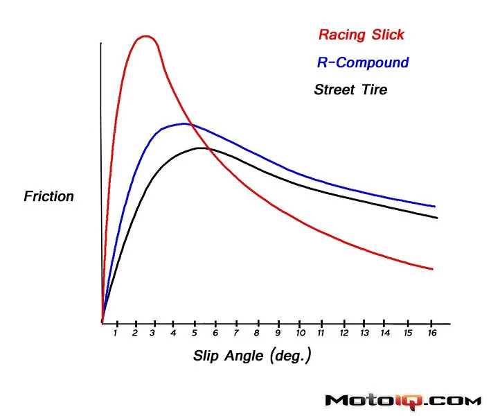

They're not necessary, no. Your lap times would lose out, mainly as a result of lateral grip. Street tires are pretty good for those first few times to the track, as they have very audible feedback, as a squealing tire is their way of telling you that you're right around their limit. As you up your game with R-compound, their chattering is still there, but largely goes away, and slicks pretty much gone, as you should pretty much know how to drive to your car's limit by that point. If you go in with super top notch race brakes, it is also easily possible to outbreak your tires, so having brakes and tires that are respectively close in performance is also a good thing.

This graph is very misleading for people they are not tire/race experts, Slip angle and lateral grip are 2 different things and you can have a lot of grip and a high slip angle
Slip angle is the deformation of tire carcass and thread and my experience with both slicks and R compound, such as nt01 for example, is that NEITHER “sing” at the limit

Perhaps I should have better explained that it was a general example to somewhat illustrate the point, but it still somewhat served my point that street tires are more forgiving. I doubt somebody on their first track day would be showing up on NT01, much less driving them there.
