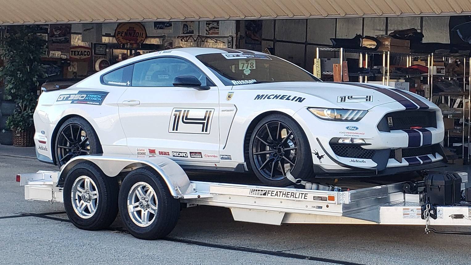

I have a winch on my open trailer and the front end of the car overhangs the front of the trailer bed area, so connecting to the tow hook (mine is the FP version that protrudes from the lower part of the grill) doesn't work due to the angles involved.
Instead, I follow the owner's manual instructions for flatbed towing. Using a V-strap with J-hooks on the end, I connect the J-hooks to the front subframe from underneath (look for the keyhole-shaped cutouts that are aligned with the front edge of the doors). I then leave this strap connected to the winch with a bit of tension on it after the wheel tie-downs are in place.

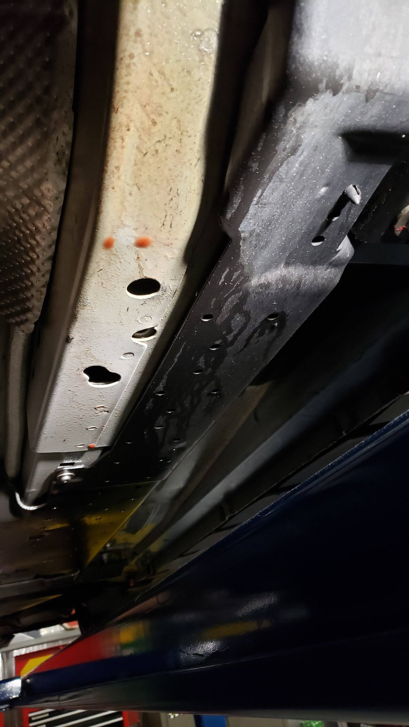

Here's the slot the J-hooks go into.... just ignore the transmission lube in this pic - was taken when I was trying to figure out a past issue that was related to an improperly positioned vent.

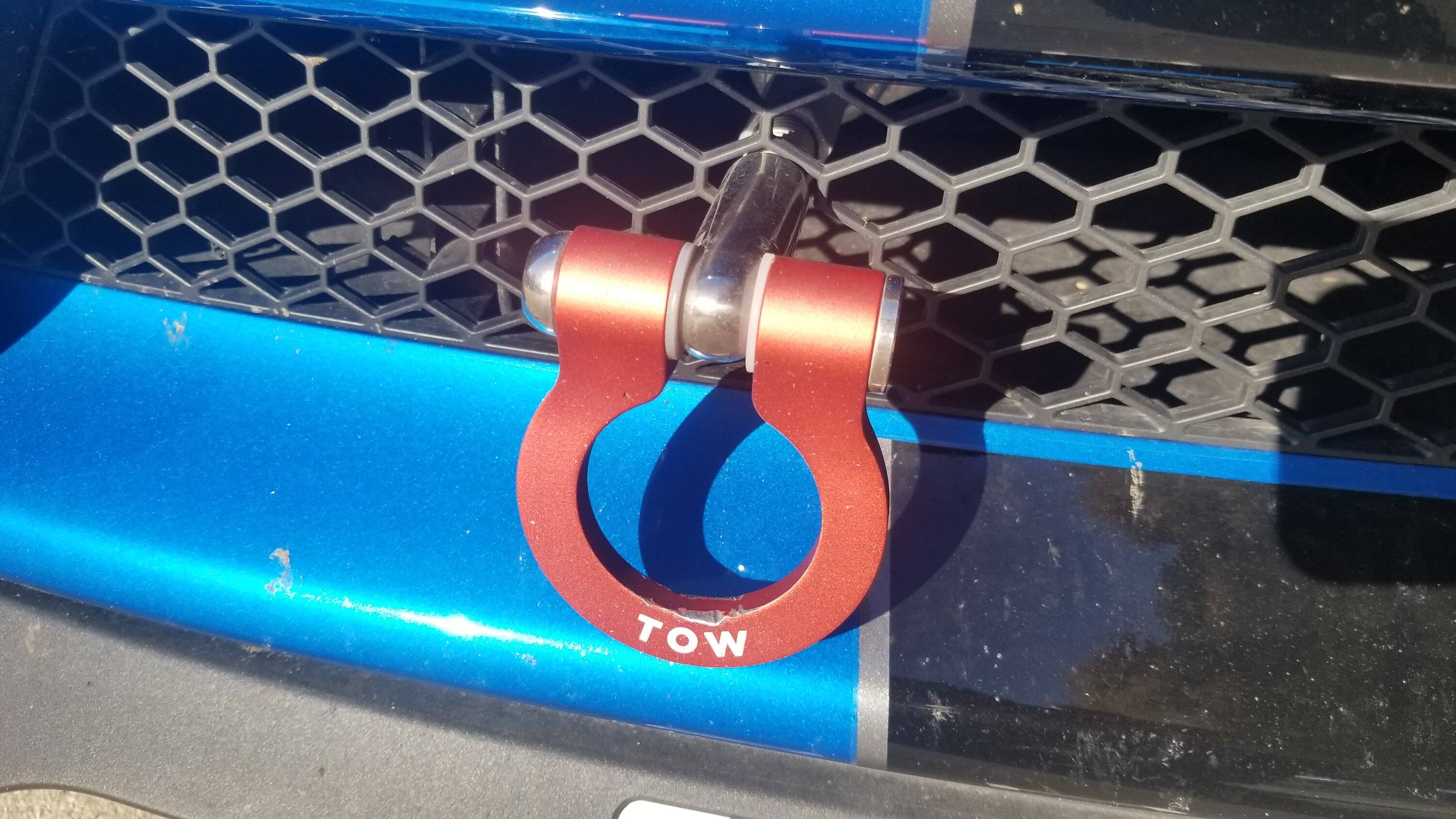

My rear hook has never been used (other than as a microphone holder ;) but I routinely trailer-load my 2019 GT350 using the front hook - admittedly a low-stress maneuver. It has never had to be used with high tension such as might occur during an extrication from a track excursion. Here's what it looks like after ~30 trailer loadings:
IIRC, the owner redesigned the bracket a while back because a few people reported them bending. I know mine flexed enough to crack a bunch of my honeycomb.
The bigger thing for me is I'd never want to pull from off-center into the trailer. Just puts unneeded stress on everything and drives my OCD crazy. I resisted the FP tow hook in the beginning because it felt like such an after-thought design, but it works great and has drug my stupid car into the trailer 100 plus times drama free.
