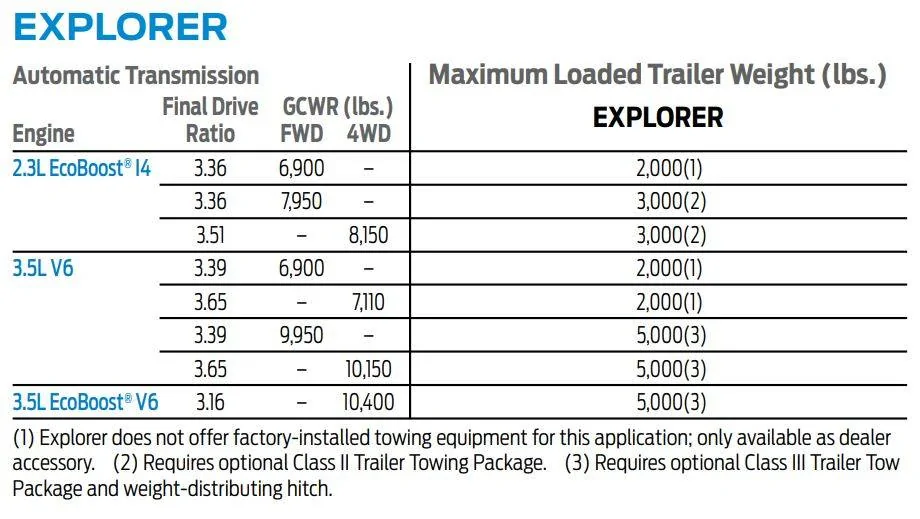

Easy first-pass sanity check is to check out the white VIN and yellow payload stickers in the driver's door jamb. Tongue weight comes straight off your payload.
Keep in mind the advertised 5000lb for the Explorer (or any vehicle for that matter) is "properly equipped vehicles with no cargo".
Google "Ford 2017 Towing Guide" or hit https://www.fleet.ford.com/towing-guides/
Depending on your engine, final drive, and whether you have FWD or AWD... Your actual truck could have as low as 2000lb capacity.
They also use SAE testing standards which allow for only 10% tongue weight. This is the minimum safe recommendation. I personally like to run a bit more.
So to hit 5k towing you'd have to have the trailer perfectly balanced, and nothing in the cab but the driver and a full tank of fuel. A 3800lb car means the trailer can't be heavier than 1200lb. Trailex has a couple open models that are sub-1000lb, for what it's worth.
Unless you're comfortable stretching the limits, I don't think I'd do it. At least for any appreciable distance.
In general I've found you'll run out of payload before you can realistically hit the max towing capacity rating.
