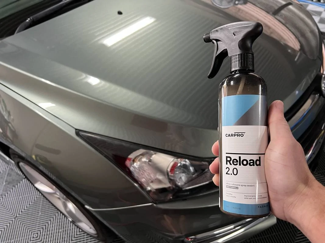

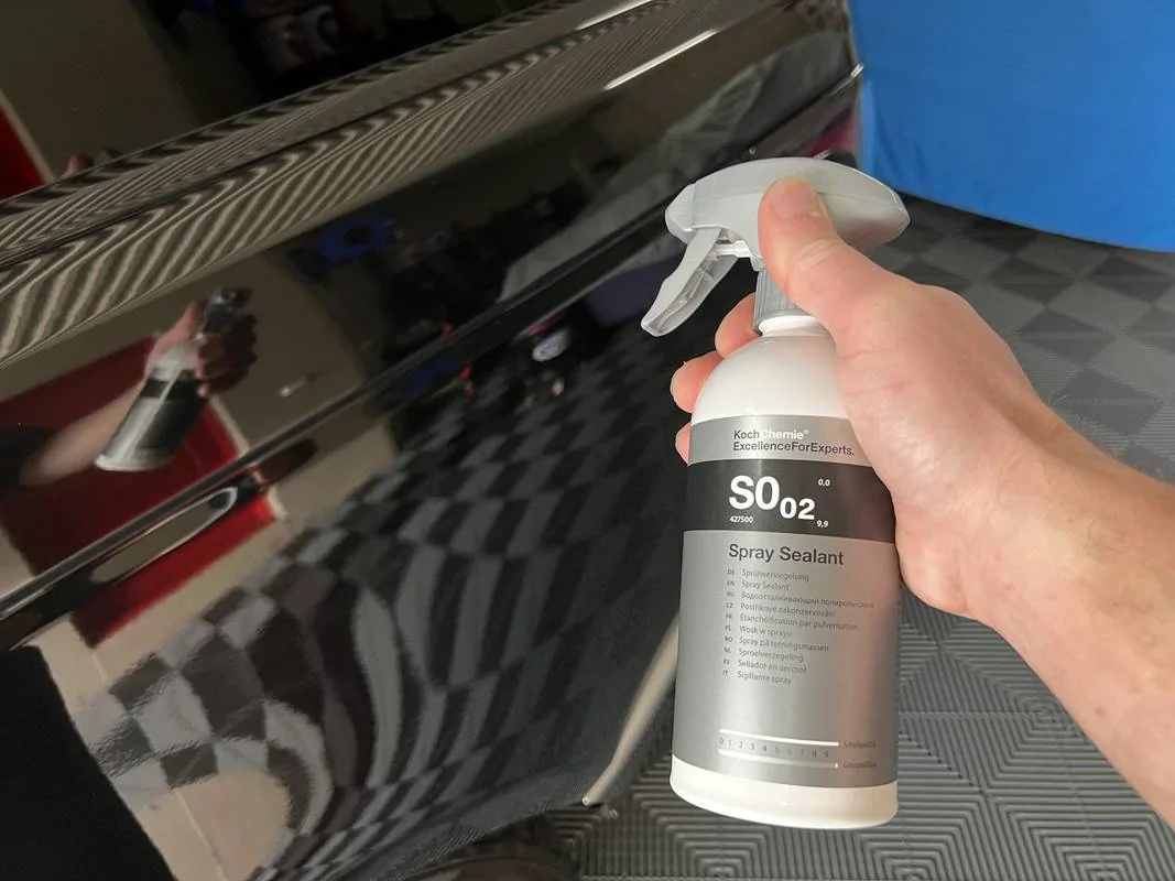

Considering that I know you prefer to air rather than towel dry (or combination of both like I do), I'm assuming "post wash topper" is not in reference to a drying aid, rather a more deliberate application? If so, I favor either Carpro Reload 2.0 or Koch Chemie S0.02. Both provide a boost in protection and gloss, with S0.02 being slightly easier to apply. You would apply either as a topper every 3 months or so.
Koch-Chemie - Spray Sealant | The Rag Company
CARPRO Reload 2.0 500ml (17oz) (carpro-us.com)

In terms of the Carpro spray sealant/detailer range, this is the hierarchy -
Reload 2.0 - 3 months protection

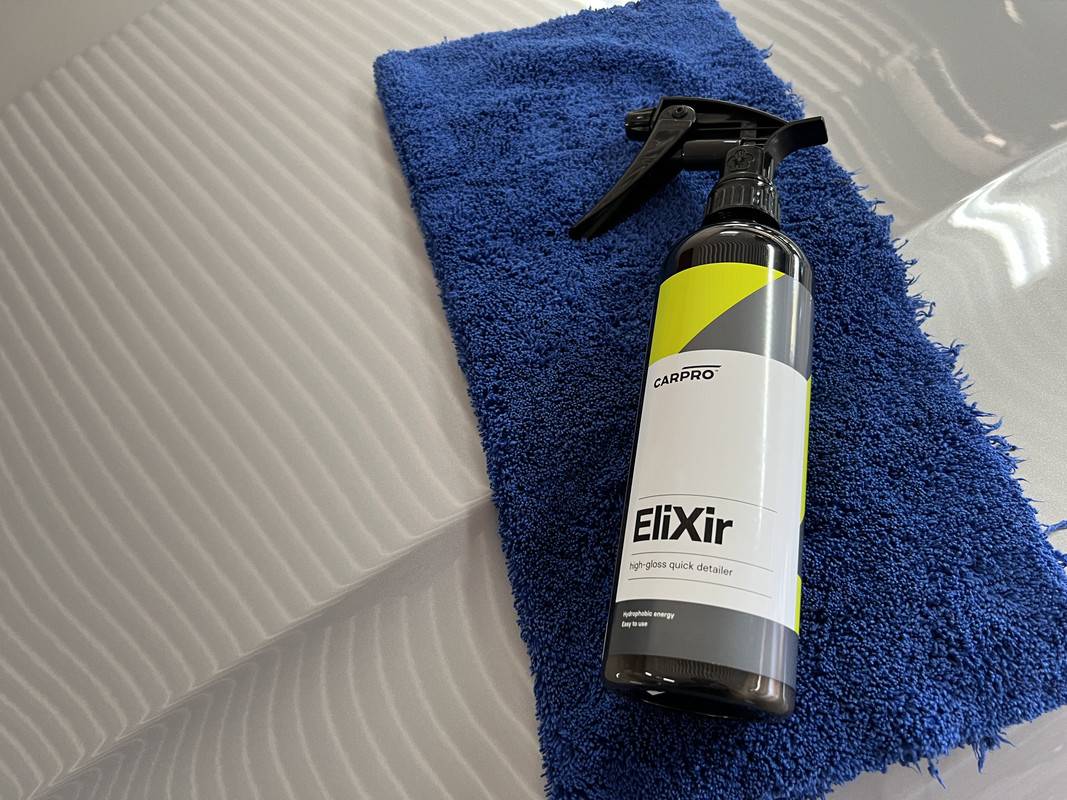

Elixir - 4 - 6 weeks
ECH20 - 1 week
Release - Until the next wash.
Elixir is actually a blend of ECH20 and Reload, so you will have no issues using it on a ceramic coating. ECH20 itself was designed as a slick quick detailer/water-less wash for Carpro coatings and contains wax to deliver lubrication and slickness. Release is basically a spray wax to protect a freshly installed coating within the first 7 to 14 days, it can be used as a quick detailer, but ECH20 is superior in that regard.

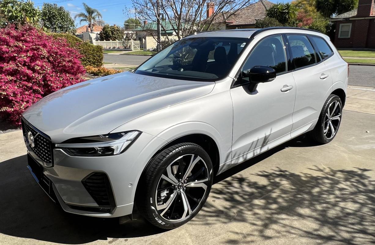

As a bit of a case study, my sisters Volvo XC60 had Carpro Cquartz Finest Reserve applied this time last year. I've been maintaining the coating by washing with Reset, then using Elixir as a drying aid after the wash. Every 4 months, I swap the Elixir for Reload. Both products work superbly with the coating, which you would expect.

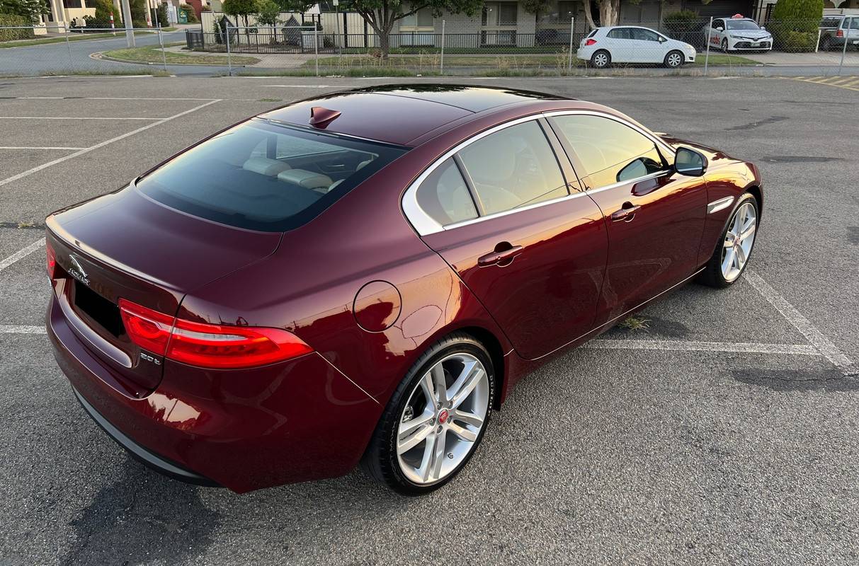

For ceramic coatings, I lean toward Gyeon for the ease of application. I have Pure EVO on two cars at the moment, the claim of "candy-like gloss" grabbing my attention to make the Jaguar Odyssey Red paint pop. On your Rapid Red GT500, Pure EVO would suit the color well. But......................... I would probably do Mohs EVO instead as it has superior slickness, something missing from Pure EVO.
GYEON | Q2 MOHS EVO Ceramic Coating – Car Supplies Warehouse
Pure EVO -

And I do agree that S0.02 does apply much easier than Reload and is definitely my favorite, I used on my Mustang just a few weeks ago after doing a decon wash to unclog the coating and it brought the extreme slickness back to the paint. My Mustang has DPC 9 on it so a little different coating, but it still works fantastic. I must say NV Boost V2 is my second favorite, and will be my go to once I coat my daily driver with Nova.
Well now, I certainly didn't know THAT, interesting.
A plan, excellent, I've never had one. <smiling> Instead, all I have done is alternate between Elixir and Reload with no set time period, I just grab one or the other to "top her off." :-)
But the logic behind your method of Reload in between multiple topper applications of Elixir is PERFECT and THANK YOU!
