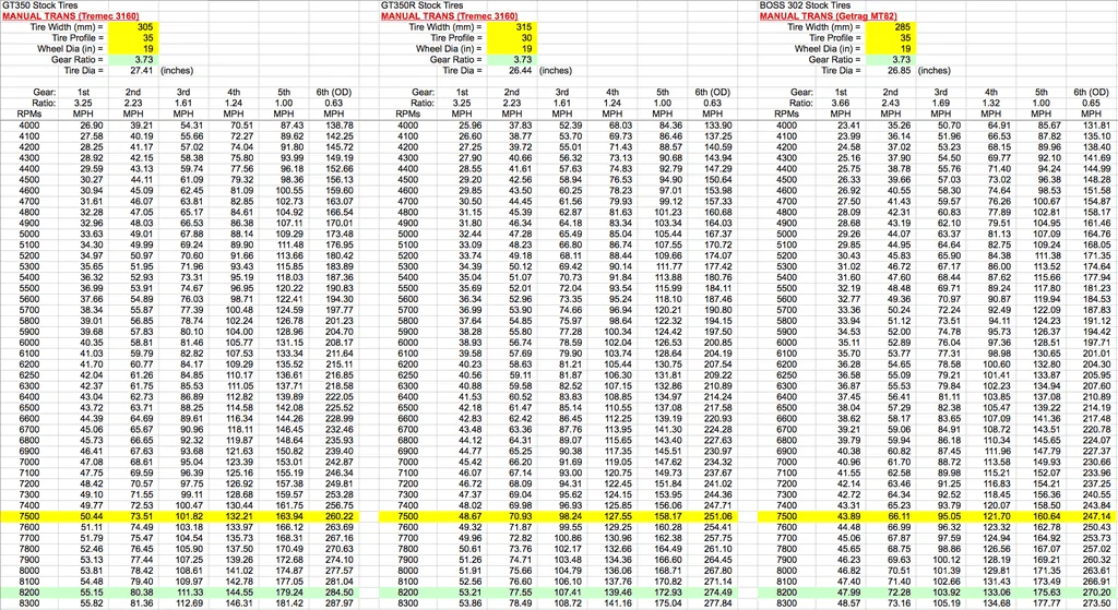

The fact that it takes 8 times the horsepower to go 2 times faster under the same conditions. The stock GT350 has a hard time hitting maximum speed in 5th gear. Speed limitations in this car are the weight and drag. Gearing indicates 178 mph @ 8250 RPM, but it doesn't have the power to get there.

144.55. Approximately. ;-)

Here's a spreadsheet you can make a copy of if you want to plug different numbers in and find out the answer.
Mostly depends on what tire you're running, assuming you haven't messed with the rear gears.

Looks like the 173 max for the R is more a function of the tires size/gearing as calculated in post #19 and then again in post #38.
