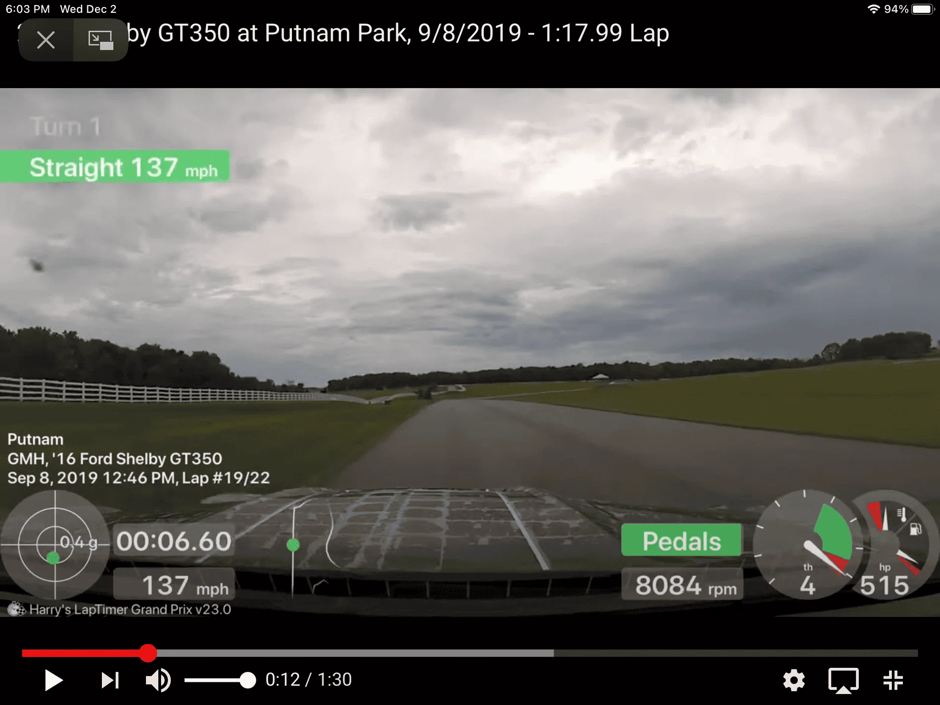

I'm on 30-series Hoosier R7s, and I'm at 137 MPH in 4th gear at ~8,100 RPM at the end of the front straight on my local track. On the original, 35-series MPSS, the top speed in 4th gear is a little higher, but the effective gearing is higher (numerically lower), so not as preferable for track work in my opinion.

I have hit low 130's in 4th at Heartland Park Topeka. There is more there, but not quite ready to push that hard.

I hit 137 on the straight at Gingerman in 4th which was about 7,800 (I was watching my braking point not the tach so that is very about - going off the shift lights).
