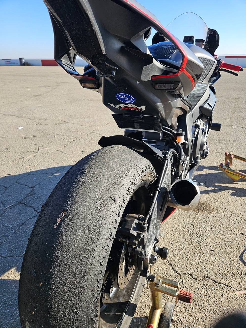

You are correct.. they were overheating a bit (from the wear the track day) basing it off of experience with track tires on my bike too .
I just don't have thread pattern so I never see any feathering happening.

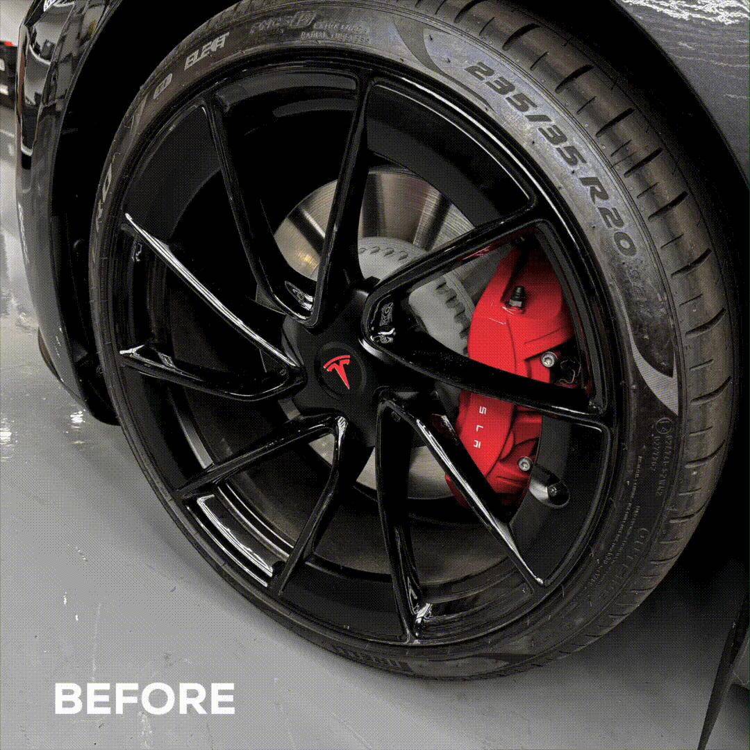

XL weight rating for my Model 3 Performance. Other unusual things about the tires other than 42 PSI is how wide the wheels are compared to the tires also for aero. Which leads to a lot of curb damage. Even the slightest brush that would only graze a tire of another car will damage the wheels.
Factory wheel and tire:
