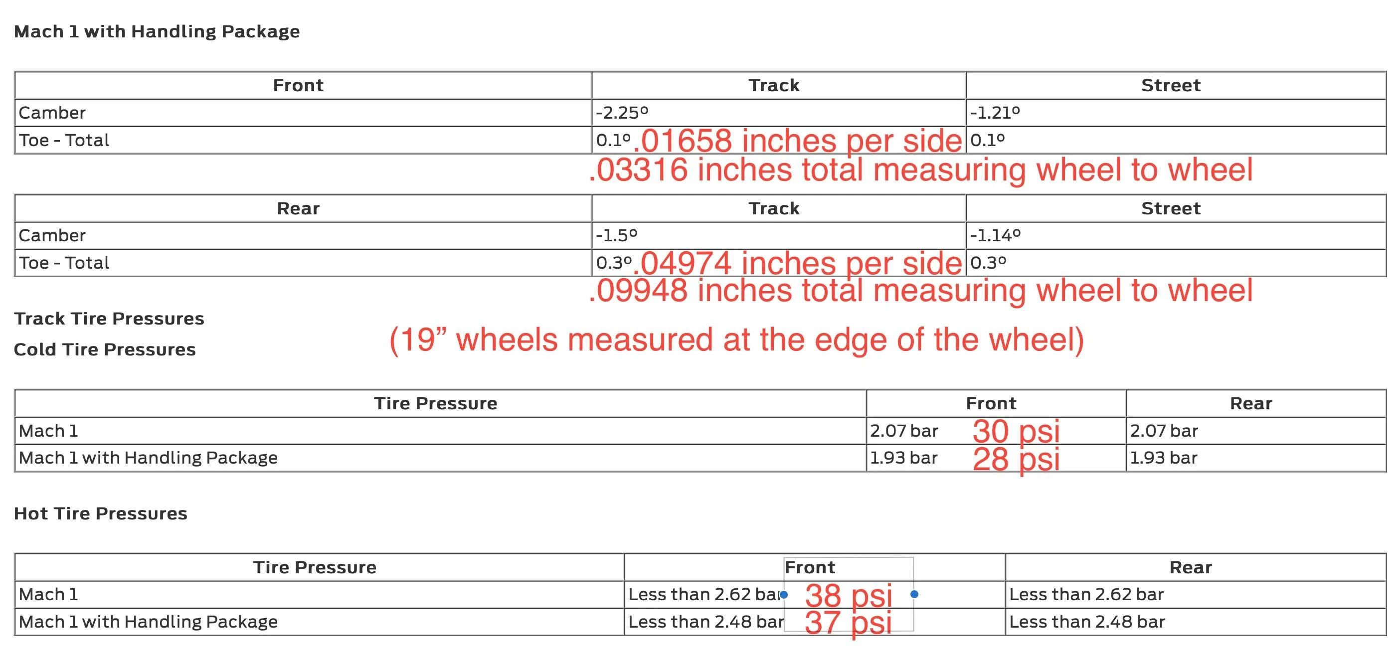

Is that the Blue HP from YouTube? Did Ford ever get you the fender lips and splash guards? Here is what Ford recommends for an HP car. I have PS4s for the Street and Cup2s for the Track. I would expect to get about 3 days of Track use out of those Cup 2s then I'll switch to something more autocross oriented. Guys here sell em immediately that's how I got my first set.

To improve the wear on the fronts, avoid the combination of negative camber and toe. You can have a bit of both, but if you like camber (I do), I’d advise for 0 toe. And of course you can pick tires with longer mileage. I’m a big fan of Michelin P4S for the street.
