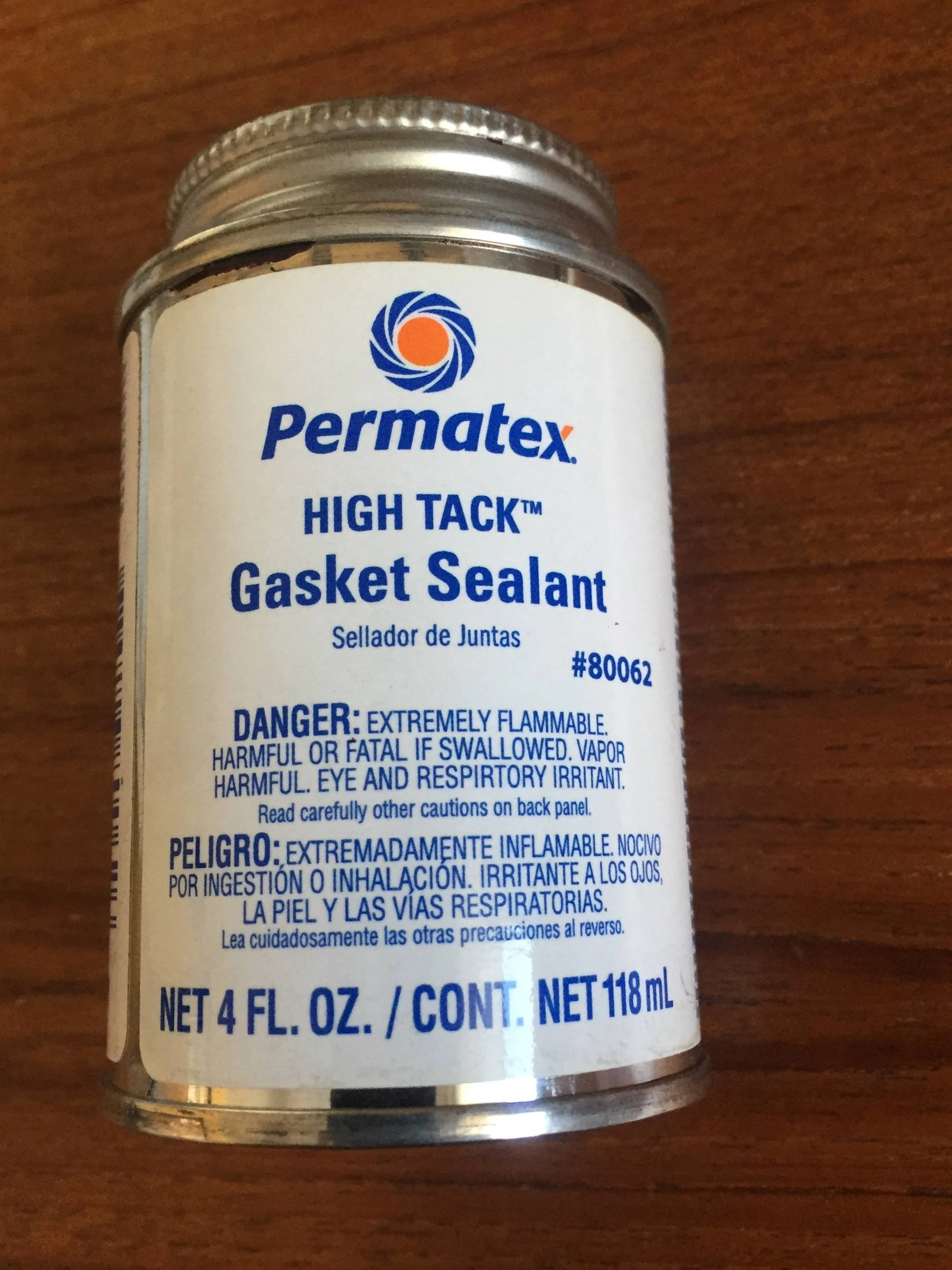

I had the beads broken, tires and rims cleaned with acetone, coated bead areas with Permatex hi tack. Will report back!
