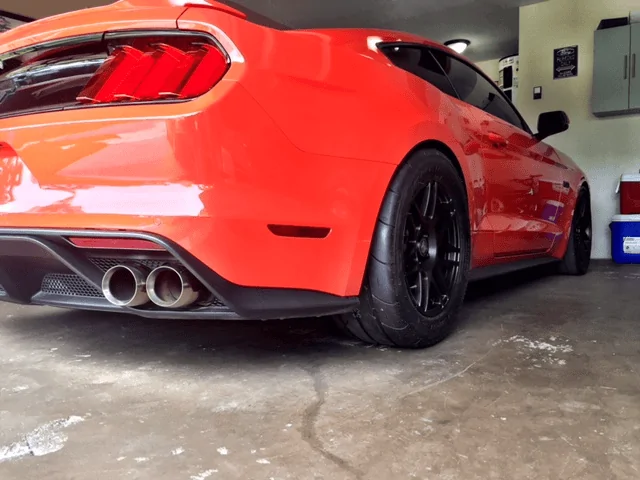

How much do the eibachs lower it? I'm on the 17X10.5 race star with 305/45/17 on BMR drag springs, supposed only .5" rear drop, and have zero problems with rubbing.

Theyll fit. Im trying to figure out what a 325 would look like. On a 10.5 wheel. Im trying to get a little more on the launch. And a 305 is 29 inches tall. Vs 27 for the 325. The smaller diameter tire should improve the sixty.
