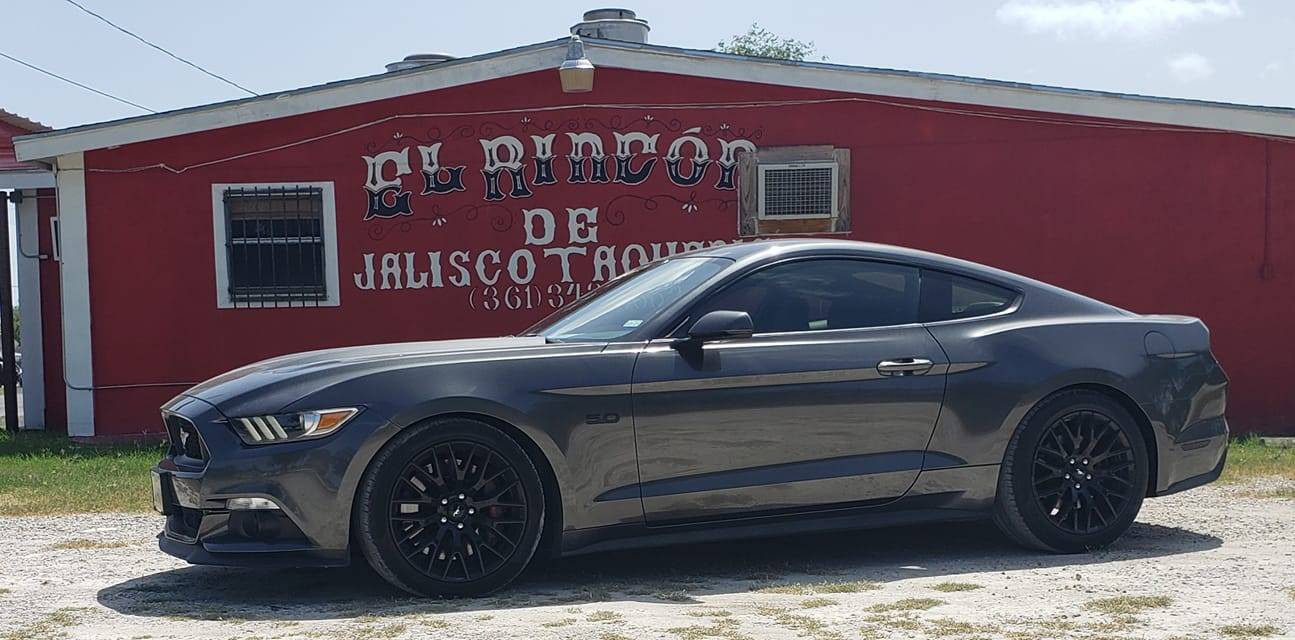

Shopping for tires to replace the set on a set of wheels I got from a friend. 19x10/19x11 SVE R350 wheels, on Nitto Invos, 285/35/19 front and 325/30/19 rears. Rears are almost bald, and the fronts aren't too bad but I do want a uniform set. Most daily driving, some backroads driving, roadtrip and some mexico runs from time to time til I can get a drag set. LOWERED ONLY .75 OF AN INCH ON ALL FOUR CORNERS WITH STEEDA DUAL RATES. Kinda the reason I wanna run 35 profiles to keep some meat and keep the wheel gap minimal.
285/35/19 fronts and 305/35/19 rears
There is a limited variety for 19in wheels, especially in 305/35/19s.
Thought about Nitto NT555 G2s, heard mixed reviews
Leaning towards Michelin's Super Sport tires cause I can get these sizes, just its either back ordered or I gotta order from a Michelin dealer and have them special ordered.
the Pilot Sport 4 S tires don't come in a 305/35/19 rear sadly.
Thoughts, opinions and suggestions would be helpful and appreciated!
