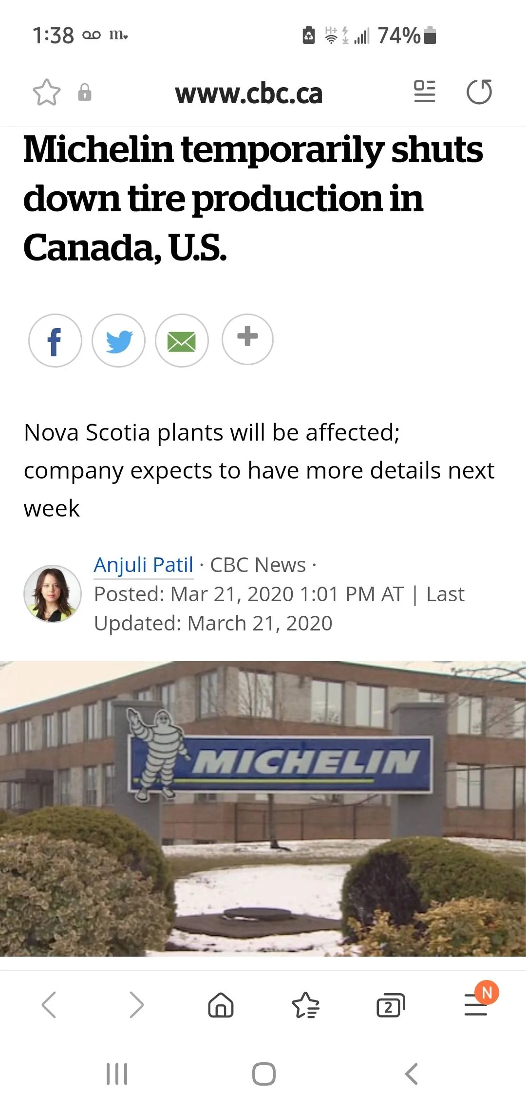

Tire producers are not going to store molds for sizes that don't sell in volume.
That's not totally true. They will store them and do short runs if they get orders. Problem is if they are covered up in large orders, they get priority, you may have to wait 6 or more months to find any and they will be expensive.

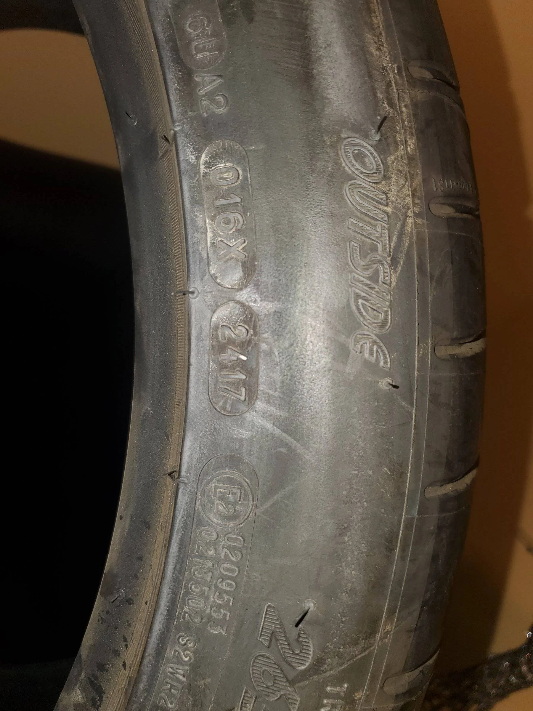

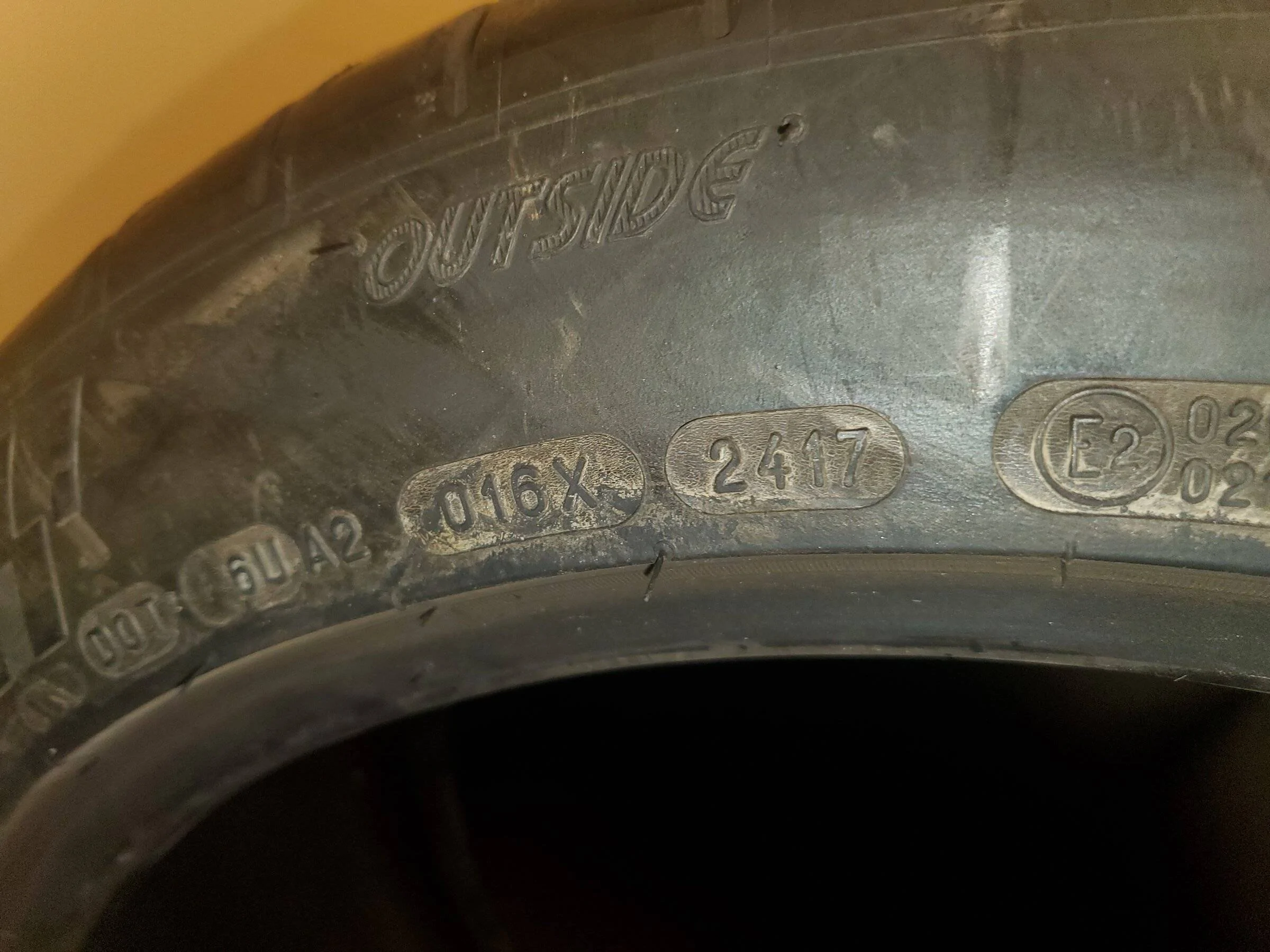

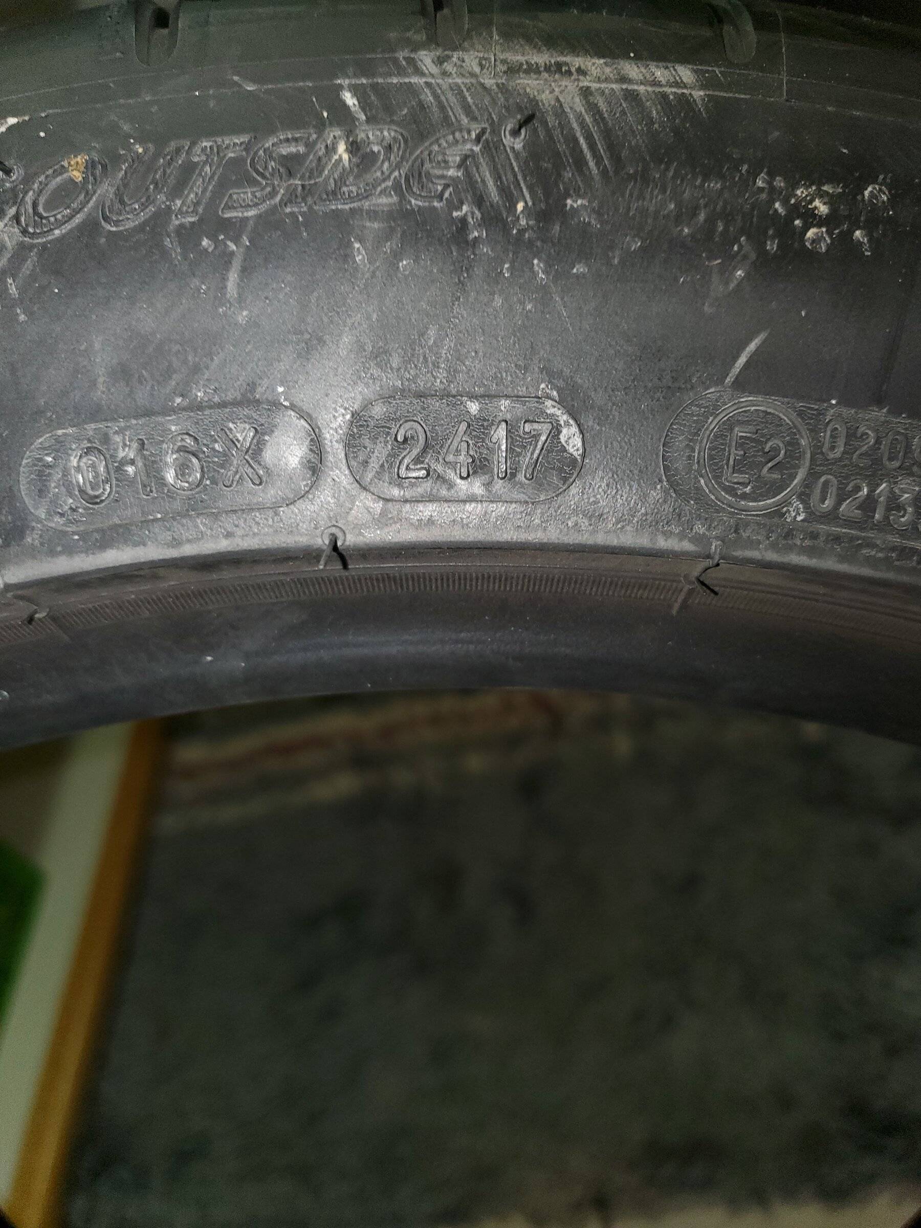

Well got two tires 265/40/19 sent from Black Circles Tires.
DOT Date Stamp 4217,2417.
I just bought some 305s from these guys dated 4021.
Now I have to send these back.
Lol
They're not screwing around and have put out the word to their warehouses about DOT Stamps.
So that's a good thing.
And are already sending me replacements without even receiving the dated old tires. So I guess we'll see what comes this time.

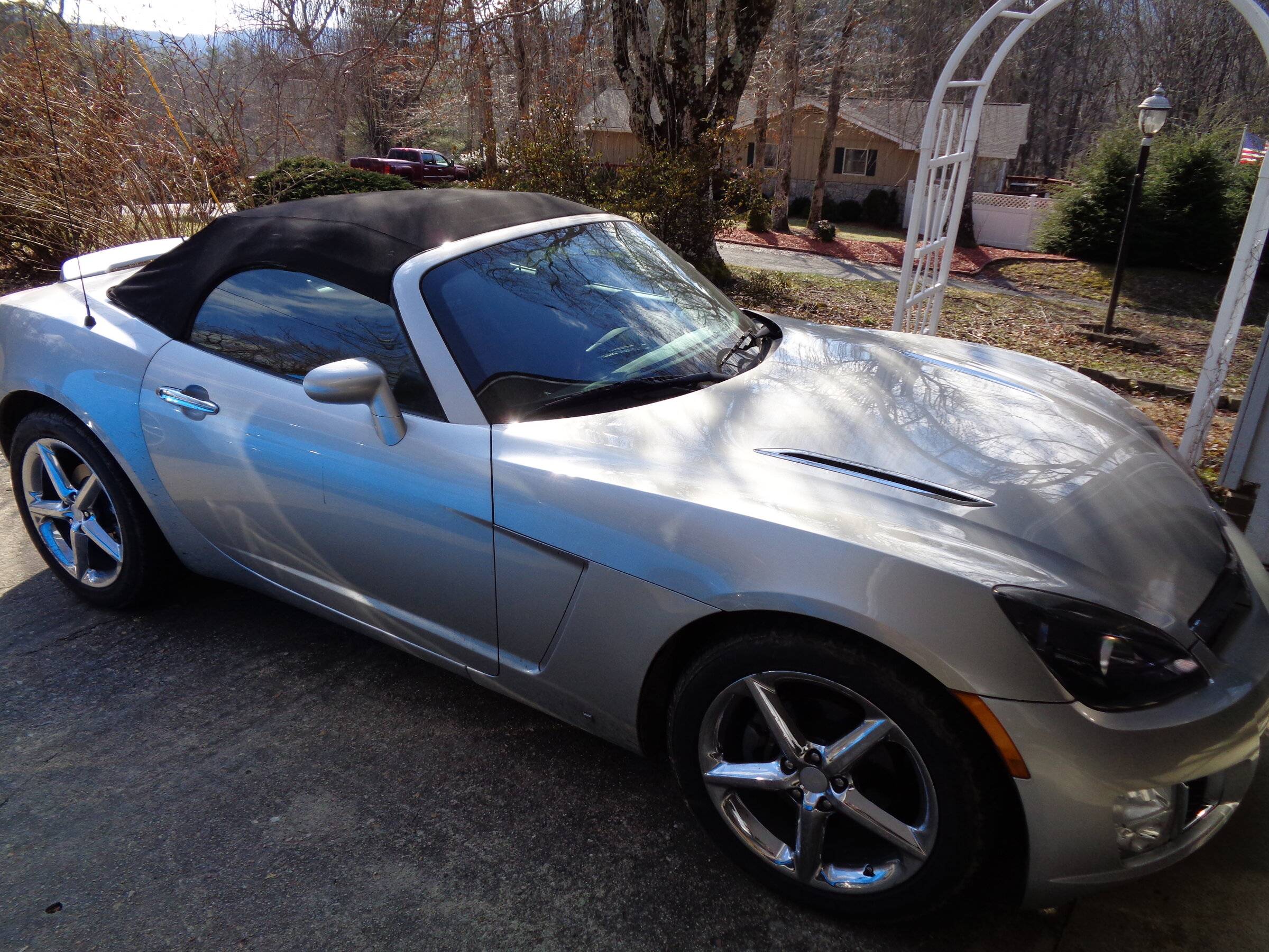

....I bought a 2008 Saturn Sky in 2018.
It had 39,000 miles on it.
Apparently the stock tires were on it as well.
I drove the car to my tire store to order tires for my wife's Escape.
The owner/friend of the tire shop says;
"I wouldn't drive that car with those tires if I were you. Look
how old and rotten the tire sidewalls are."
Wifey and I had driven the car to the NC coast and around home; about 1600 miles or so.
The people @ the Toyota dealer said they checked out the car and everything was ok.
Yeah, right............................... :crazy:

So I recieved another pair of 2417 MPSS tires. Must be from the same batch. On these after reading above about defects the sidewall towards the tread is very easy to push in with my thumb. I did the test with my 305/35 dated 1721 and the sidewall was much stiffer, I could hardly push in the sidewall in the same place. Is this from it being a wider tire than the 265/40 tire?
I'm kind of at a standstill here with 4 outdated tires.
The vendor has been alright so far but they keep saying it's out of there hands. Their policy is 36 months so...
Should stand my ground until I get tires I'm comfortable with or ask for a discount? I have time as I won't be mounting them for a couple months at least.
