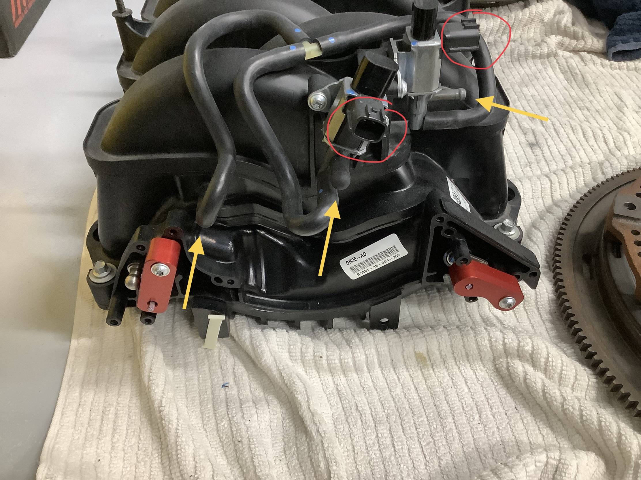

If you’re going to run lockouts you’ll need to have them turned off in the tune, so you’re back to needing the tune. My vote is the CAI kit, mid pipe, tb and axle back for now. Buy the intake if it’s in your budget and the IMRC lockout kit and sit on them until you’re absolutely ready for the tune and then do that. Another option to LTHs is this:

what’s the purpose of lockouts ? Do I really need them?
You don’t necessarily need them, but the IMRC rods have been known to break over time. That was one of the reasons why I did them on mine, the other was to declutter the back of the IM and allow easier access to the top two tranny bolts for clutch and tranny work. If they ever break on you, you’re gonna pull the IM to add them. They’re cheap enough at around $70, that it just makes sense to do them before you install the new IM.
The supercharger folks can confirm this, but I believe most tuners prefer them to be locked out with a supercharger.
You don’t necessarily need them, but the IMRC rods have been known to break over time. That was one of the reasons why I did them on mine, the other was to allow easier access to the top two tranny bolts for clutch and tranny work. If they ever break on you, you’re gonna pull the IM to add them. They’re cheap enough at around $70, that it just makes sense to do them before you install the new IM.
