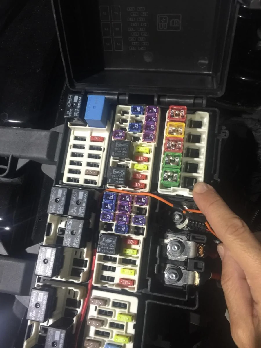

I saw a post recently and can't find it. Planning on going on the dyno this weekend. What's the process? I have heard that traction control devices try kicking on even though they are turned off. I think I also heard if you pull the ABS fuse (i think 66) that takes care of it. Just wanting to see what others experienced on the 2015's?

Just pull the fuse and you'll be good to go.
