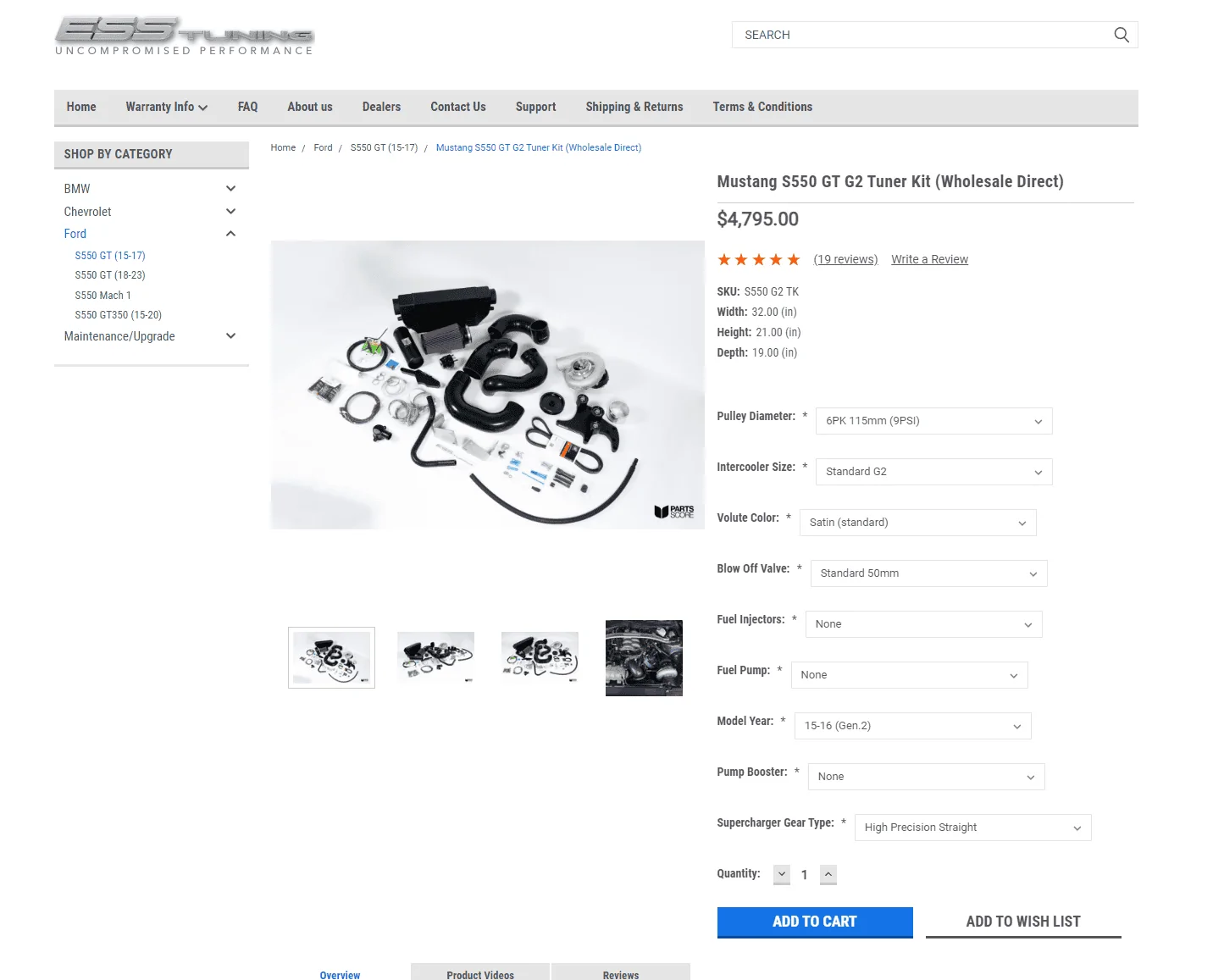

My tip, dont.
Just get the cheapest ESS kit and keep everything else stock. That will be the most cost effective way.

My tip, dont.
Right? Literally make 580-600whp with a big pulley for maybe $1000 more while being super safe and lasting forever. Easier than buying all the bolt on parts needed just to make and honest 475-500whp.
