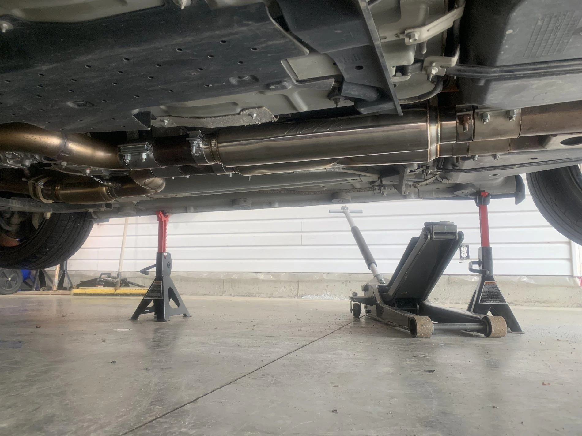

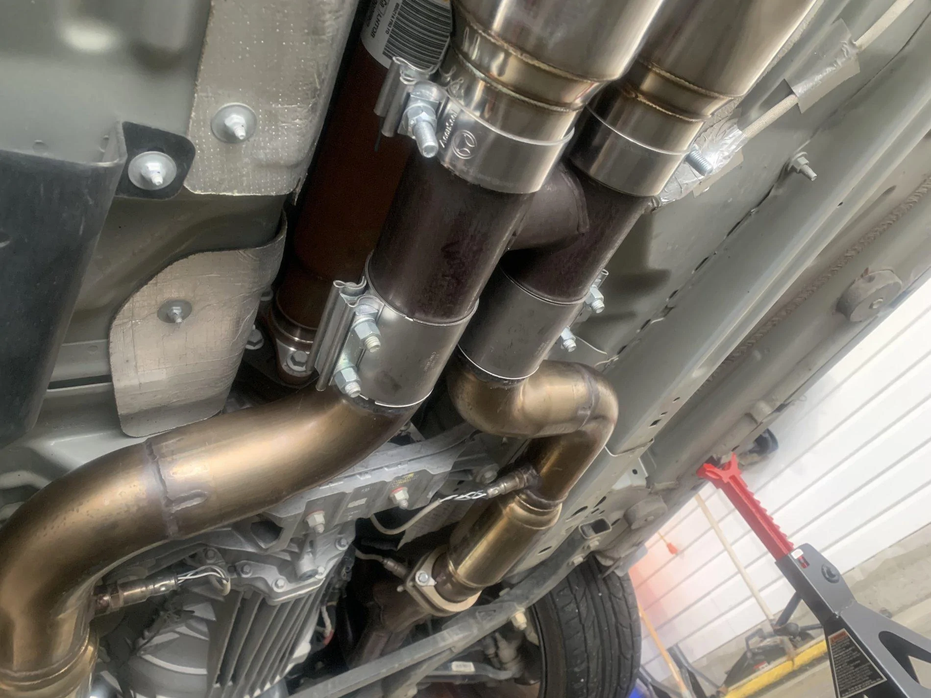

Vibrant 1794s (3" in and out, 12" long) did the trick for my ARH LTH to Corsa Xtreme setup. Calmed down overall volume some, tamed some of the rasp. More refined if you will.

Stang78
Nov 19, 2018
Tennessee
Derrick
2018 Mustang GT
Did you install the resonators right after the X Pipe? Any pics of your setup by chance? Thanks for the info.
