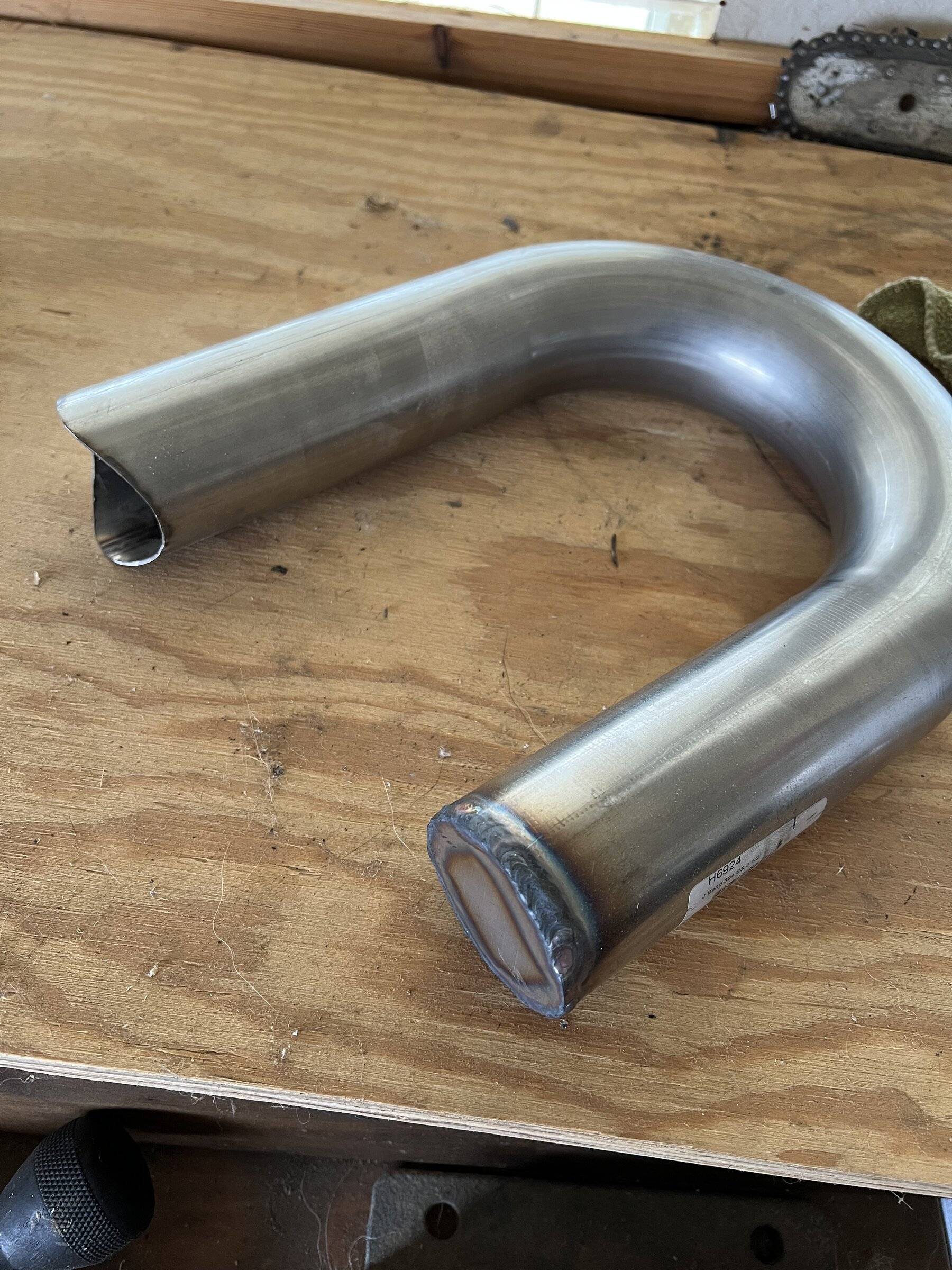

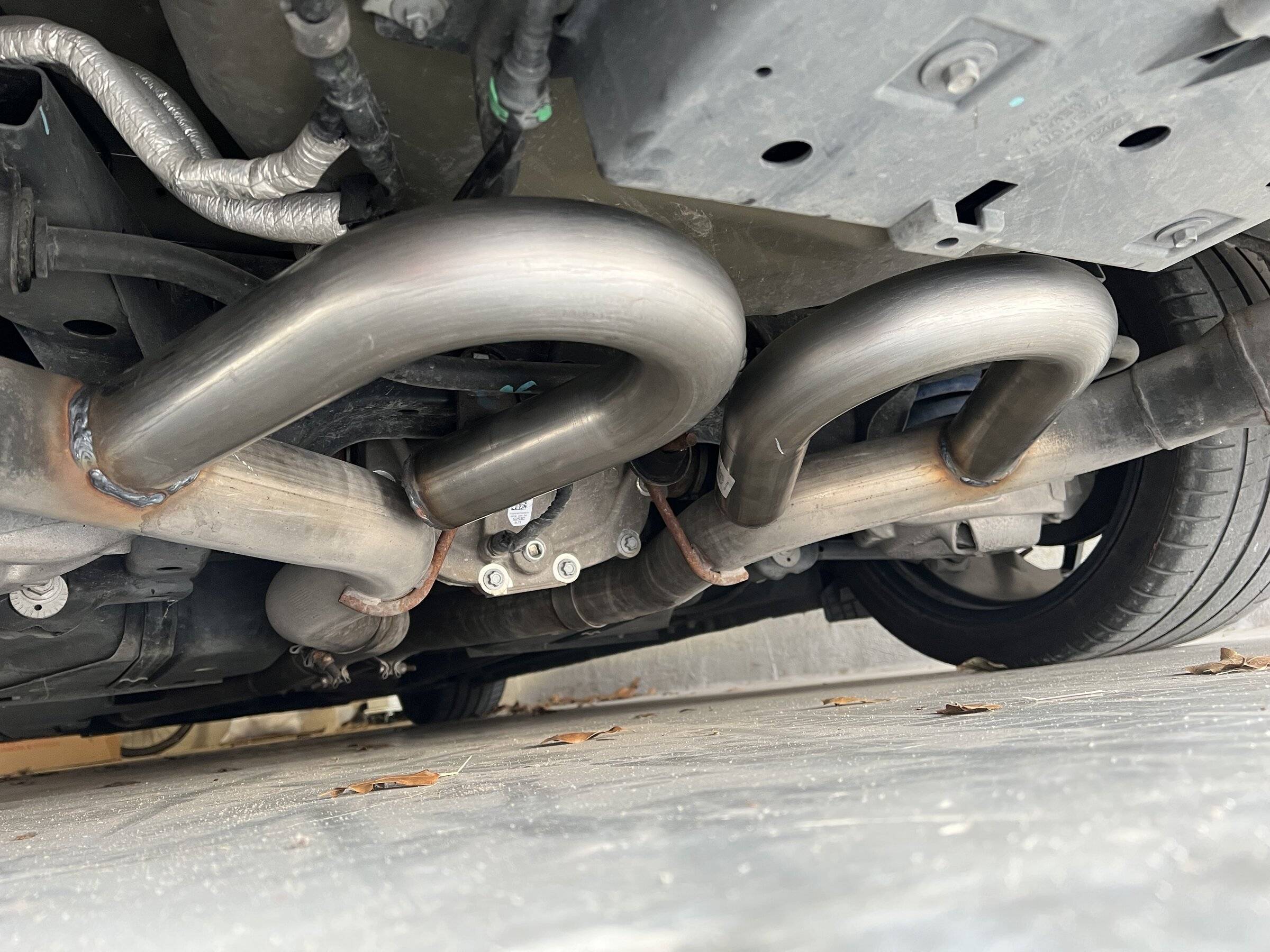

I definitely wouldn’t go that route. You will lose a lot of sound and the drone will still be there. The only real solution to keep the sound is the helmholtz resonator/j-pipe to eliminate the drone. Here are a picture of mine. I have the flow master outlaws and the drone was unbearable. Drone is 99% gone.

Yep, the Only way to kill drone with one's current exhaust is to change the length of the exhaust to cancel the harmonic's.
There's a formula out there that shows you what length pipe to use but an approximately 2 foot long Helmholtz pipe is close enough for most S550 applications.
The section I added to my 2018 was approx 22" long.
I used a 2.5" Vibrant bullet that was taking up space in my garage but a plain pipe will work.
The drone went from ear bleed levels with those Outlaws to nearly zero. Only had drone under load.

no problem, I went with 25” length to target 1800-2200 rpm range(it’s been a while so I might be a little off on rpm range) You could go with 2” j-pipes as they won’t take up as much room as the 2.5”. You also don’t have to use a u bend. It was just the easiest for me to buy it already mandrel bent.
