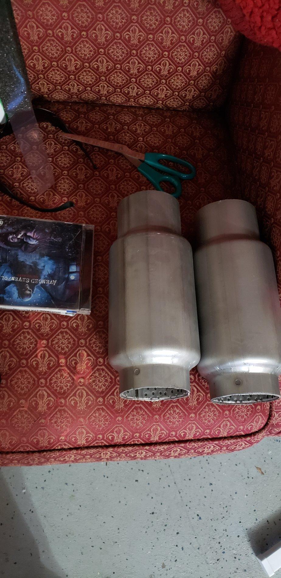

armykyle1 [HACKED ACCOUNT
Mar 20, 2016
74
1,849
625
Gulf Coast
2018 GTPP premium
These should work perfectly. Cupped my hands around the exhaust tip with one in my hands and it definitely knocks the volume down and gives it a deeper tone. I'll hopefully have them put on this weekend.
