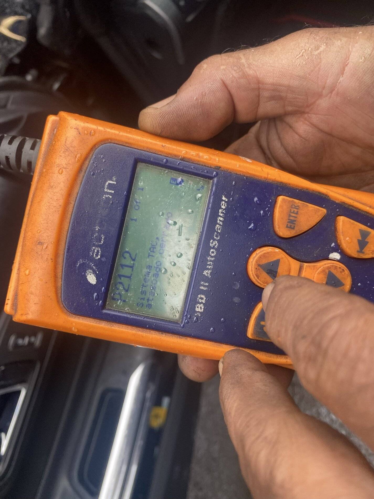

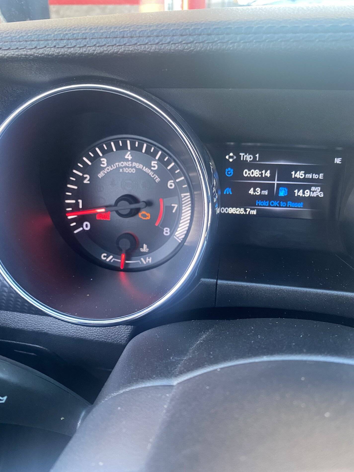

Really sending gratitude your way! I’ve managed to have them declare and sign a waiver indicating that they sold me a vehicle with aftermarket parts neither parties were aware of. Hopefully they’ll assume responsibility for this. But why would a rev limiter cause an emissions fail?
Because it is an after market part and you can be sure that the tune changed fueling parameters, not the red line only

I get this same code and fail safe mode when on the track, driving me nuts. I have a Bamma tune and I have the limiter set at 7400. Maybe I need to lower the redline? Always seemed to kick in on a down shift with a throttle blip and the car in a very slight drift. Usually going from 4th to 3rd around 80mph.
I’m getting my car back today. Had the Throttle Body replaced so I’ll keep everyone updated if it was just defected or had any relation to tune/software.

Yes, limp mode but only on the track. Not going to dealer, not under warranty. They will never figure it out. I can hear them now "unable to recreate the issue".
I can confirm I had a defective Throttle Body. Problem went away, kept tune, still rev up to 7500 and no problems
