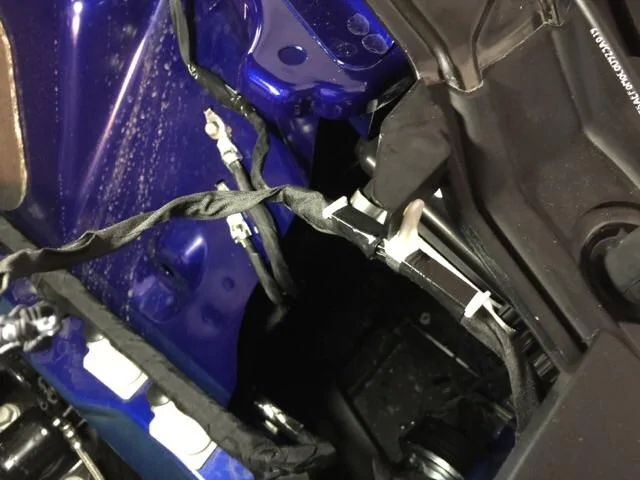

So I'm installing mine at the moment and have the airbox in the car. Did anyone else have an issue with the MAF wiring being too short to reach? What was the solution if you did?
O-H-5-0
Jan 27, 2015
278
104
Ohio
2017 AG GT350; 2016 F-150
Looks like the two options are 1) cut the fabric holding the MAF wires to the loom holder right in front of the airbox or 2) pull the loom holder for the wire the runs underneath the airbox to give more slack. From the pics I've seen, some people have really taught wires leading to the MAF and others have more slack (which I would prefer).
Any thoughts?
O-H-5-0
Jan 27, 2015
278
104
Ohio
Funny looking at yours it would appear the wires for the MAF split off before the loom holder on the front right. Mine is after the holder (see below) which is why I don't have enough slack. Obviously it worked for stock airbox, but not the Steeda.

Cable stretcher?
David@Steeda
Oct 17, 2014
78
3,433
1,911
United States
www.steeda.com
David
Bolt-on, slammed S197
Working on getting the install video up for you guys asap this week!
