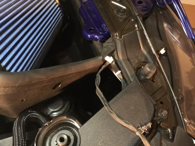

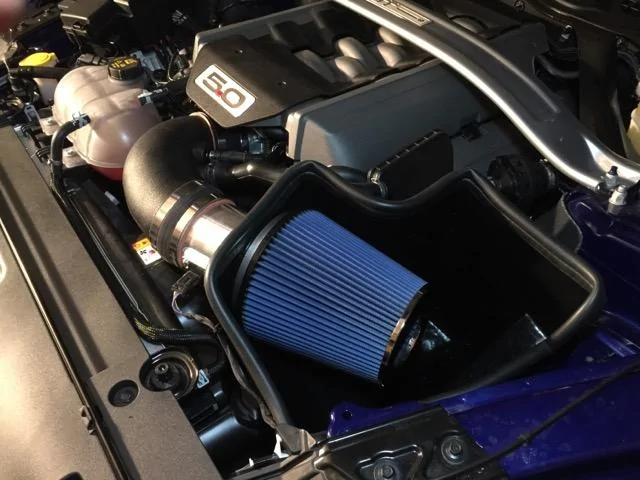

Wrapped up the install this evening after running some errands (including getting a rivet gun) and other distractions. Added 4 rivets to hold the factory piece onto the airbox like posted before. The MAF wiring issue was simple enough to fix by cutting open the factory wrap back to the middle of the loom holder (wires are individually wrapped inside). This gives enough slack to connect to the MAF. Otherwise a clean install.

Currently running the restrictor with no tune at all. Can't say I picked up huge power gains, but it changed the sound and some of the throttle feel. Definitely pulls strong in the when you hit around 4K rpm.
Goal for me is to drive around like this for a while, probably adding a catback, and then next year go for a tune to really open her up. Just letting any kinks get worked out before I start playing too much.
