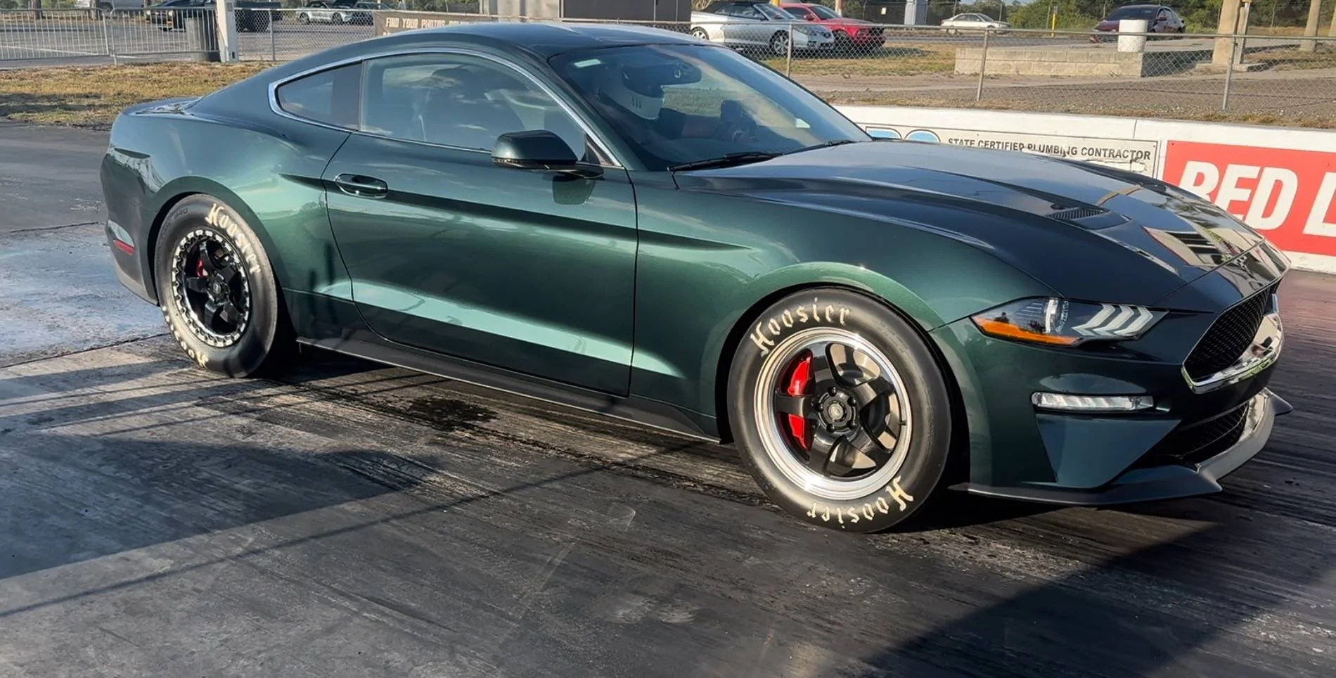

Do you have a pic of how your car sits now with the lowering springs?
Here’s mine with BMR drag springs and 1/4” Steeda spacers on 28.5 Hoosiers. I don’t have any rubbing issues (even when launching)..
