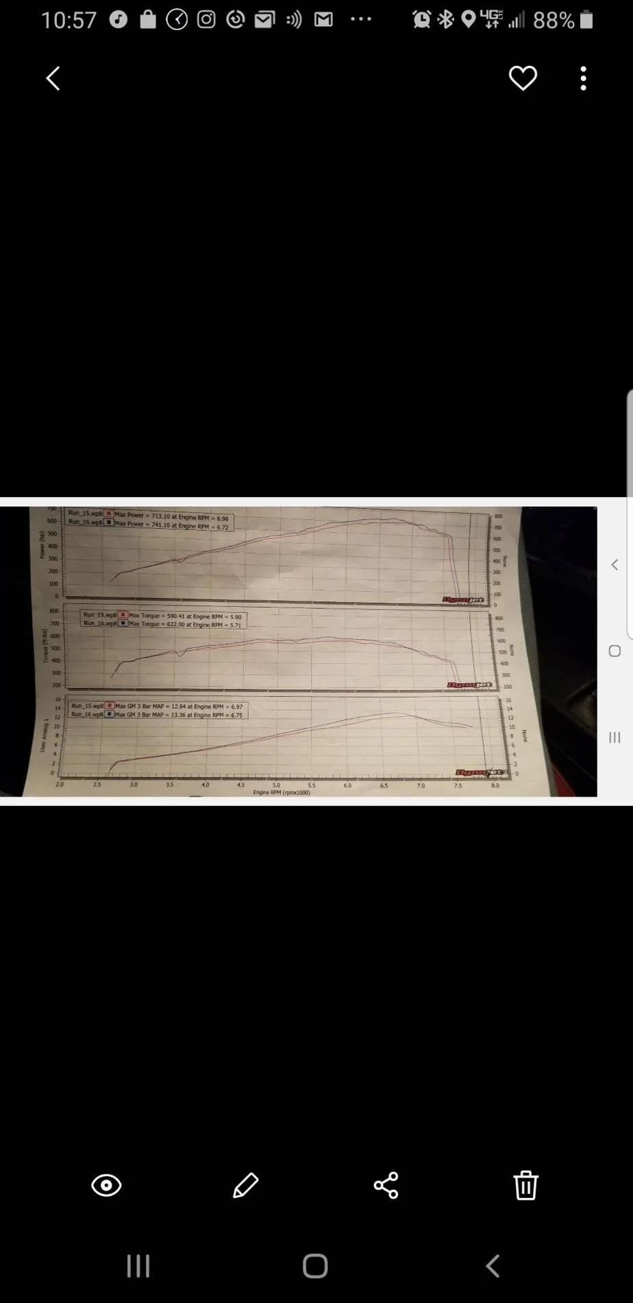

The big number is with a gallon of 110 and he took the JLT cold air pipe off. The 713 is on 93 with thr JLT on. But look at the drop off on the boost and hp graph smh
kcc0521
Feb 24, 2015
231
2,169
307
Falls Church VA
Bo
2015 Black GT PP
That makes more sense. I would go e85 and just run a 3.48 pulley and no waste gate.
