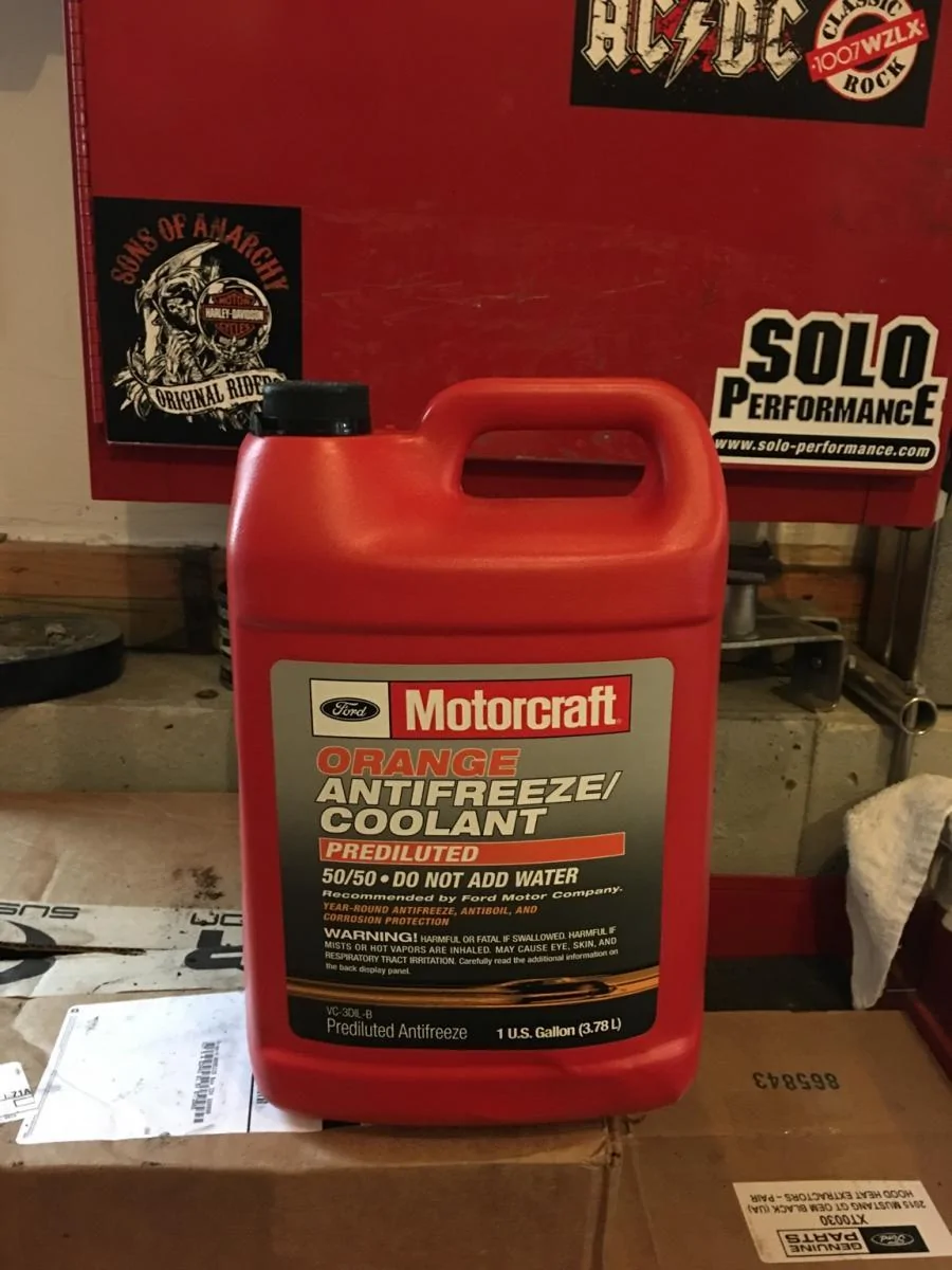

It's cheaper bc what you got is pre mixed. Ford only has 1 gallon concentrate. I was hoping they would offer it in quart size too but they don't. So I just got a gallon of Motorcraft and a gallon of distilled water. Now have plenty left over for MANY repairs that require coolant haha.
Actually Ford does sell pre mix as I bought many of them for my supercharger install. Here is a picture.
I asked my local dealership and he said they only have concentrate. Probably meant that's all THEY have in stock. But even if he said they could order it I would have just got what they had in stock anyway lol. Thanks for the heads up.

I asked my local dealership and he said they only have concentrate. Probably meant that's all THEY carry. But even if he said they could order it I would have just got what they had in stock anyway lol. Thanks for the heads up.
No problem. I am an online kinda guy and buy all my Motorcraft fluids off Amazon, even full synthetic oil and filter :)
