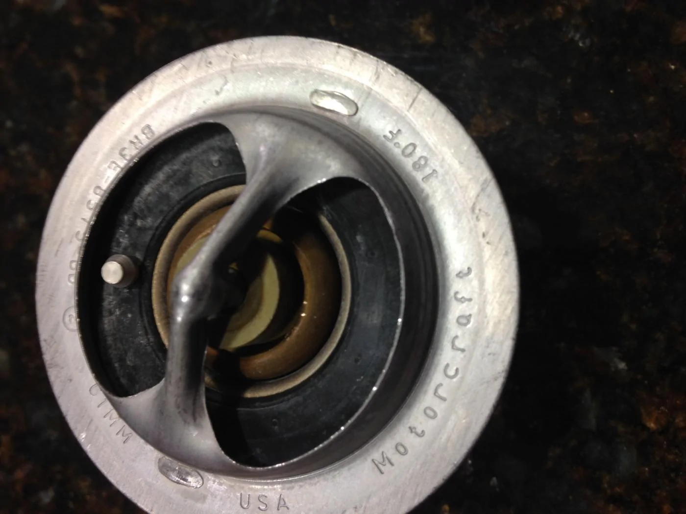

Attached is the original TStat out of my 15 Mustang GT as you can see you are incorrect about it being a 178 it is clearly marked 180. I know it is only 2 degrees but if your coming here as an expert you should at least have your stats correct.
Wow, thanks for posting the pic. I had a shop install my whipple and just assumed that they didn't install the 160 thermostat that came with the kit since my cht temps were around 210 with normal driving. The thermostat that I pulled out when I installed the Reische looked completely different. I posted pics at the begging of the tread.

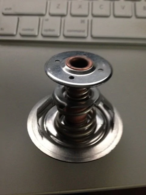

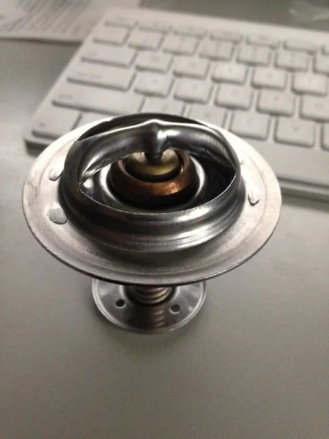

Here is a pic of the Even Flo 160 it has 4 holes on the bottom and the design of the bottom is completely different than that of the stock TStat or the 170. the stock TStat has a spring loaded bottom and the Even Flo is rigid from top to bottom. When I say rigid from top to bottom I mean the copper colored part is rigid but the outer ring is spring loaded on the Even Flo. Stock has a two piece inner part that moves. Hope that makes sense.
