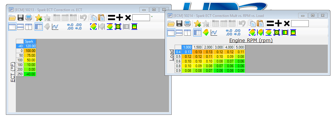

Did you not see the pictures of the timing adder tables for ECT that I posted? Those are stock and adder tables add to the base timing. Using a lower T-stat will add timing if you are modded/tuned or stock by lowering coolant temperatures. That will increase HP either way.

lets say the stock thermostat keeps you coolant temps at 200* you get 0 timing adder
you replace your Tstat and now your coolant temps are at 180* you get 10 timing adder
Multiply those by the load vs rpm table and stock you get 0 timing added and with nothing but a new Tstat you get from 1.3* to .6* added. That's not a lot, but it allows the ecu to add timing with out even tuning it. You get power from a tstat. Possibly 5-15hp.
if the stock tstat lets the coolant temps go over 200* it will start to pull timing. It is more likely to do this than a lower temp tstat.
