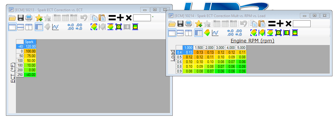

Given that you have access to hpt it should be pretty easy for you to simply click on the ect modifier table and look at how colder and hotter temps affect spark.

for anyone with out access to tuning software here Is the engine coolant temp vs ignition adder table and its multiplier. It explains why you want lower coolant tempatures. above 200 it pulls timing below it adds.
Don't get confused. You don't get 10* added. You might get a little more than 1*, but when 1* means 10hp I think a 65$ t stat is worth it.
When I say people don't have access that's not very true. You can download a free trial and one of the many tunes all over the forums for your self's and check it out. Its technically public knowledge.
there are many other tables like this that show you how to squeeze more HP out of your engine with simple things.
