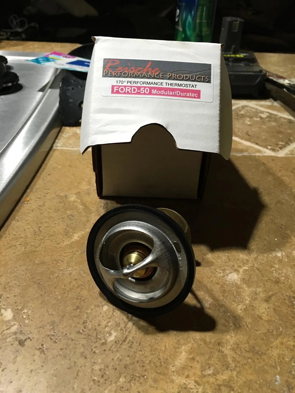

What thermostat are you running?
I have seen as high as 197 when driving hard.
There are several 160F:
Duralast (possibly Motorad)
Motorad labeled (shipped in Whipple kits)
EvenFlo
??possibly others??
Do you have any pictures of your Thermostat?
Thanks..
Maybe a supplier switched mfgs and some are getting good or bad product from same supplier?

http://www.mustang6g.com/forums/showthread.php?t=37575&page=17
^^^ The prove that the 160 isn't as good as the Reische 170 is in this thread. Try searching before running your mouth.
Lol. Go easy on the guy.
I do agree that it is ridiculous the 160 marked tstats are not opening fast enough and under performing the 170 rated high flow curve Reische.
Lol on the air in system! I was hoping that air was my problem. Thats an easy fix but nah, tstats just not performing as hoped.
