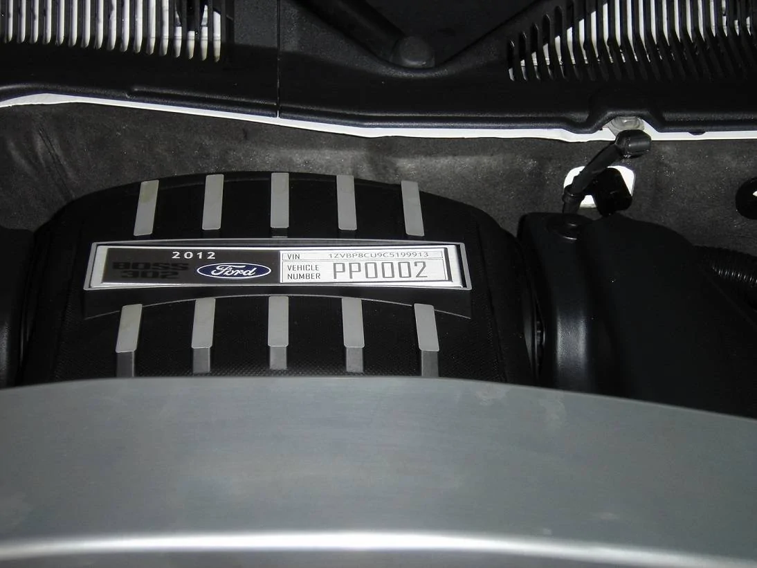

Back in June 2013 I was able to locate and purchase "PP0002" which was a 2012 Pilot Production Boss 302 (1st 4 seat PP Boss 302 built in October 2010) and it had the original OEM Motorcraft battery in it upon purchase.
For the next 6 years of ownership I regularly used a battery tender on it and in addition I would disconnect the battery when in not in regular use.
Ended up selling that car to a great friend of mine up in Pennsylvania in 2019 and it is my understanding that the original Motorcraft battery still continues to fire up PP0002 after 10 1/2 years of use.
I realize that I am pretty anal when it comes to OEM Motorcraft batteries but must say that had good success with them over many years of ownership.
