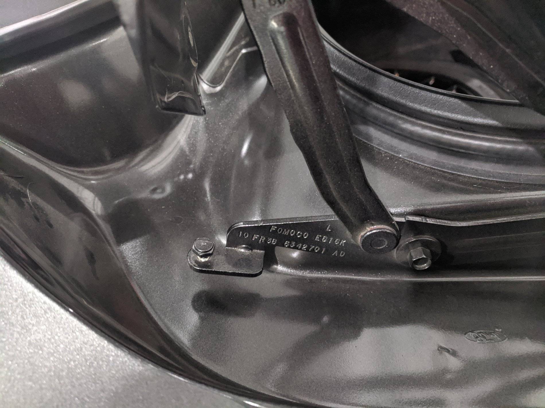

OK, so another month down the road, and I'm about to burn this car on the side of the road.....
I've had the rear of the car up in the air looking for anything suspect or loose, and everything checks out. Besides, it seems totally isolated to the trunk. However, just last night, I noticed that there was sort of a witness mark on the hinge stop on the driver side (see pic). Aha. The paint on the corresponding spot to it on the hinge bar is also showing wear. I backed it out two full turns and took it for a drive, and it seemed to help at first but now it's as bad as it ever was.
I assume I need to keep backing it out so it continues to put pressure on the hinge when the decklid is closed. Correct? Anybody got a PDF of the Ford repair manual?
The only positive in this ordeal is that I have the trunk latch adjusted to perfection, I can close it with barely any effort now.

Very cool. Bookmarked.
Unfortunately, it doesn't provide much information as to what I'm looking for in this instance, however. I guess I'll have to keep adjusting at random.

Right. Again, the PDF doesn't give enough info. I'll just have to keep adjusting the hinge stop at random as stated above throughout its range of travel and see if I can get the rattle to stop.
The real question is what changed - I didn't have the rattle until this spring. The car used to be dead quiet. Apparently weatherstripping has settled or something.

Tried packing the hinges with shop rags to no avail....
But see that part in the bold? That was essentially it. I had checked shocks once before as mounted in the car, but didn't think that was it until I ran across a thread last week that mentioned that some guys with the older design of the Steeda shock mounts (which I have) ended up with a noise. I pulled the driver side shock out, and there was just a hair (probably .010") of slack between the nut and spherical bearing. Not sure how it loosened up with my liberal use of threadlocker, but I tightened it back up and reinstalled it, and the noise is gone.
Steeda has stepped up and is going to send me the updated hardware. Good stuff. I don't want to trade the car off anymore.....
