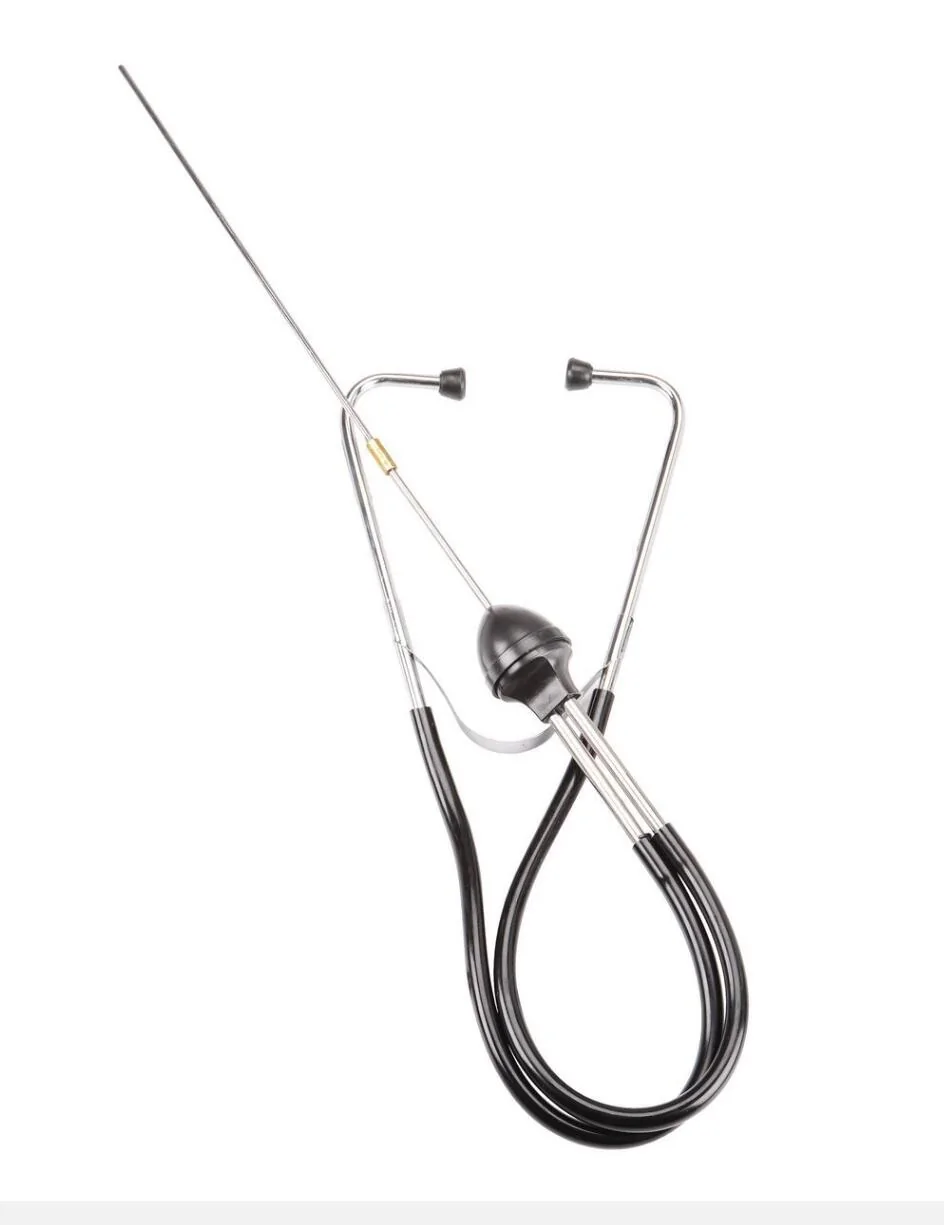

Pick up one of these and listen to the various areas of concern like bearing and the supercharger.
Auto Stethoscope
