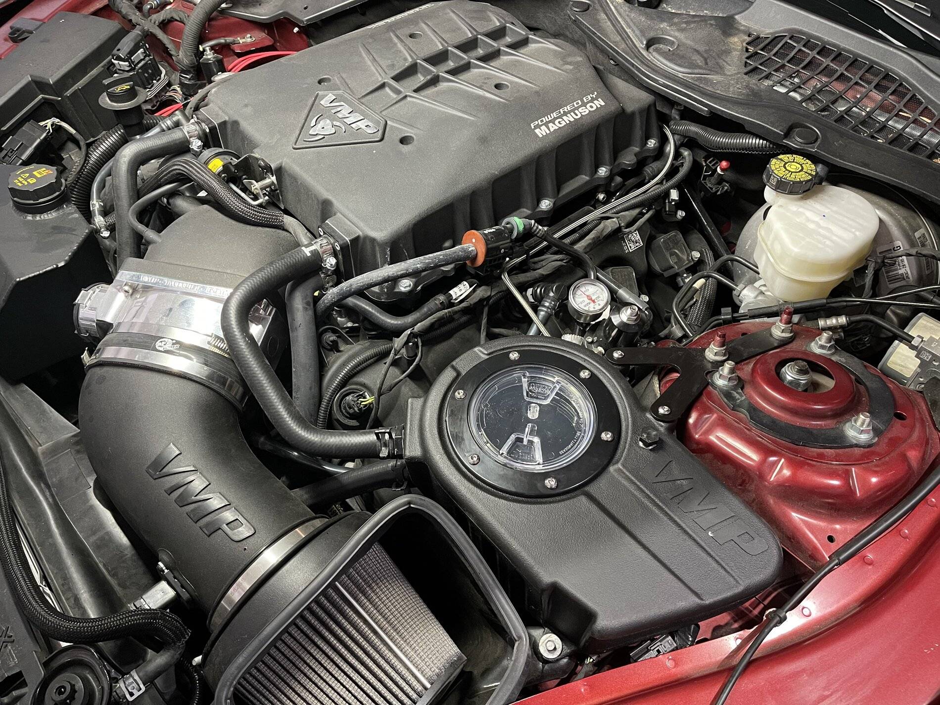

VMP has an underhood tank that doesn't, and goes right by the CAI.

VMP has an underhood tank that doesn't goes right by the CAI.
i was wondering when someone was gonna mention the VMP one. are you using it for ice at the strip or just as a coolant reservoir for everyday use? i know 3 guys with gt350's and they are all mainly using it for coolant reservoir but vmp says it's best for the strip.

Mine is primarily a street car, but I'm using it both ways, go to the track, drain it down halfway, pack as much ice in as you can, circulate the water, repeat a couple times then top of with ice and run. Not as great as the big PNR tank I had, but much lighter and packaged better.
