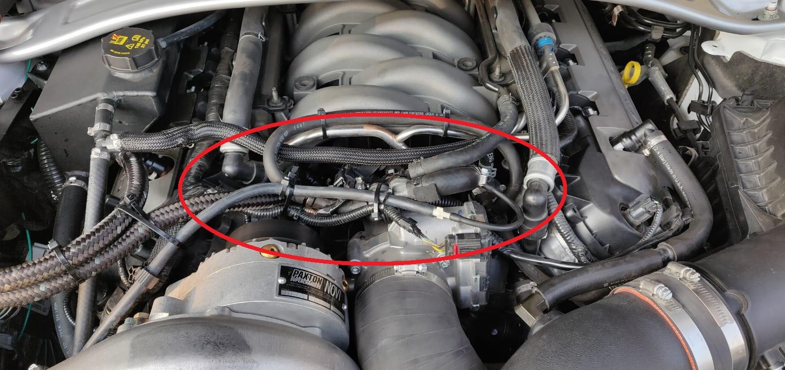

Posted this before.. Originally thought it was my BOV, then my cats.. I went to get my cats deleted and due to some issues (I ordered the 3" connect from MAK), my garage quoted me 4 HOURS of labor of a cat delete install. You best believe I ain't paying 4 hours of labour for a cat delete.
So until I find another shop to get it done from.. I need some help from you guys to hopefully identify the noise. My pockets aren't deep enough where I can leave it at the shop for them to find unfortunately.
I still think the sound is coming from the bottom of the car but my mechanic told me that its most likely coming from the IM or its a vac leak somewhere.
So, as a recap:
This sound ONLY happens if the car is warm and I drive it around somewhere, can be just on my street or on my driveway. It gets louder upon shutoff if I drove it for a while. The sound ONLY occurs when I turn my car off.. However I do think their is a higher pitched exhaust sound that I THINK i can hear when I'm idling.
I really need some sort of suggestions.
^^^^^^^^^^^^ I checked this clusterfuck of hoses in the middle, everything seems snug.. Can't really pinpoint the noise.. Seems to be coming from underneath there. Is there a line or something that could be loose down there??
Please keep in mind, I am not the most mechanically skilled but I am learning and can do things with a little bit of guidance.
Not sure if this is relevant but this sound started happening immeditealy after I did a smoke test to check for leak.. At the time being the smoke was only seeping from my BOV which is now fixed.
Someone please help me out or point me in the right direction.. I will literally mail a bottle of some nice whisky to ya if I can figure out TF is going on!

Turn AC off and try again. Same result?
Unplug evaporate solenoid and try again?
Be careful if this is from debris stuck in evap valve, don’t want to suck anything into intake.

No difference with AC, whether on or off.
I can confirm this is coming from the bottom of my car.. Not the top. It is MUCH louder underneath my car.. Could it be my cat like I originally suspected??
Thoughts?

If you hold the brake pedal down when you shut the car off, does it change the duration or tune of the noise?
I'll check this tomorrow and let you know.
Usually just put the parking brake on but I'll try the brake pedal and shutting it off

This sound started happening immediately after I got a smoke test done.. Where do they pump the smoke in from? Maybe that is where its leaking from because it is not properly sealed? Can someone point me to where it would be pumped in from.
Ruiner46
Aug 12, 2016
492
291
Colorado
2016 CO GT PP
Easiest spot is the brake booster line. You should try what F1scamp suggested, see if the sound changes with holding the brake pedal, or pumping it.
