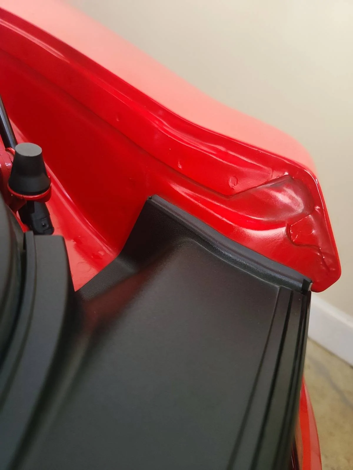

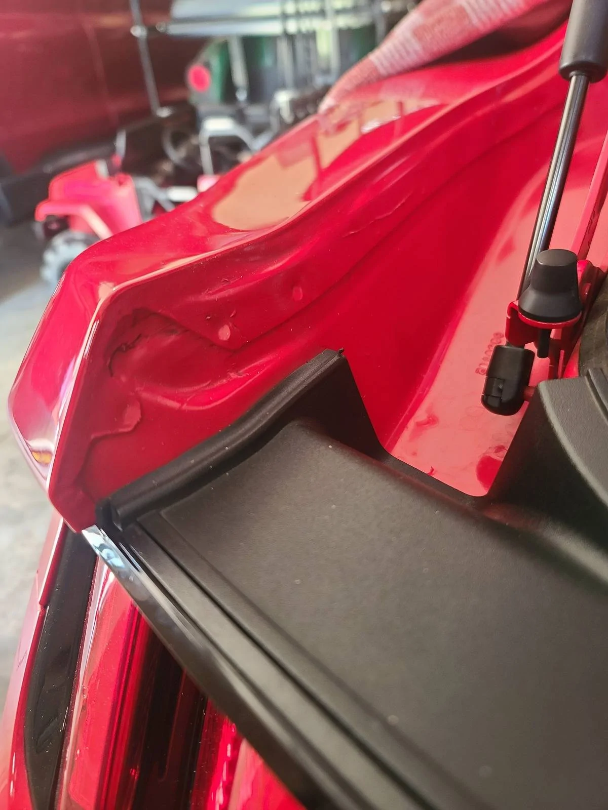

For reference, I just took these pics for you. Also for reference mine is a 2016 GT. The "dark" area on the driver's side is just dirt. The interesting thing is the passenger side looks a lot cleaner and neater than the drivers side. LOL

Also I'm really not sure on my opinion because some things make me think it was a repair but then I look at other areas and it looks factory with lack of quality workmanship from the factory. It's weird man.

I'll check my car, but I don't think that is a seam.
it doesn’t look like a seam to me either. To the left of the cut/tear you can see where something has scraped along the paint.

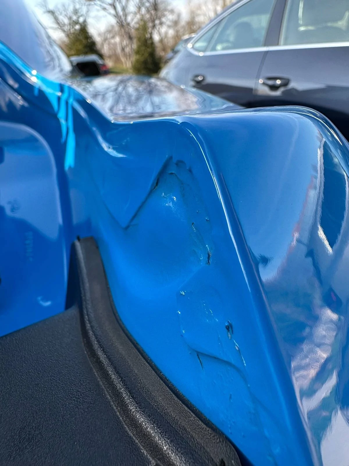

As Biggus Dickus pointed out, I am attaching these pictures where it looks like more failure in the same corner.
Good luck with that - the cure is surgery, but the cure might be worse than the disease.

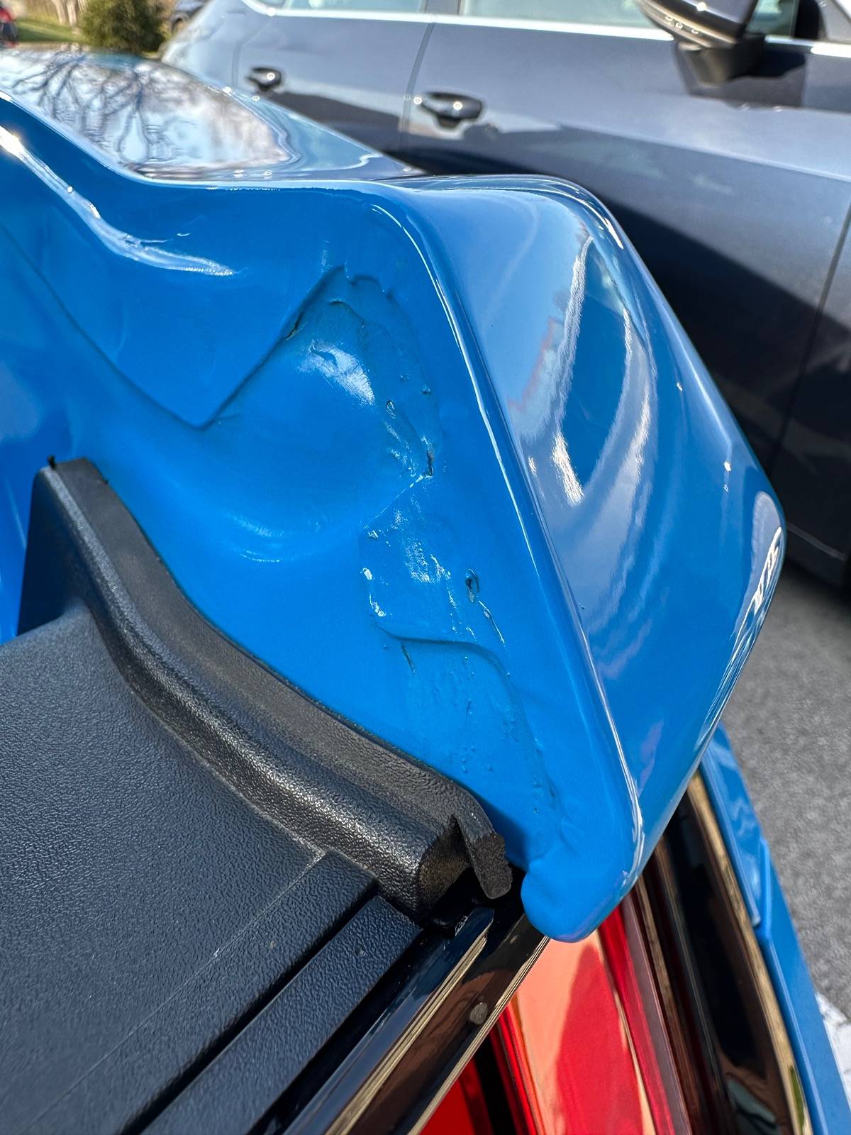

Well, this is a strange one. Took the car for its first wash of the season and discovered this 2-inch gash on the inside portion of the body. Car was sold clean title with no accidents. Has anything like this happened to anyone else? Do we think maybe there was an unofficial, unreported accident and repair? Had the car since August 2022 and never noticed this.
You could drill a small hole like 2 or 3 mm, at each end of the crack it should stop it spreading. Then seal it.

My guess, since it's a GT 350 the right quarter panel was smacked really bad while on track and most insurance companies will not cover track damage, so the previous owner paid out of pocket for the repair. That would explain why there is no record of any damage.

Even if no insurance was involved, I would imagine most reputable body shops report to whatever system is CarFax. I mean, I had curb rash repaired and I see that on the recent carfax pulled.
