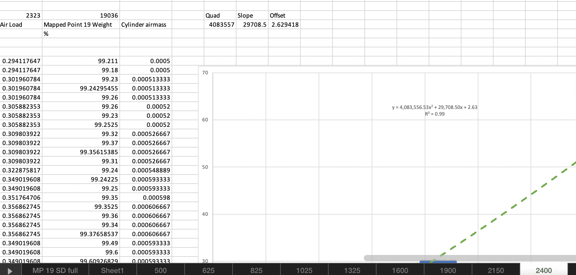

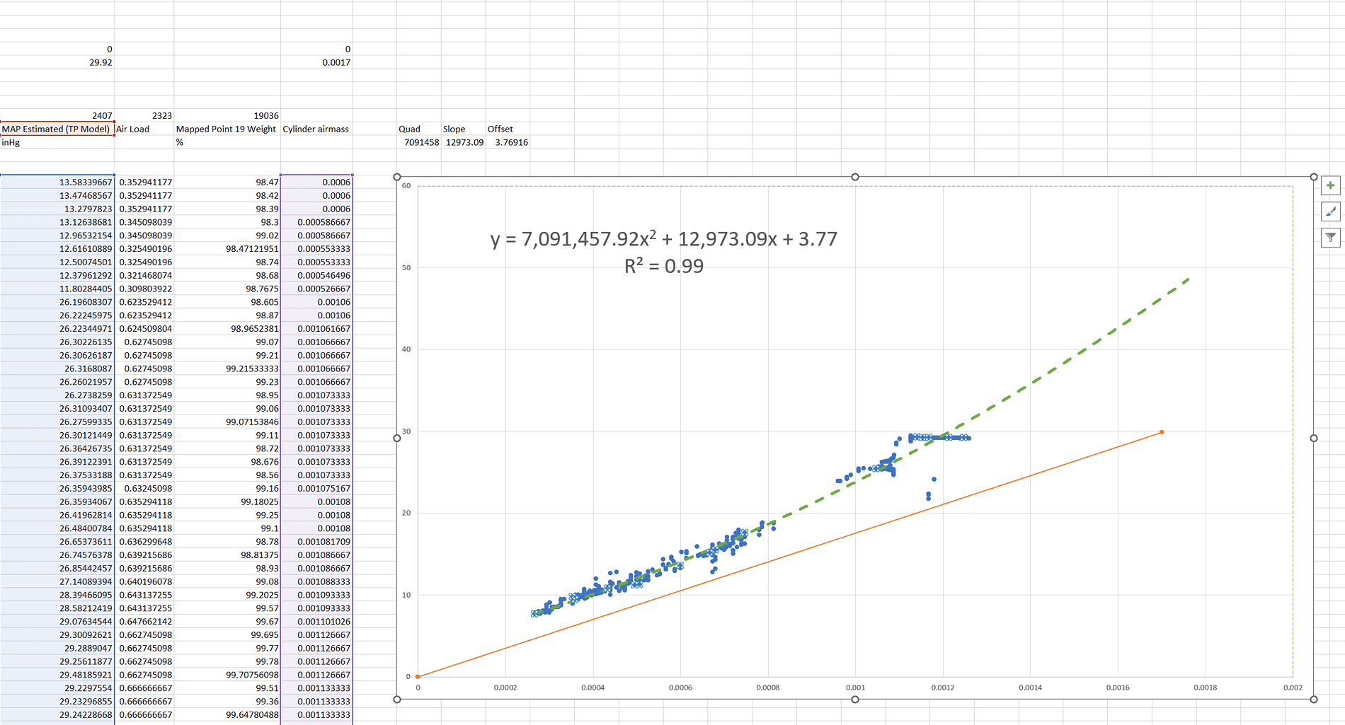

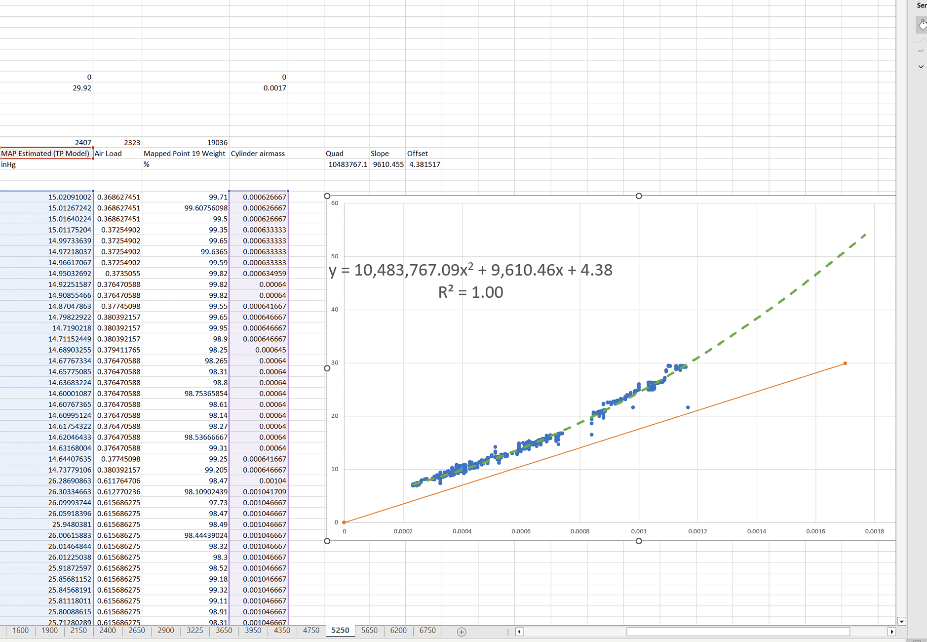

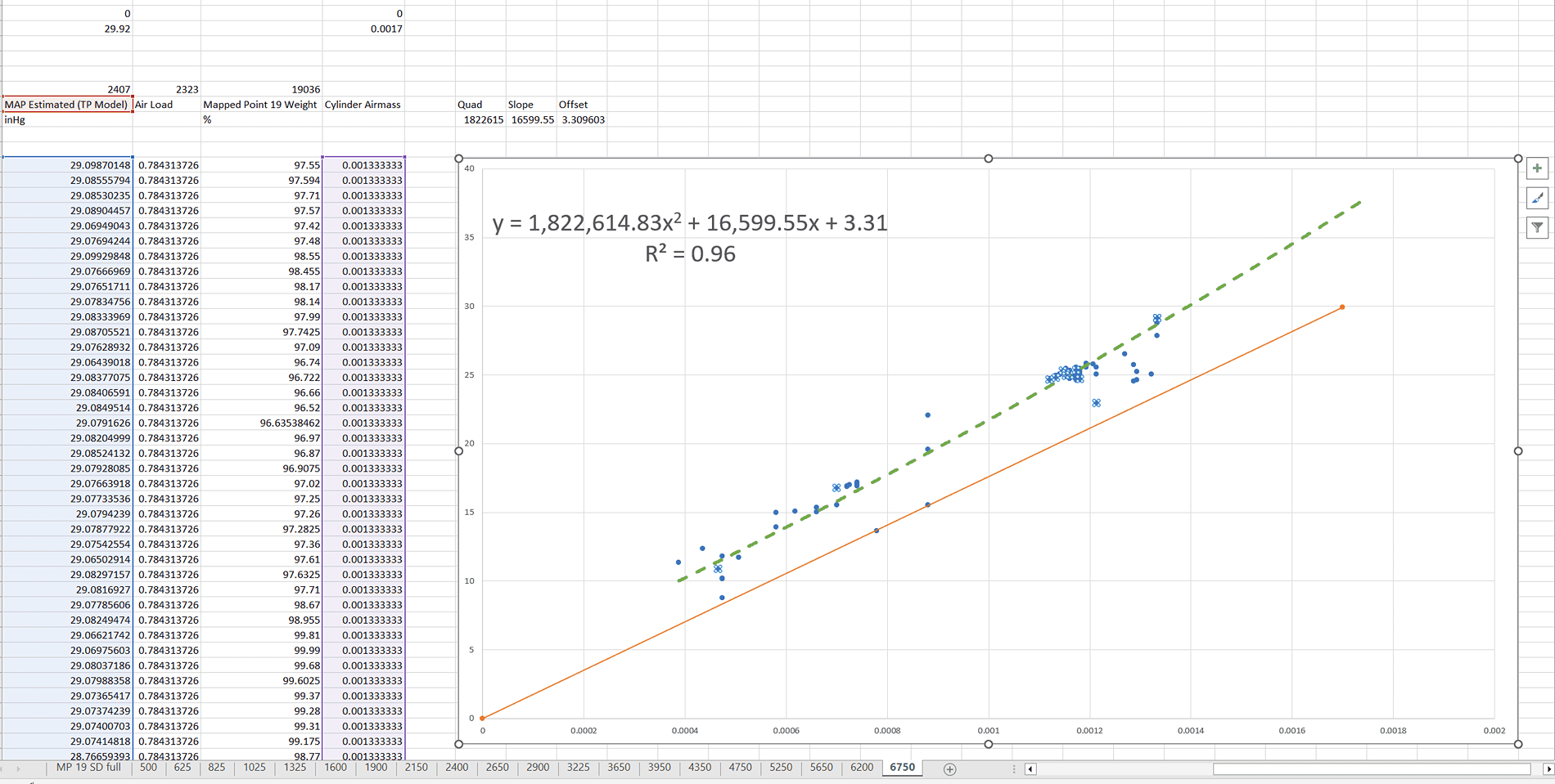

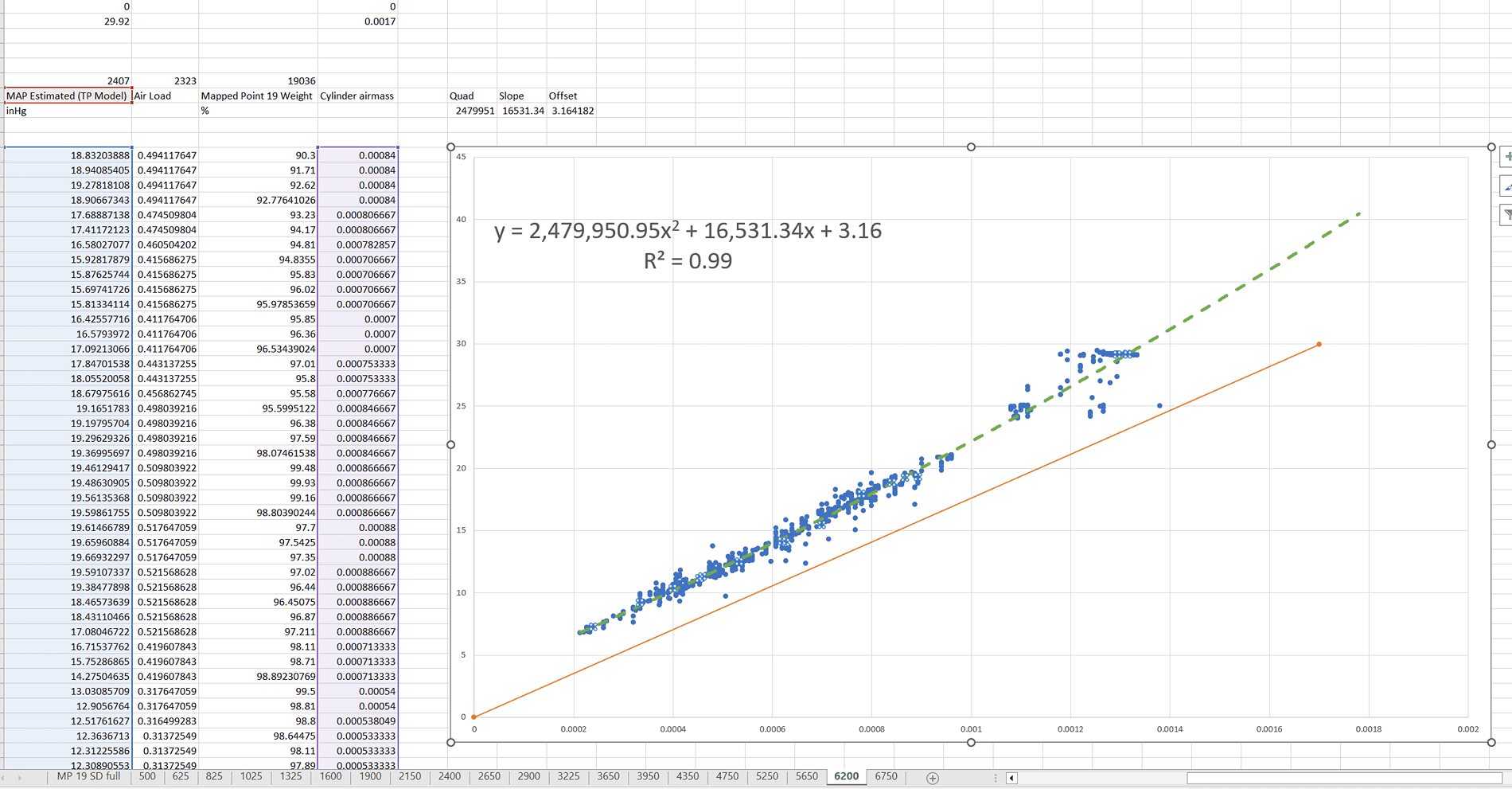

Heres my completed sheet with all RPMs set up in tabs, filtered +/-250rpm and MP19>90%. The lower RPMS didnt hit MP19 much so I filtered all that I could.
Looking through this you may see what I did.
Curves all go away from 100% VE at these angles.

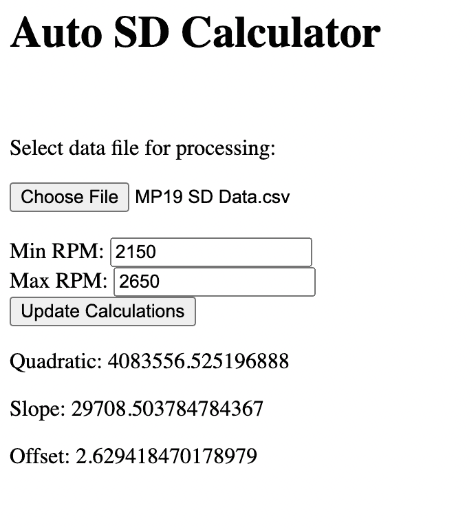

Updated Version with Graphing: https://www.mustang6g.com/forums/threads/tdstuart-tuning-adventure.201824/post-4073465
Okay here is a tool to automatically do it. Extract the zip and open the .html file with a browser. Click choose file and select an hptuners log file in .csv format. It will open and start prompting you questions. It basically just asks if you need to filter a mapped point and what percent and above to filter for. Once that is done the options for rpm will appear. Enter a min and max rpm and hit update calculations and it will update the math for that selected rpm range.
I tested it comparing marks data he sent me and it was spot on.
How to use video:
Currently only accepts unedited hptuners .csv files
If anyone wants me to expand the files it can take let me know. If you know html&css feel free to make it look better, I hate design.
