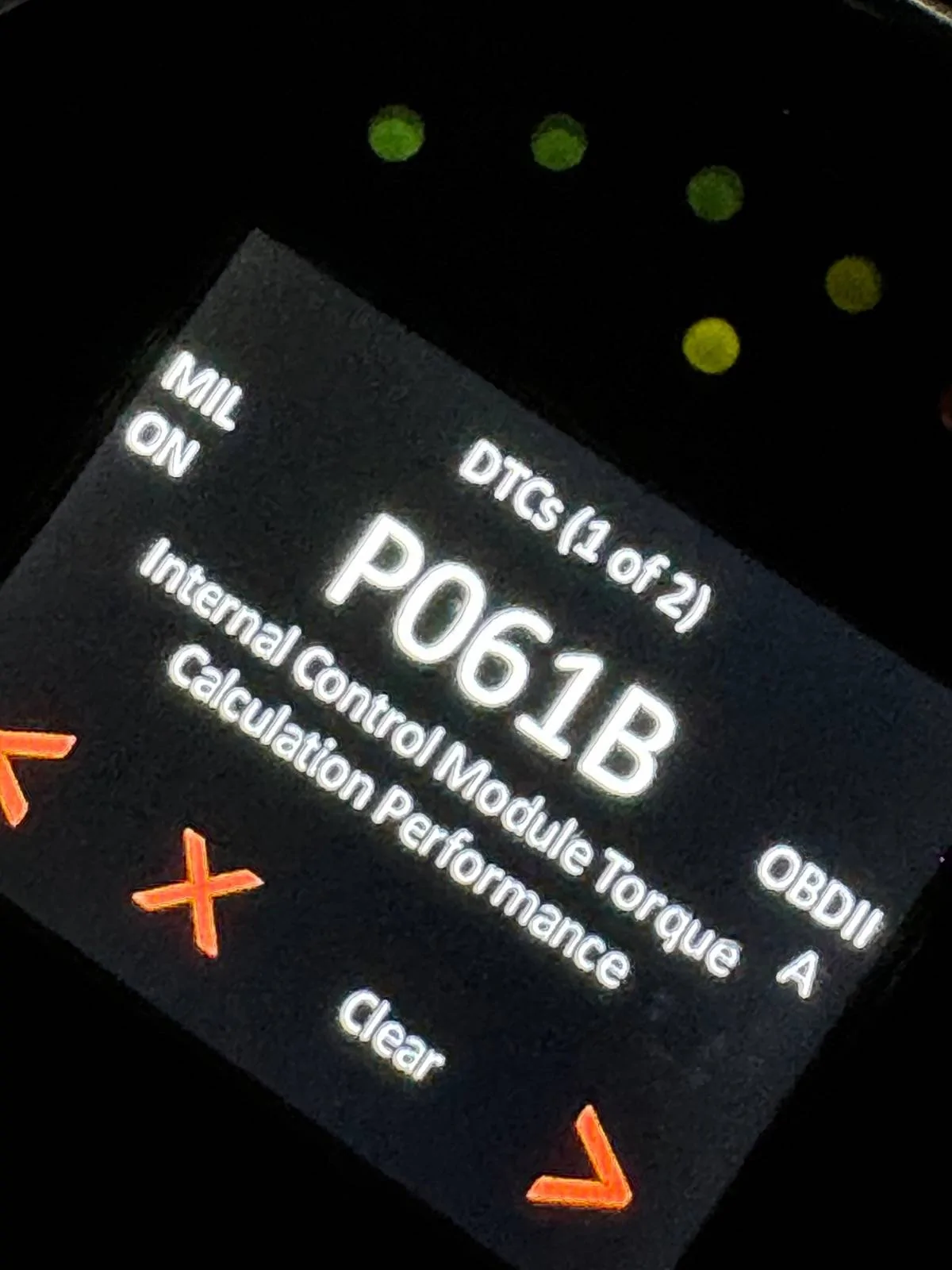

Threw a code went into a reduced power mode. Clearing it doesn’t work imma reflash the car as I need to drive it. So annoying. Fuel trims have been looking good and car was driving good. I think it’s mad at the fix…

Have you not started tuning your torque model?
You have to correct the demand torque to what the ECU is estimating the engine is making for torque. Make sure the IPC max and min tables are out of the way, then move them back in on the variation once you have the torque error reduced to an acceptable level.
Theres quite a bit of moving parts to this torque model and tuning it.
Theres demand torque and the engine brake torque that is an estimate of the torque the eninge is making at the current air properties, spark, fuel, cam positions, ect..
Then theres the indicated/ schedule torque at the given RPM and air load. This is used to eliminate much of the variablity those other variables and many others cause. It provides a much more stable and consistent model for the ECU to impose limits and saftey control from.
Where and how you want to correct the error in all this is subject to many differing opinions on the "correct" place and methods to do it. Many move the IPC min and max out of the way, raise the allowed torque error, then never move them back and solely let the PID correction loops work hard.

No it’s running the same tune file I sent. Should I bother tuning the torque with the stock inj/cai or just wait until I put the lu47 and PMAS back in?

What ever you're more comfortable with. Having known good when learning eliminates a lot of questions.

I worked through some torque errors recently in my Roush truck that were caused by an inaccurate TB model. I believe this is also related to the SD model’s inaccurate manifold pressure output in tdstuarts car.

It's a pretty common code and easy bandaid don't get discouraged yet... Lol
