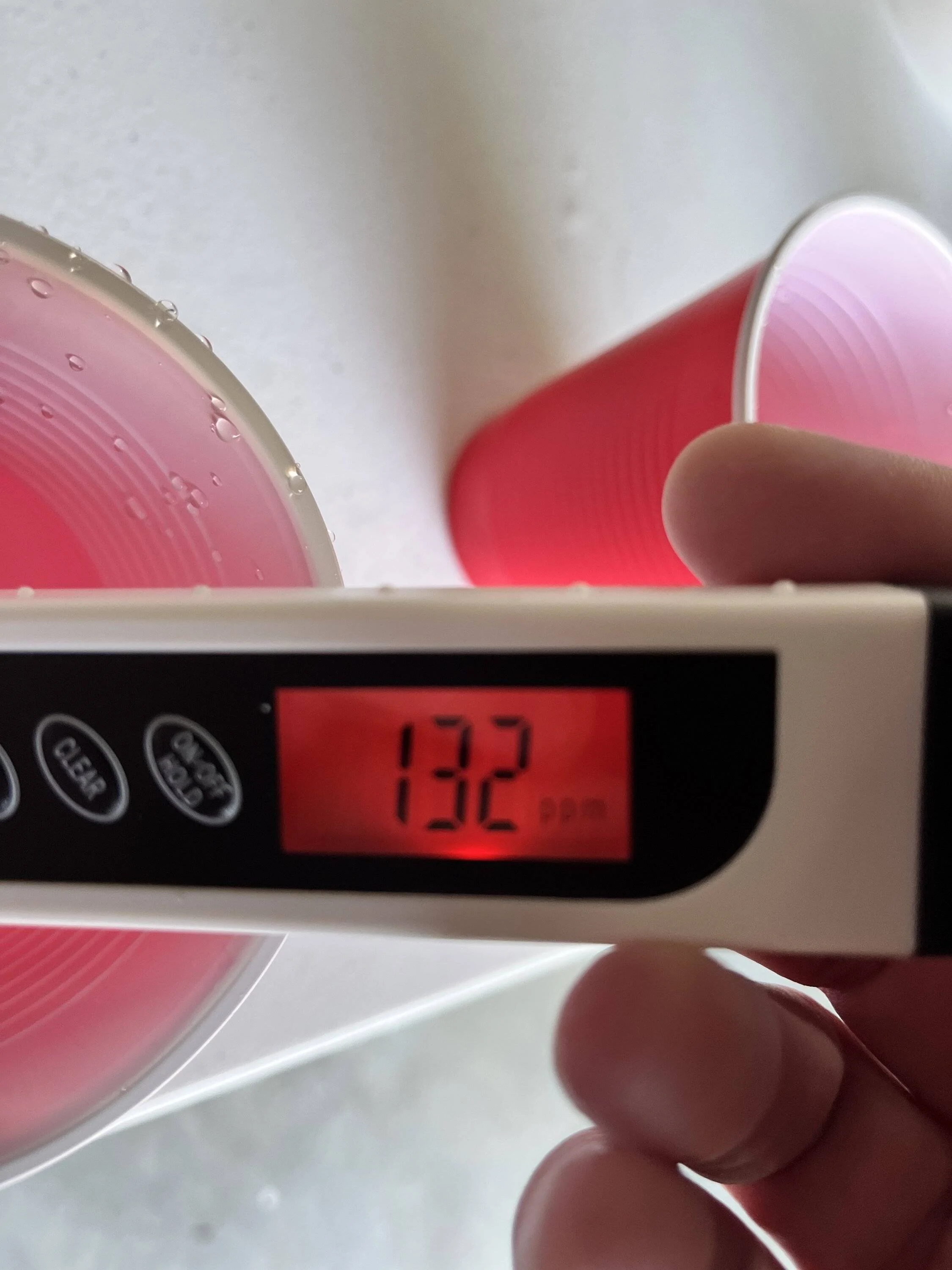

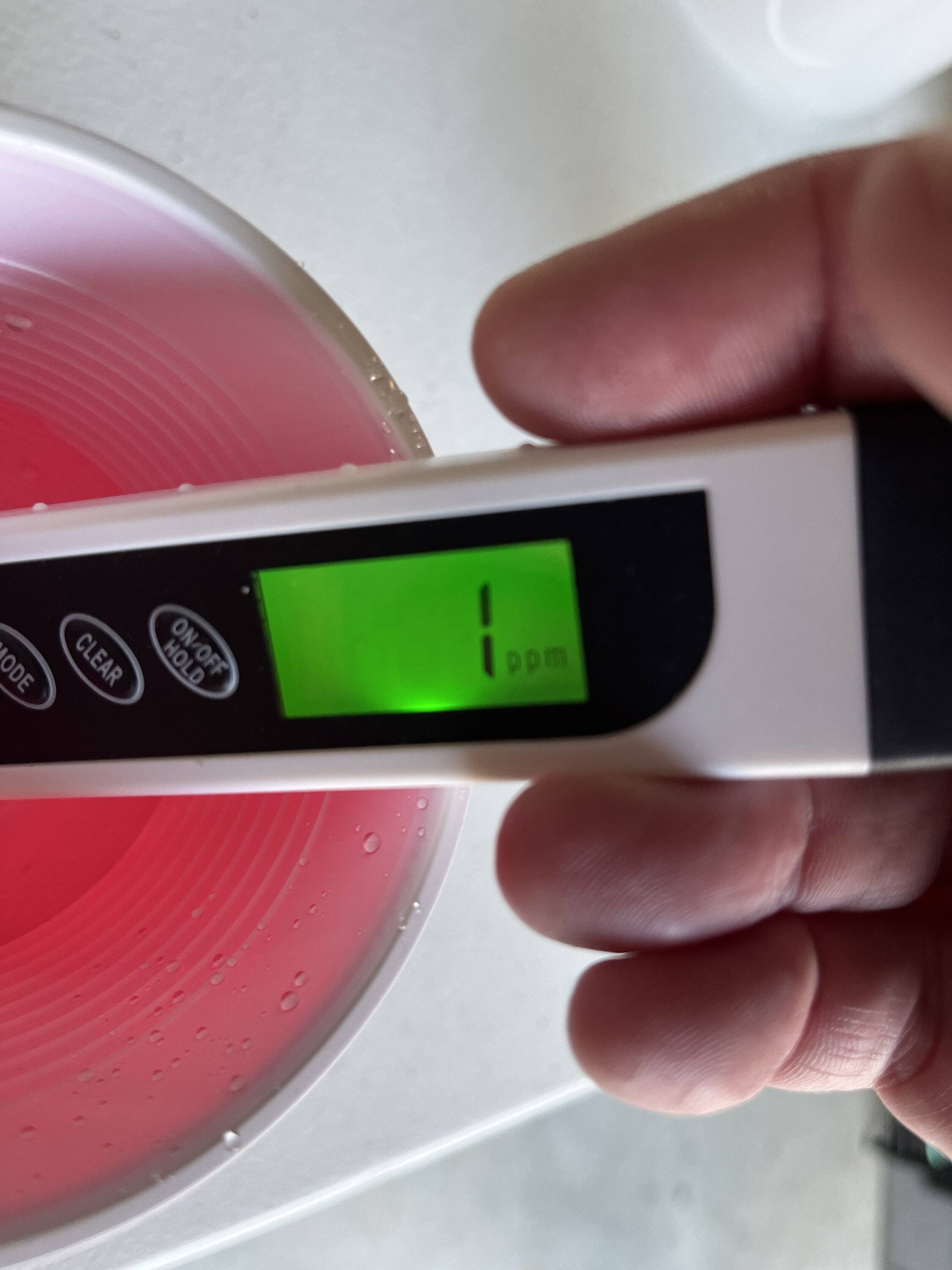

Well I did my weekend wash this morning and messed with my new TDS meter. I took 2 plastic cups and collected water both on bypass and on filtered water. Very impressed for such a small unit.
On Bypass.
On filter, filter resin is about half spent at this time.
