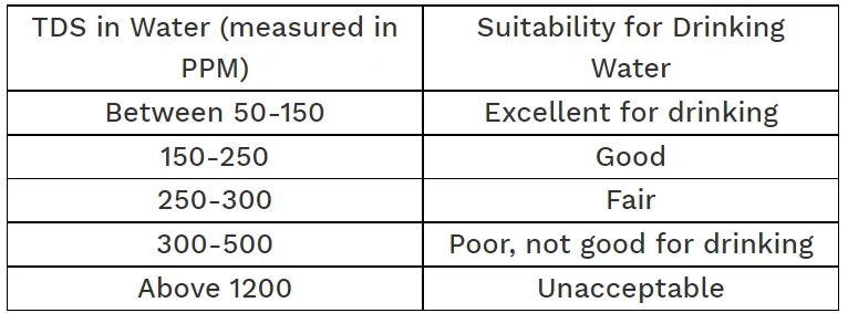

When I looked into this subject, I came across this chart -
Going by that, 138 would seem to be quite good.

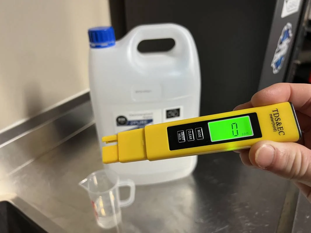

For reference, demineralized water should read at 0 -

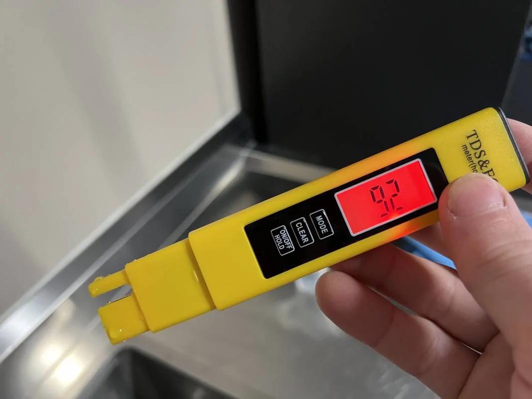

My town/tap water reads at about 92. At that level, I haven't bothered with filtration. -

I'll take it 😁. However I will still filter for rinse as I get really bad spots otherwise unless it's really cool and cloud and/or I dry very quickly. Drinking quality and car washing quality I guess are different things. I do know it suds pretty good in the bucket and foam canon so can't complain there. Hoping for as close to zero when I test the weekend on my weekly dose of Car Wash Therapy

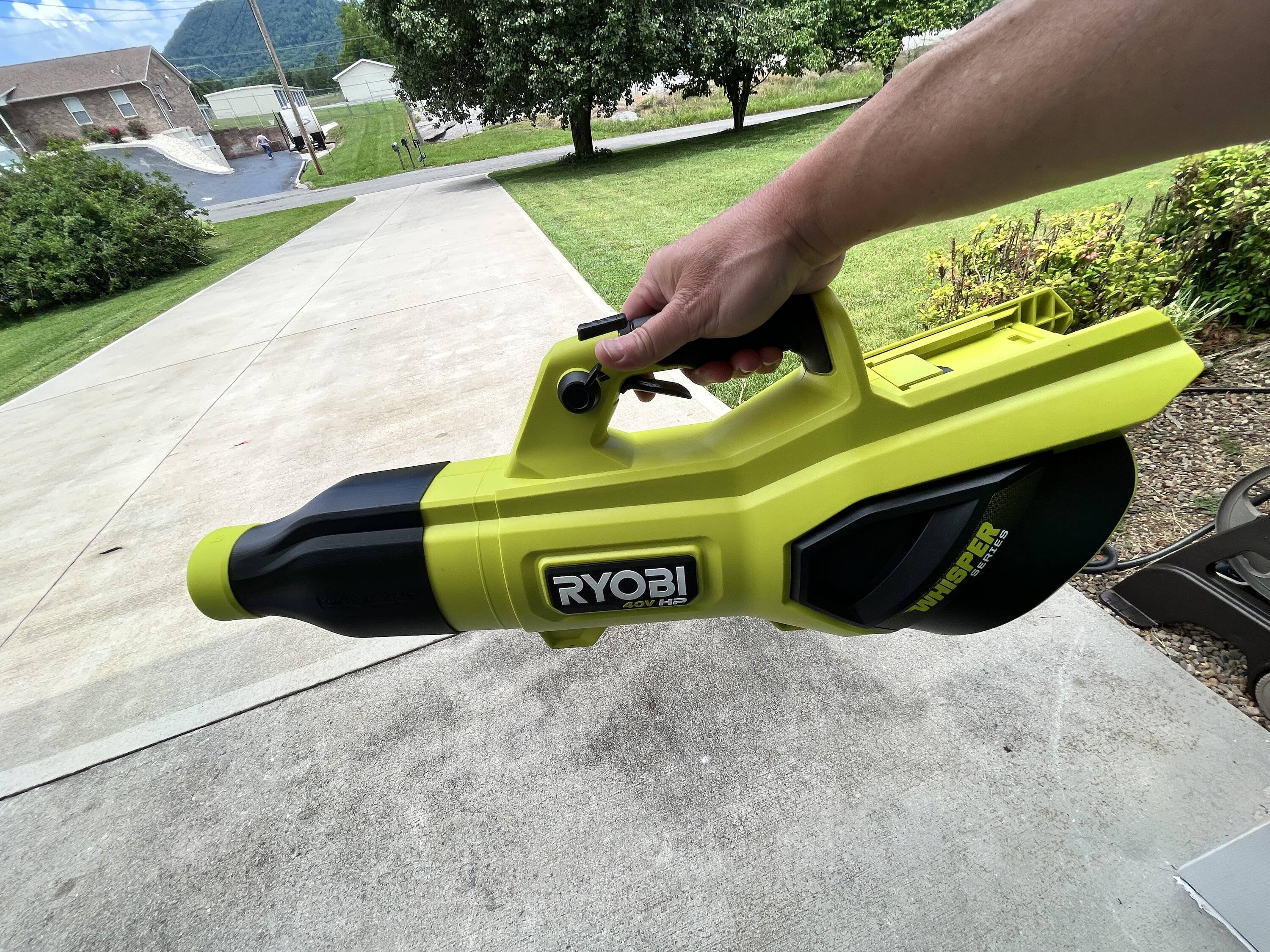

Definitely blow first 😁. But if the sun is out it's a race

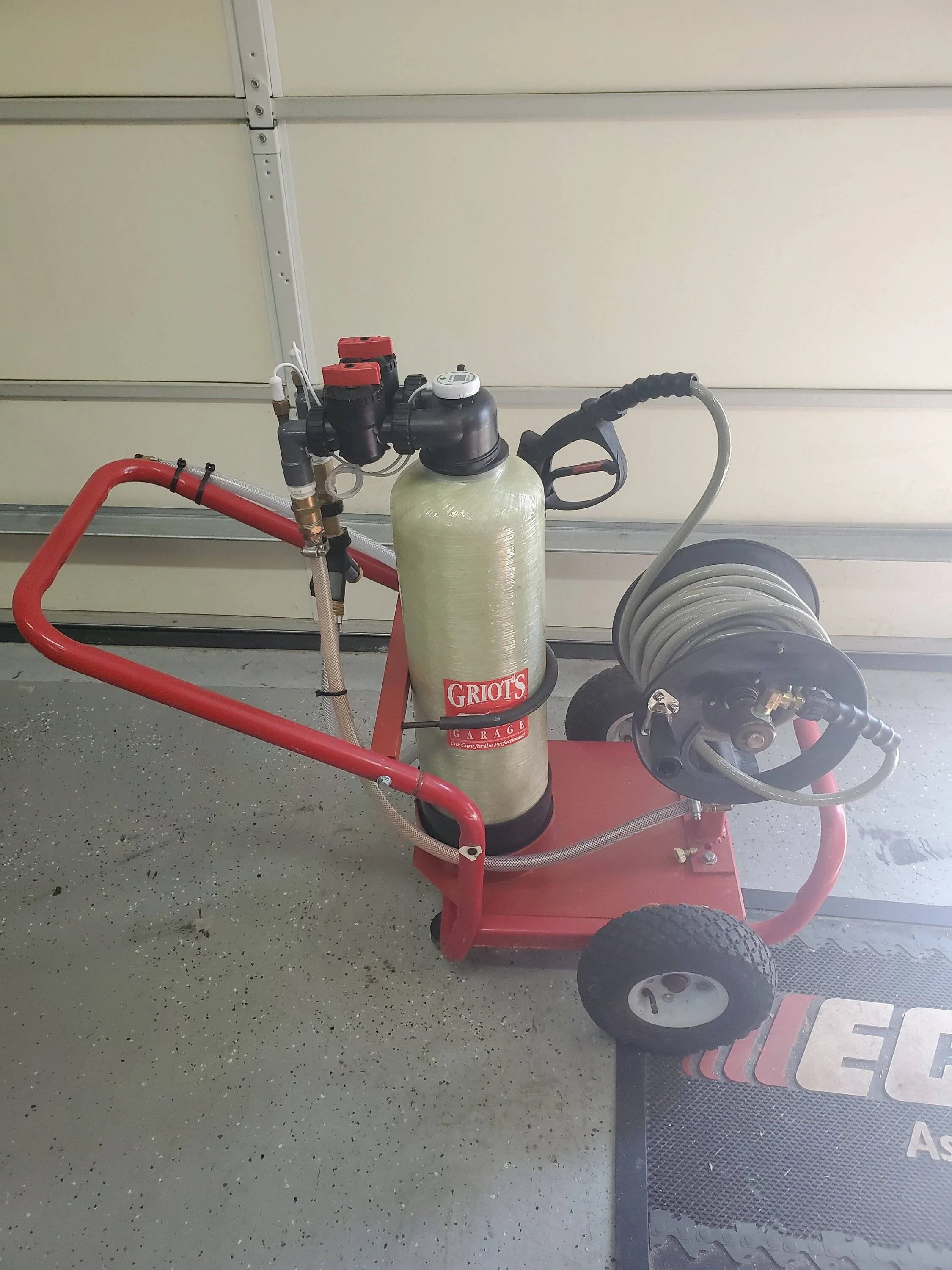

I went with the Griots tank set up. Mounted it on an old Pressure washer cart, added a hose reel with 50 ft hose and short gun. Also have a TDS Meter mounted with 2 probes so I can see the in and out of the water. Able to change tips if needed too. Generally use house pressure for rinses only. This has worked well for me. Lasts about 2 yrs and that's with 3 vehicles.
