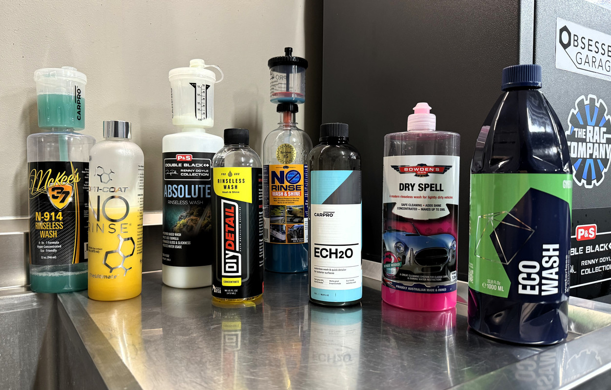

So how would a basic, cheap and very safe product like a rinse-less wash perform as a glass cleaner? After all, most of them on the market suggest glass cleaning as a potential use. That’s what I aim to find out.
The Test -
The following test was spread across a few weeks, multiple cars and multiple ambient temperatures. Some rinse-less products provide suggested dilution ratios for glass, others don’t so I had to pick an appropriate number. I also did not buy any specific product for this test, rather I used what was already on hand. Some of these products are surfactant based, some polymer based, some with Si02. Each was mixed using distilled water for consistency, and each used with my preferred TRC Dry Me A River glass towels. The control product was my go-to, never-fail…………..Stoner’s Invisible Glass in liquid form (there is an aerosol version as well. At the end, I calculated a per 500ml cost, which includes the product mixed with demineralized water purchased at $5.49 per 5-litre bottle.
Here are my findings –

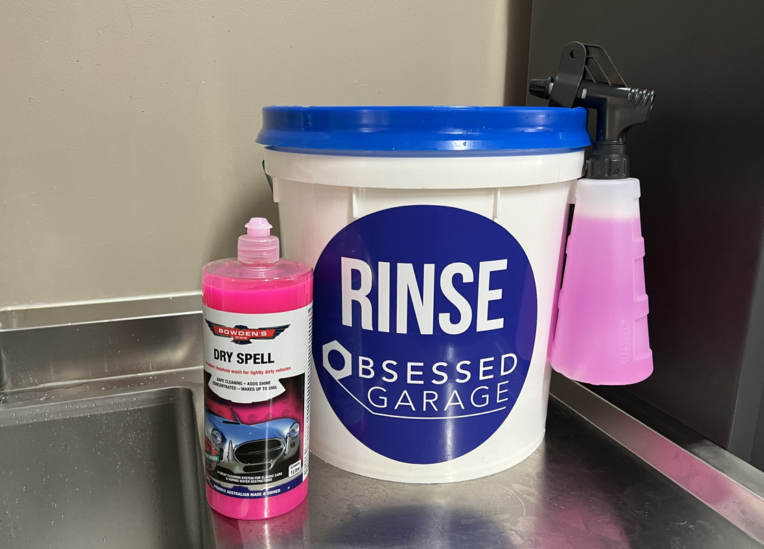

Bowden’s Dry Spell – This is a surfactant-based rinse-less wash, basically the only one you can guy in a bricks and mortar store in Australia.
As a rinse-less wash, its ok but nothing special. The same plays out on glass. Actually, Dry Spell was the only major disappointment of the bunch. The first wipes basically push the liquid around, it then requires considerably more wiping to deliver a dry/clear surface. It’s also one of the more expensive per 500ml. Not a product I can recommend in any application.
Type – Surfactant-based
Protection – Nil
Suggested Dilution Ratio – Not Stated
Tested Dilution Ratio – 150:1
Flash Factor – Minimal
DFB Score – 1/5

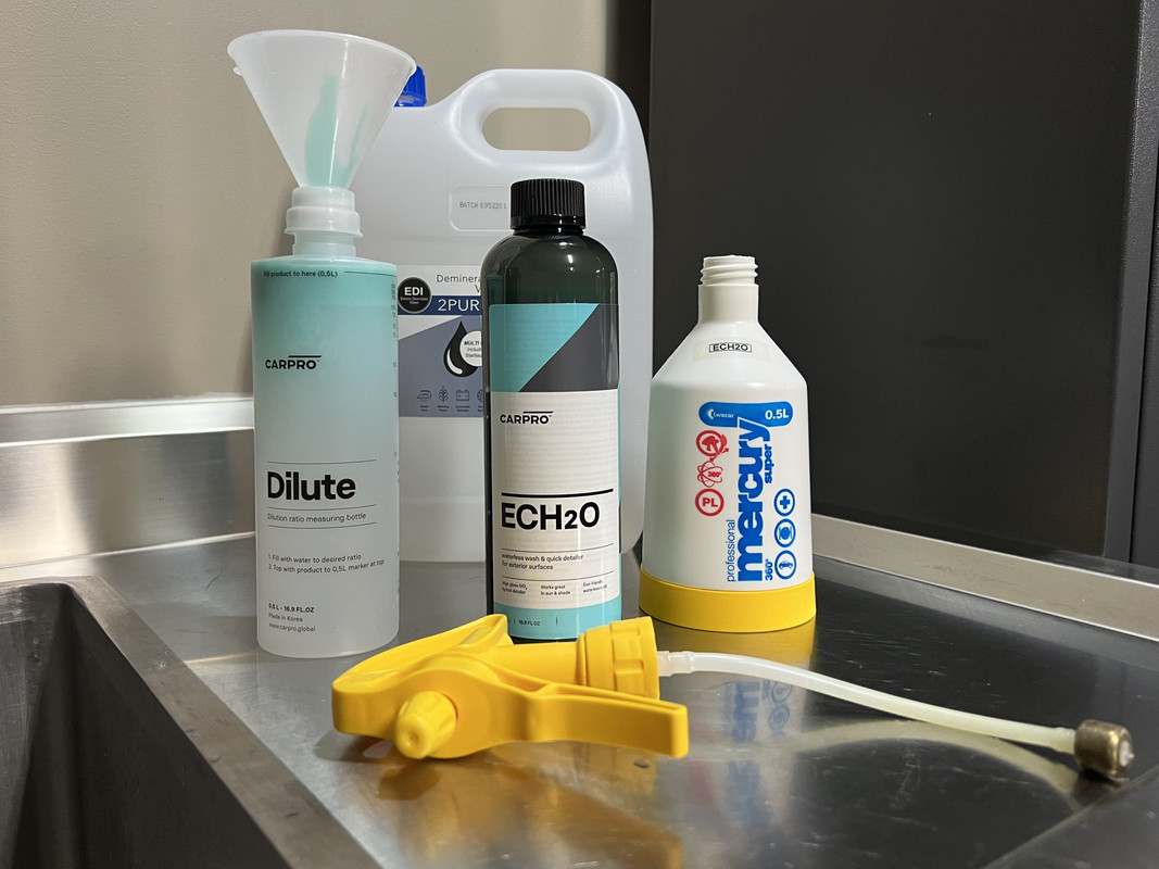

Carpro ECH20 – This has been a favourite of mine for quite a while now, primarily mixed at the water-less rate for cleaning/drying door jambs and engine bays. It’s primary benefit is the slick, glossy finish it leaves behind. ECH20 is another hybrid, utilizing an Si02 and carnauba wax additives to increase slickness and gloss. But how does that translate to glass cleaning?
In my case, knowing this product can be a little streaky at the usual 15:1 to 25:1 dilutions, I pushed out to a 100:1 ratio. For context, the rinse-less ratio is suggested at 200:1. I have to say, ECH20 has been highly impressive as a glass cleaner. A few sprays to prime the towel, then a light mist onto the glass, the initial wipes spread easily and begin to flash, the final wipes with the dry side of the towel finish it off to a lovely slick feel. And streak free too, which is the whole point after all.
NOTE – I’m not entirely sure you should use this product on interior glass surfaces, especially those that are tinted. See the notes provided with Hero above.
Type – Hybrid Si02
Protection – Mild, Si02 and carnauba wax
Suggested Dilution Ratio – Not stated
Tested Dilution Ratio – 100:1
Flash Factor – Excellent
DFB Score – 5/5
