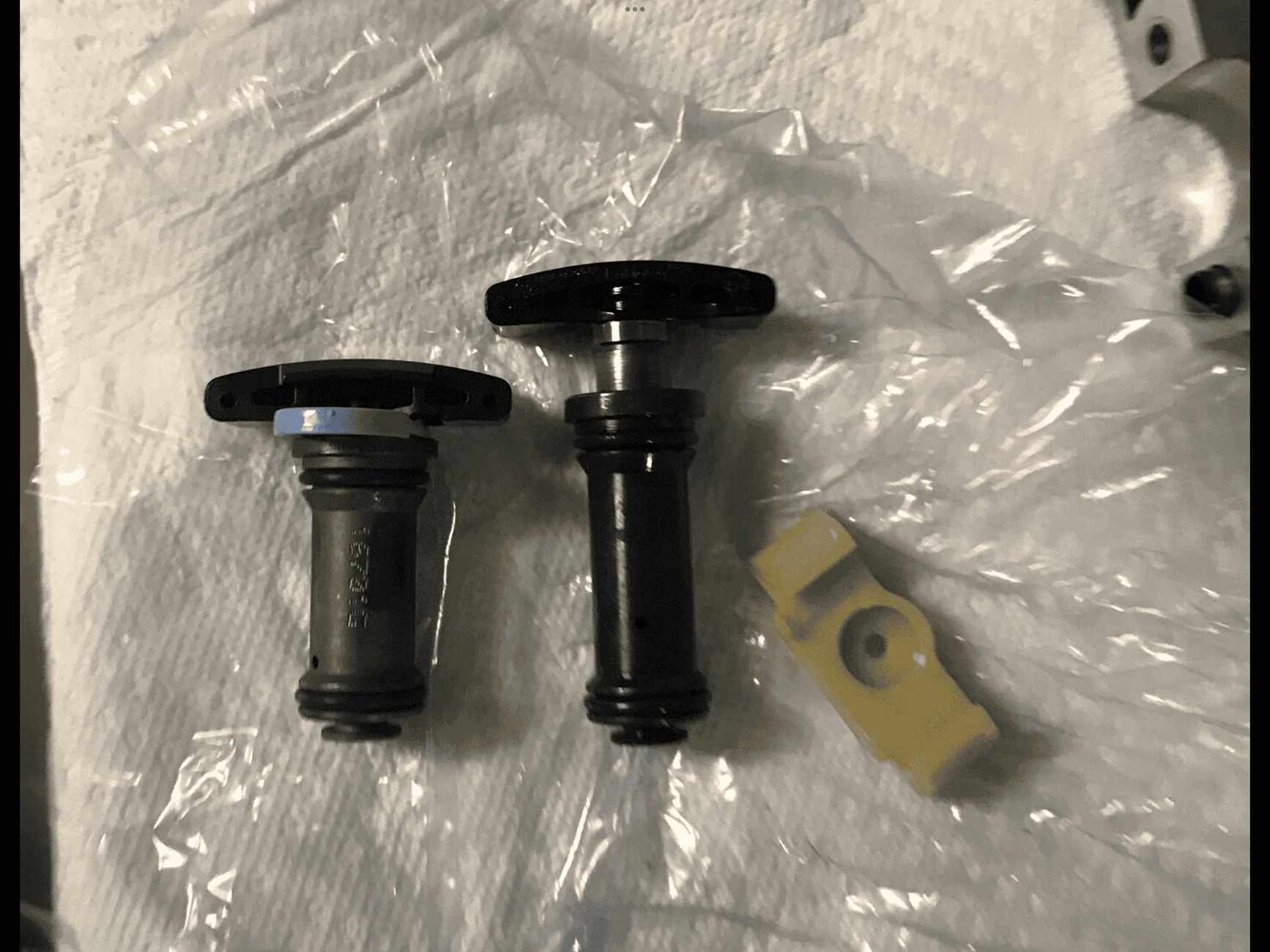

i did have a couple of minor problems with my assembly. I was going to use the upper MMR flip bracket but the top tensioner guide wouldn’t work with the ones I got as they were very loose fitting and didn’t seem right. And could move the chains side to side about 5mm or more And up and down. you Could rattle the guide.
Then once I opened the ford performance tensioners I found they where to long as seen in attached pic.
lucky enough I got another set of tensioners with the correct length , but I soon found the top guide didn’t fit right either.. it was loose And would allow the chain to move around Much more than I’d like. I discarded the cream/yellow guide and I ended up using the original top guides from the old tensioners , on the new ones. They only had 20,000 kms on them and didn’t have any wear marks.
im not saying this is it , but worth thinking about something simple like this. What’s in the packet doesn’t always mean it the correct part. my part fit , but I didn’t like the movement they allowed.
it was only my gut feel that made me change it. This was my first ever engine build.

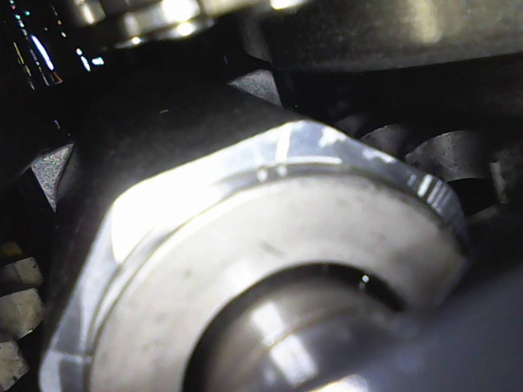

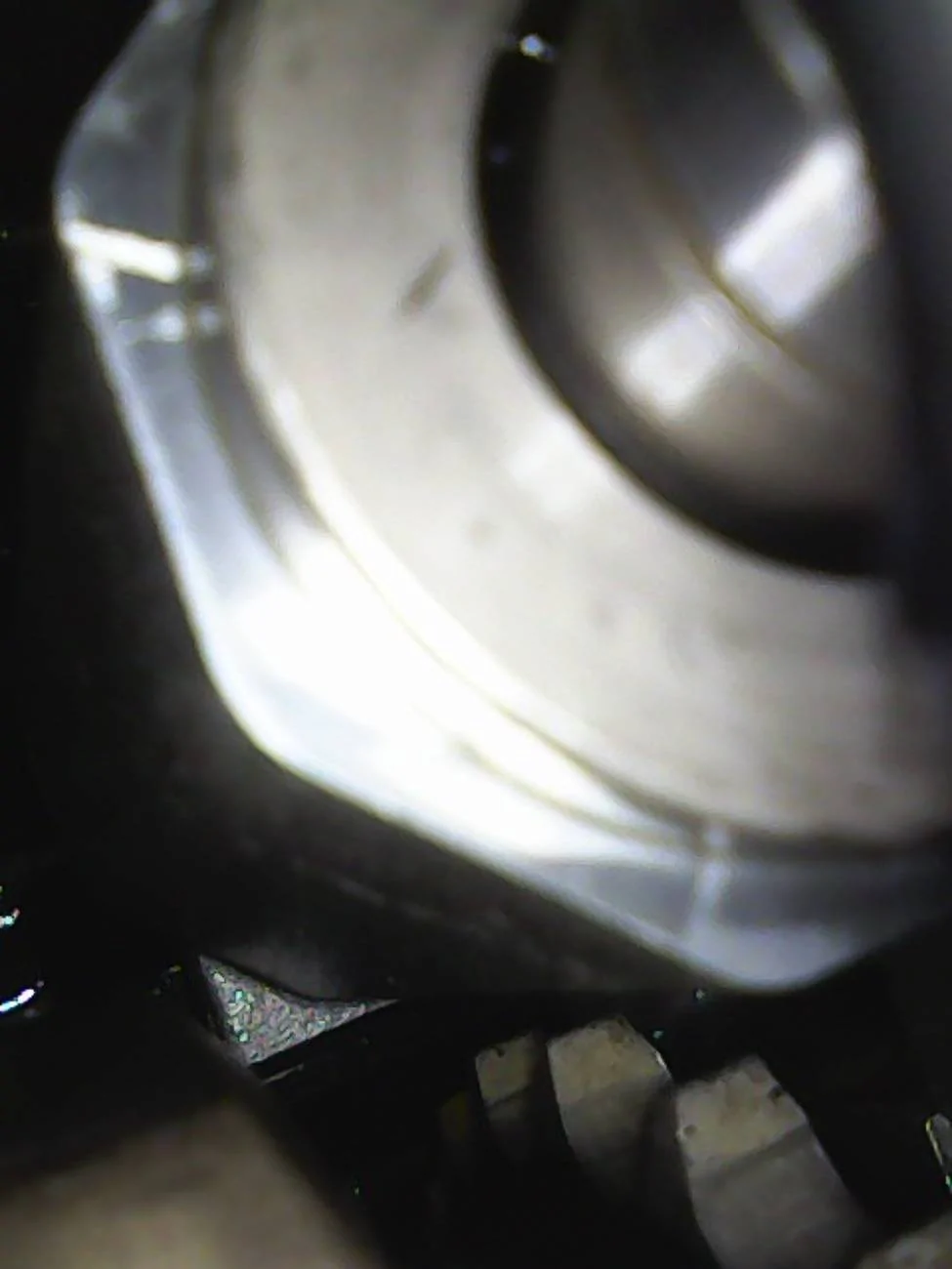

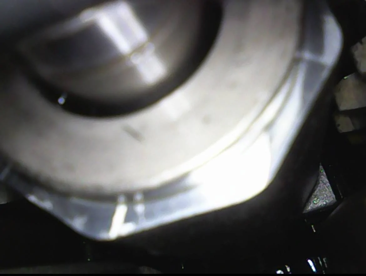

This was exactly my experience, the new secondary tensioners from the kit were shorter, same as in your picture. They would engage/click properly in the bracket though. However, the passenger side one didnt ā€˜pop’ when activated like the driver side, so hoping it is ā€˜just’ that and I’ll just have to replace with OEM longer style. I looked through the oil filler hole, but seems the tensioner is properly activated…should I go full MMR or better stick with OEM?

yeah that’s sounds the culprit.
go OEM.
