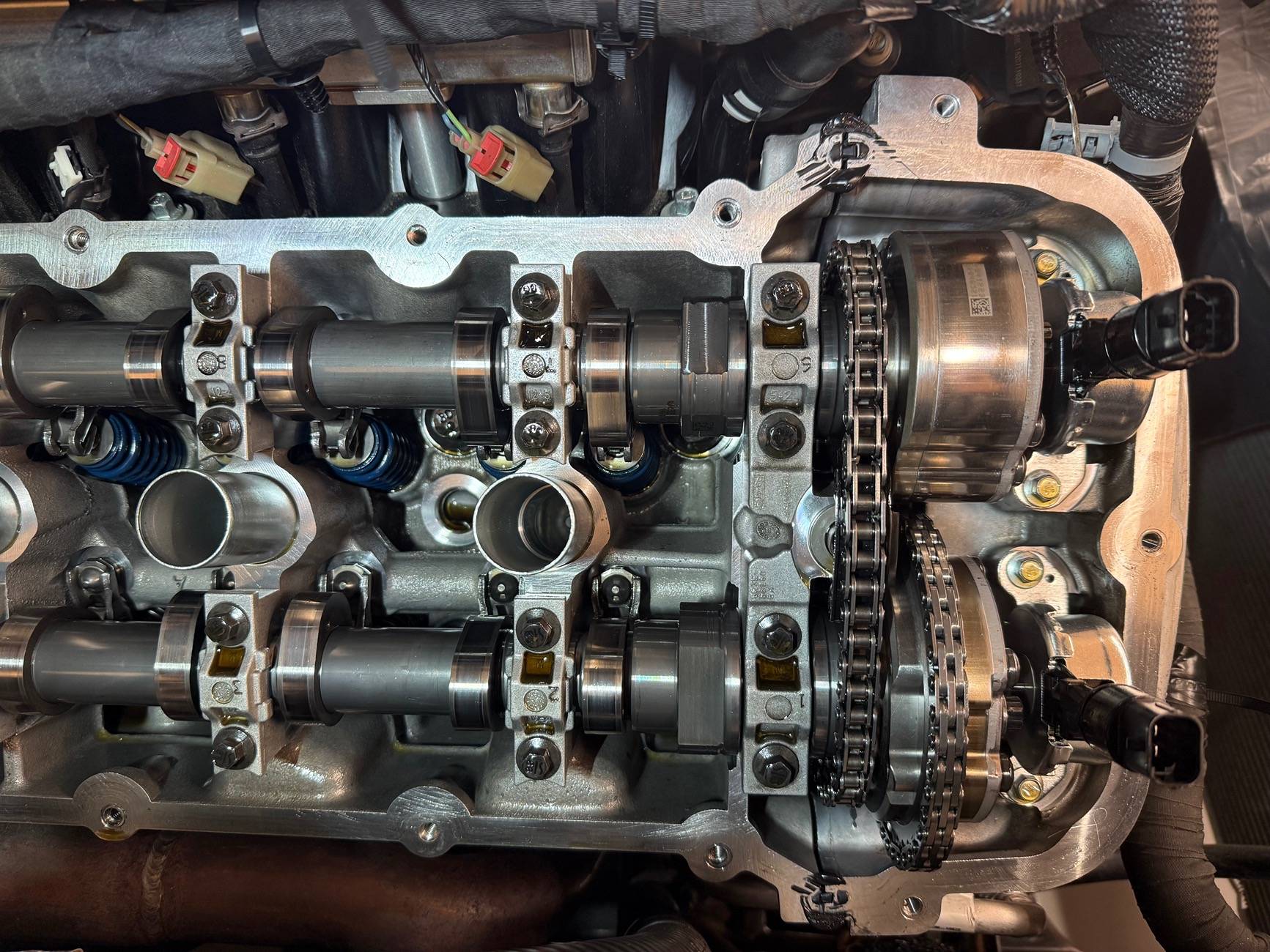

In the process of pulling it apart- but with the passenger valve cover off it appears the secondary tensioner does its job..timing cover off the coming days. Will report
could it also be something ‘deeper’- the rattle cant be valves, right?

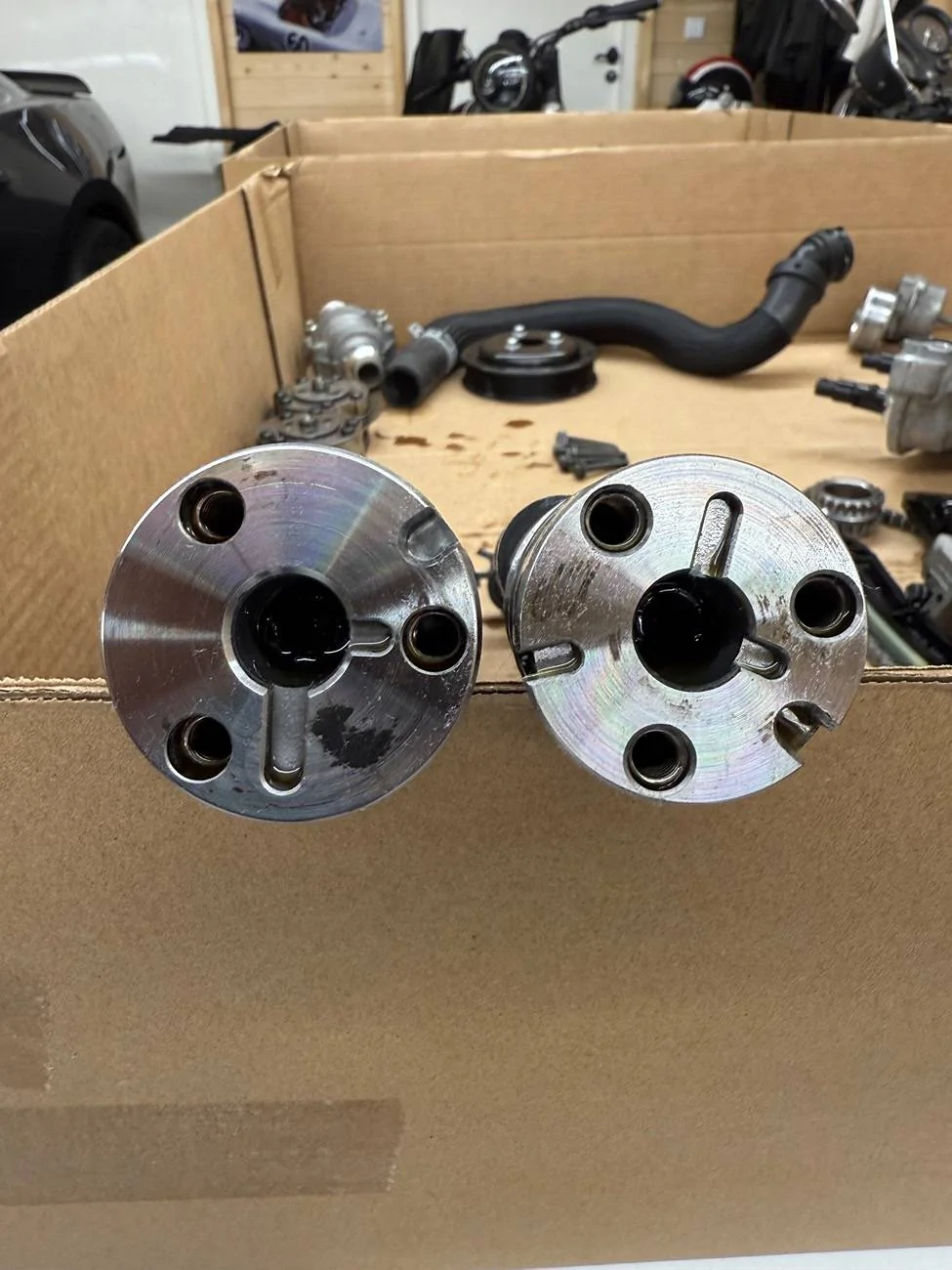

Alright so- some updates. Everything looks perfectly fine really. However, on the passenger side (where the tapping sound comes from) I can easily depress several lash adjusters by pushing on the rocker with my finger. On the driver side none of them move, they’re very stiff.
I replaced all lash adjusters last time with the updates FP ones, no clue how there can be a difference in pass/driver side…any ideas?

Yes thank you- was thinking about this, but it’s just weird that several lifters on the passenger side are soft whereas all of ‘m on the driver side are firm. I’m thinking perhaps some oil blockage or flow restriction on the passenger side? Not sure how that’s possible though..

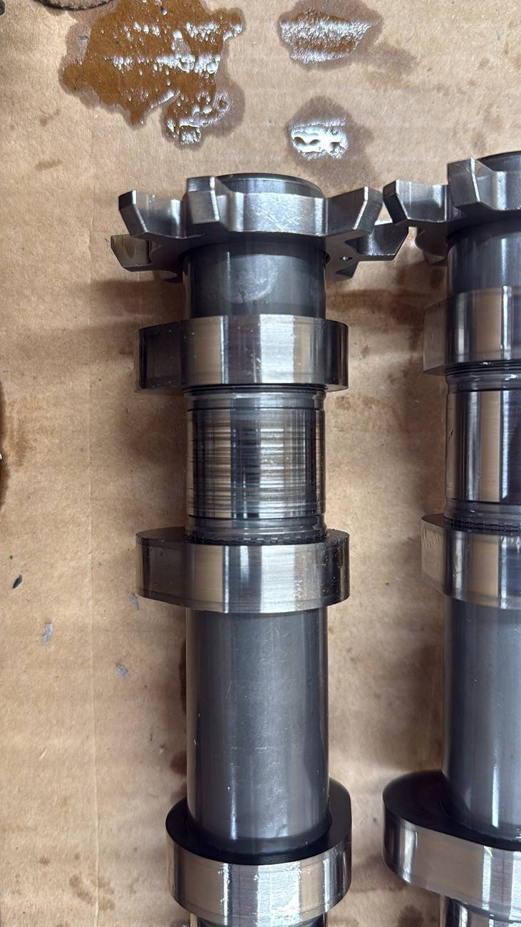

Ok so- scorching on exhaust camshaft and scratches (can feel with nail) on journal- all exhaust lash adjusters soft, intake side adjusters firm…potential damage material in the lash adjuster gallery…
question now is- how can I clean/unclog the gallery without damaging or pushing debris further down the engine?

Man this is scary stuff! I’ve seen a few people post stuff like this online. I’m almost afraid to pull mine and have a look. No noise or anything, but man is it definitely a huge concern after having seen this several times. I think your cams are toast. I also feel like your best way out of this will be to buy billet cam caps and send the heads out to have them line bore honed. I think this will smooth everything out and give you a clean canvas for new cams.
