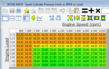

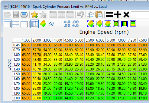

For comparison, this is what it looks like for a GT500:
Obviously, its much higher on a GT500, likely due to both component strength and compression ratio. This is also my theory as to why the CJ is only 10/1 even though it has basically unlimited octane.
