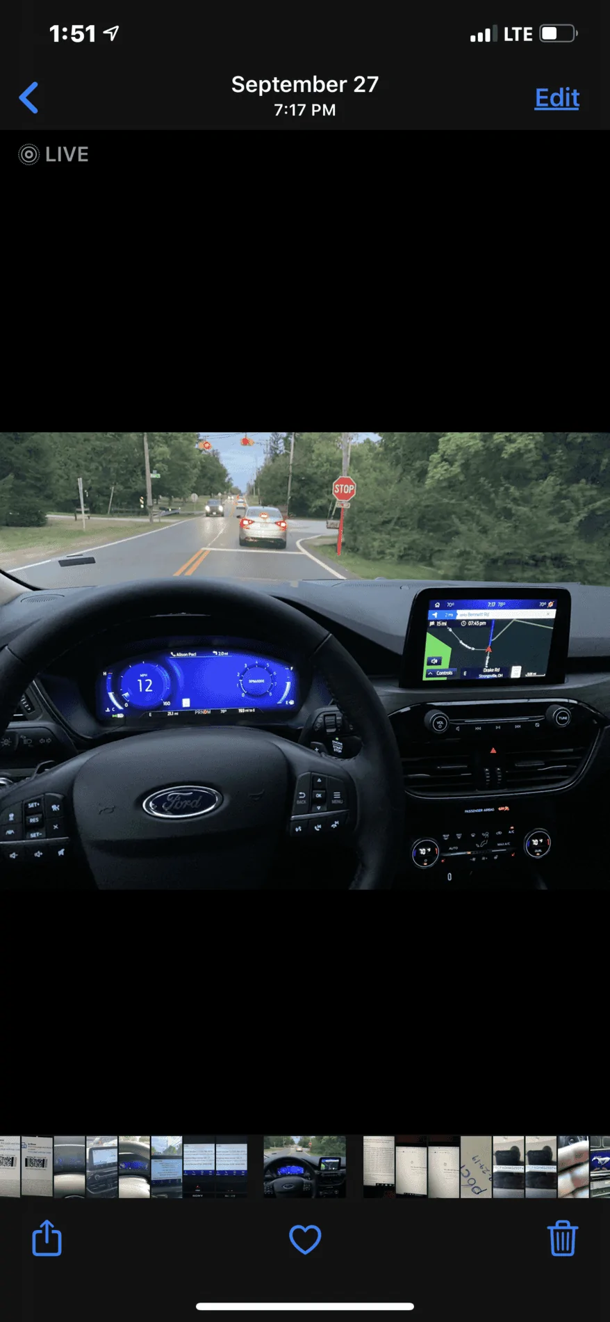

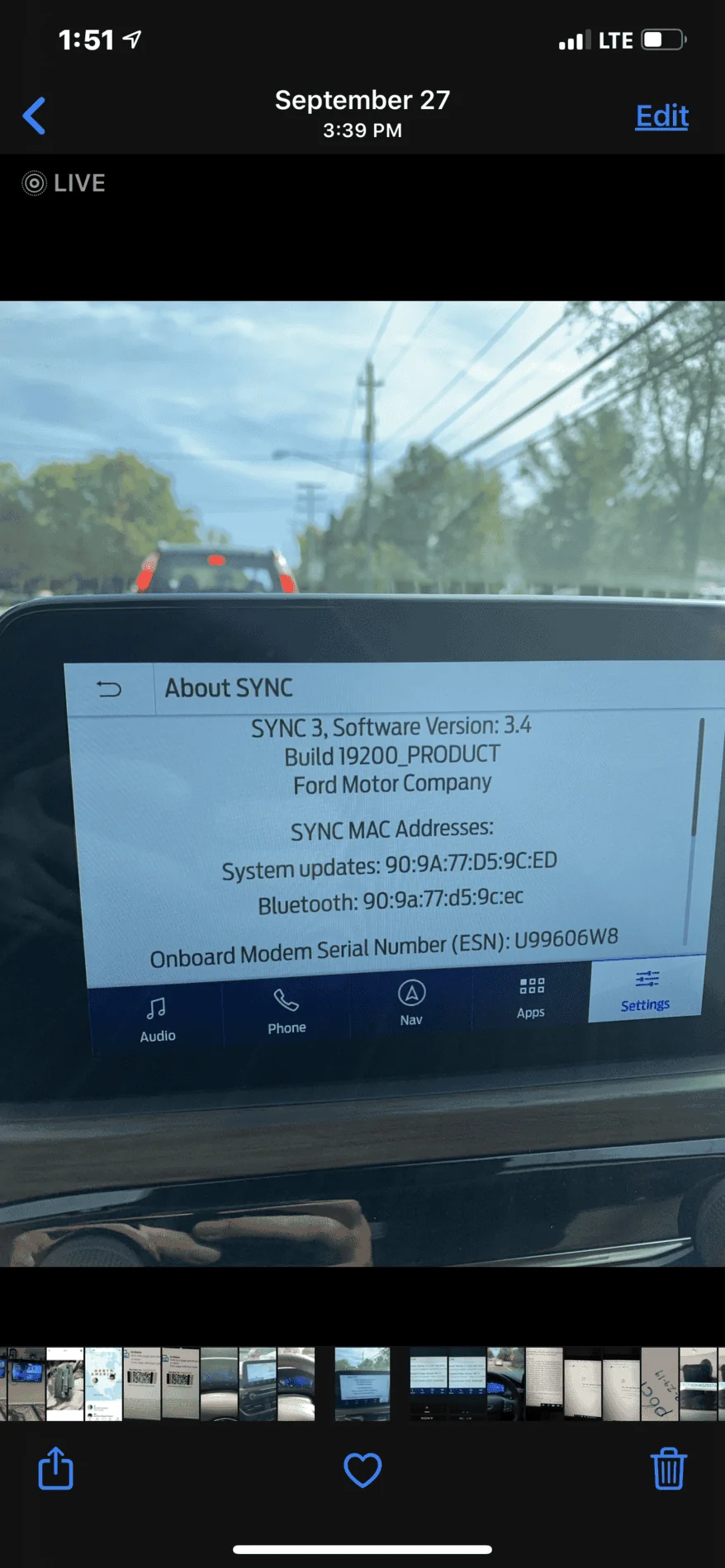

From a 2020 Escape

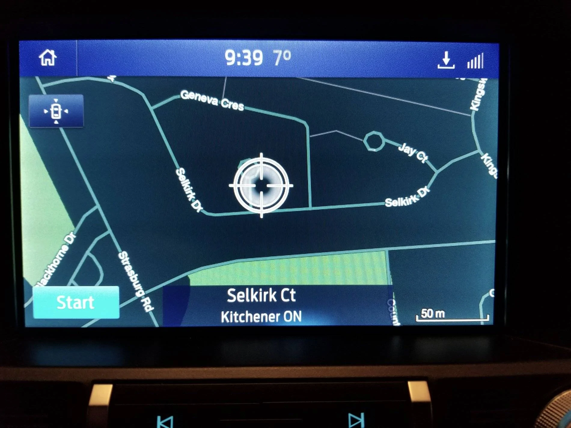

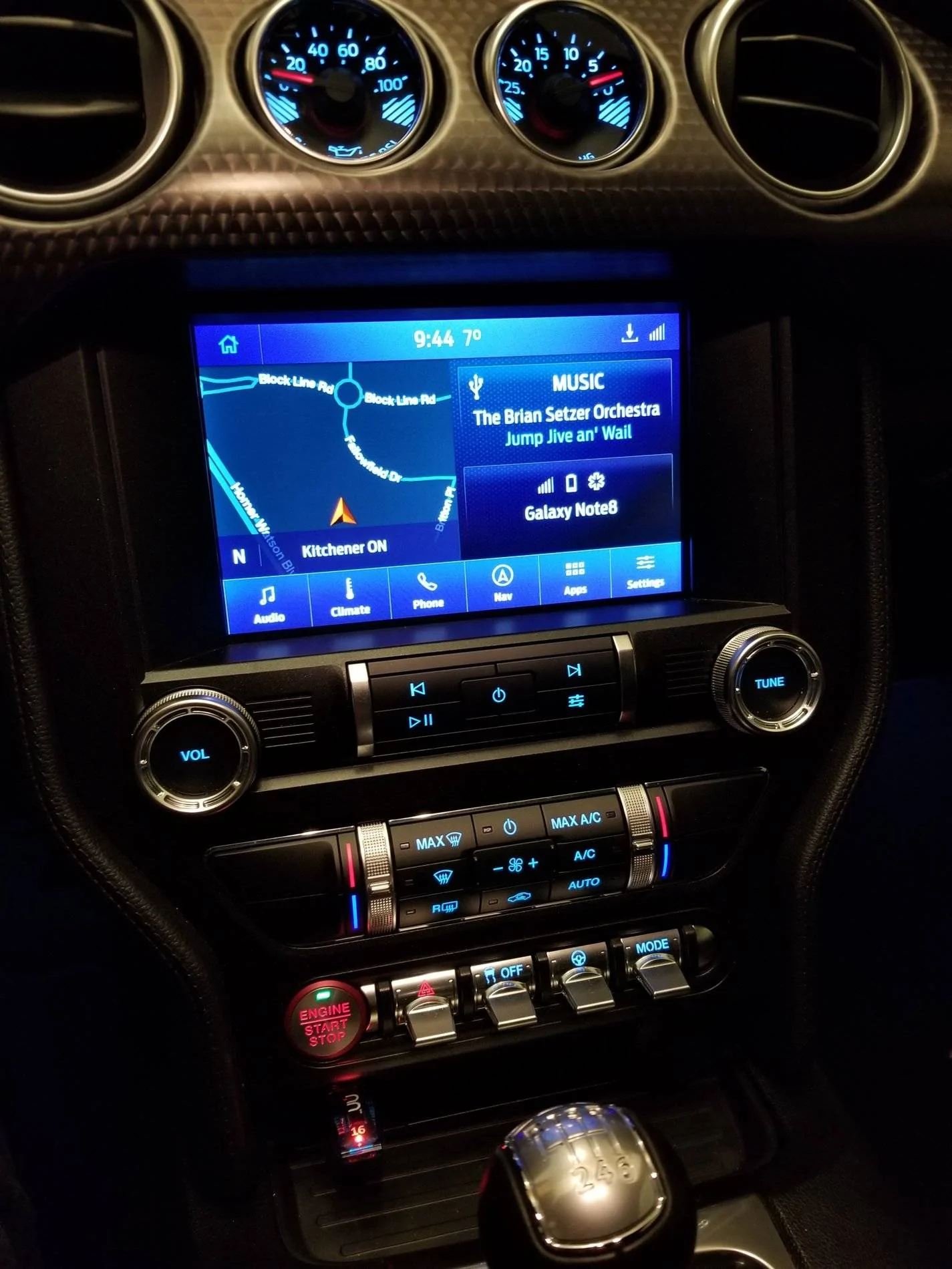

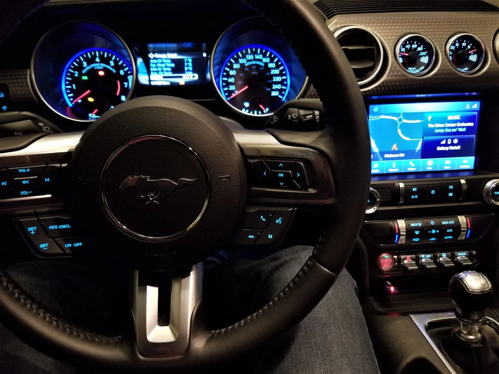

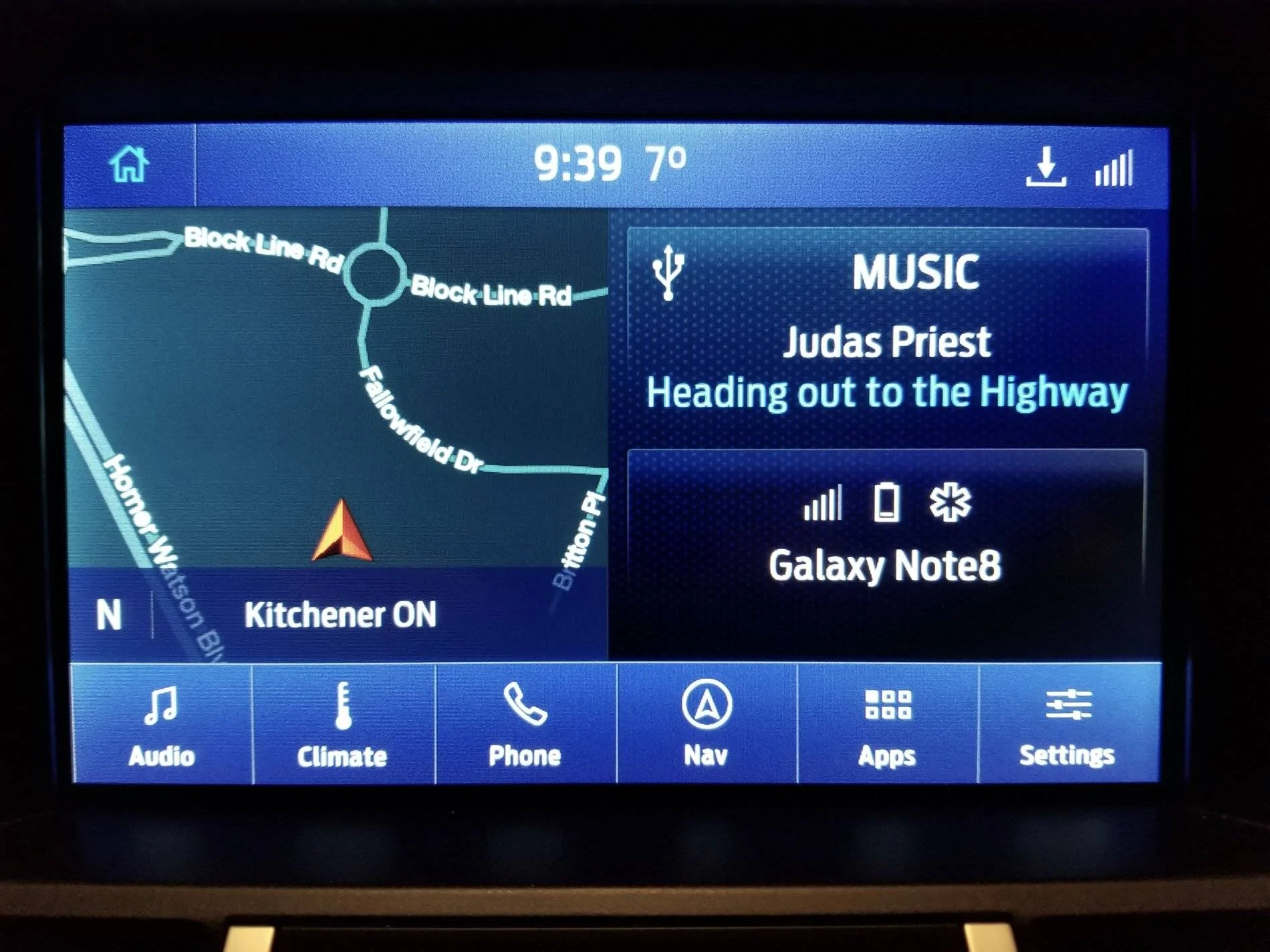

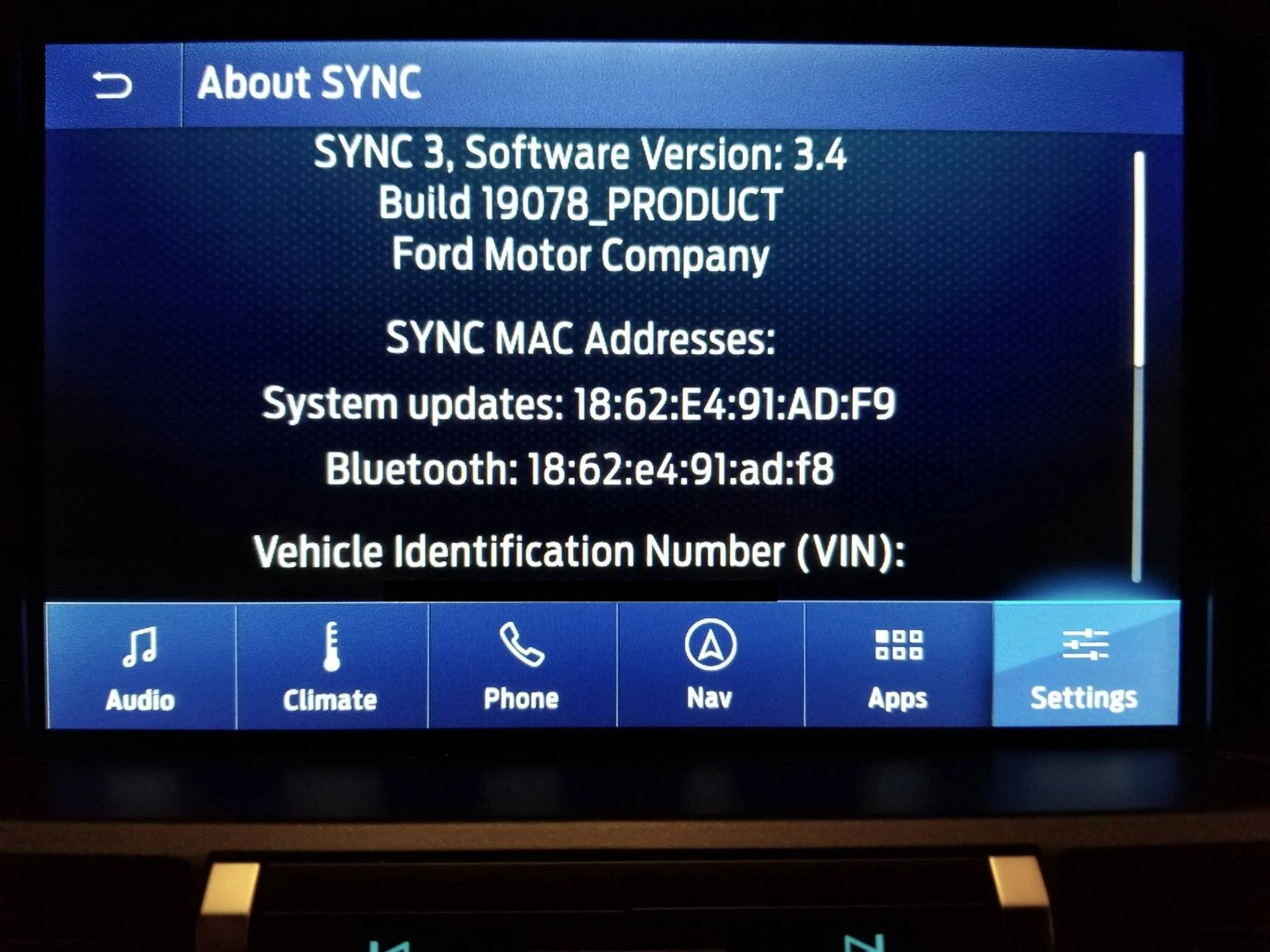

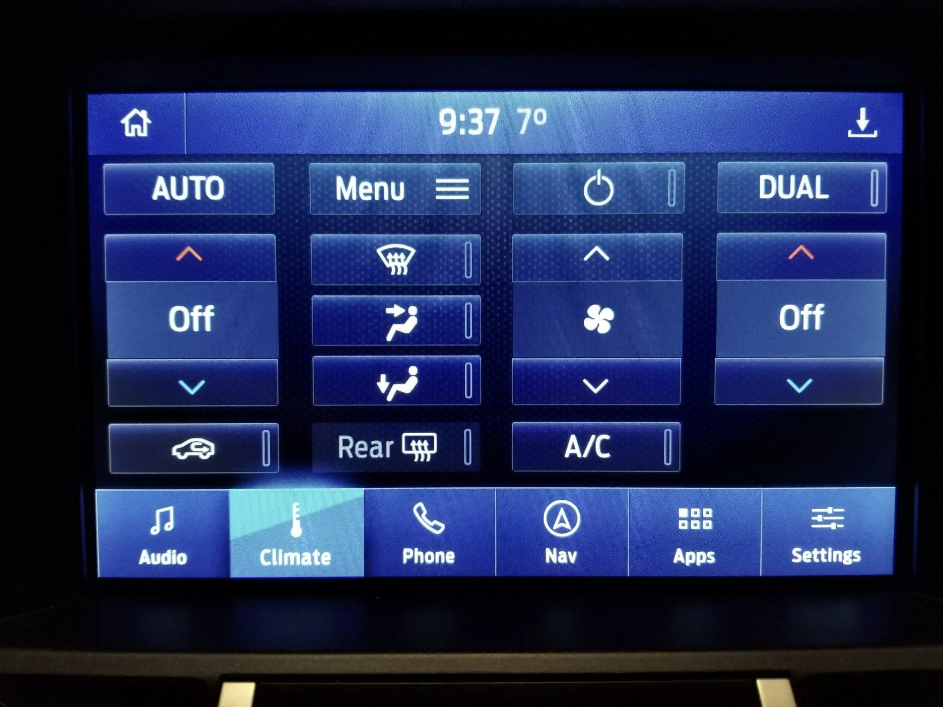

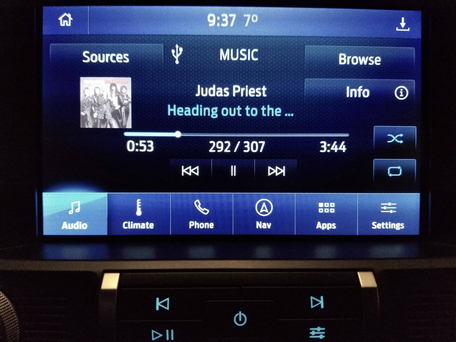

Did the 3.4 update from USB last night. Didn't even have to start the car. Popped in the USB, hit the start button with my foot off the clutch and waited for the message. Message on the top of the screen said updating and after 7 minutes or so, got another message that said the update would be applied the next time I started the car. Closed it up for the night and the next day I hit the start button without starting the engine and it was all updated. Love the new theme and we have 4 choices of backgrounds. Here's a bunch of screen shots:
