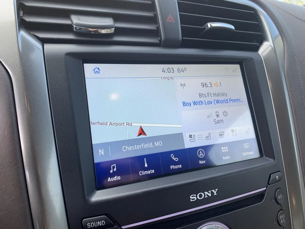

    Any screenshots of what it looks like?

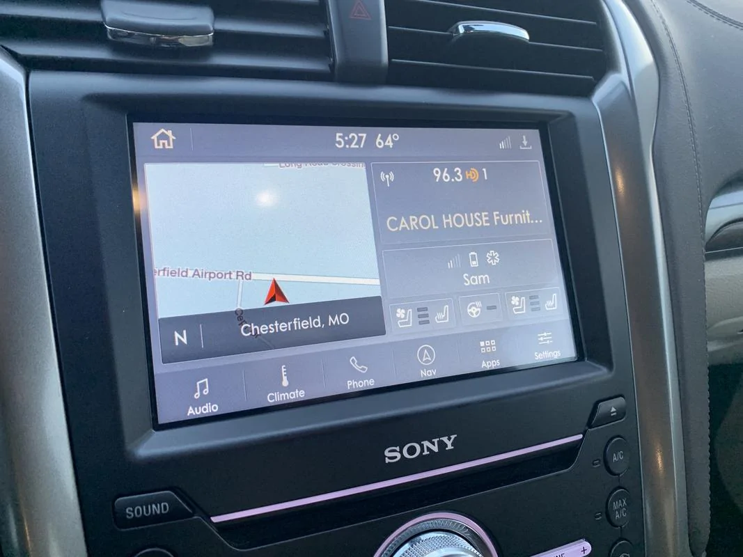

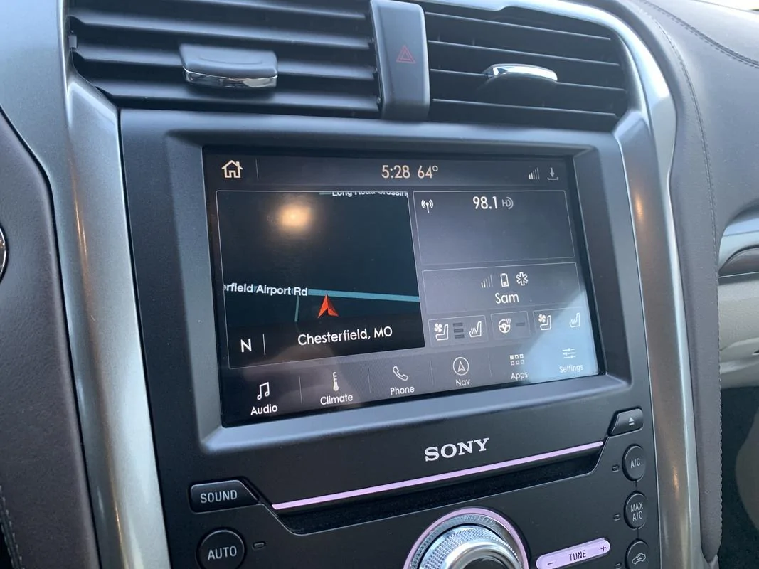

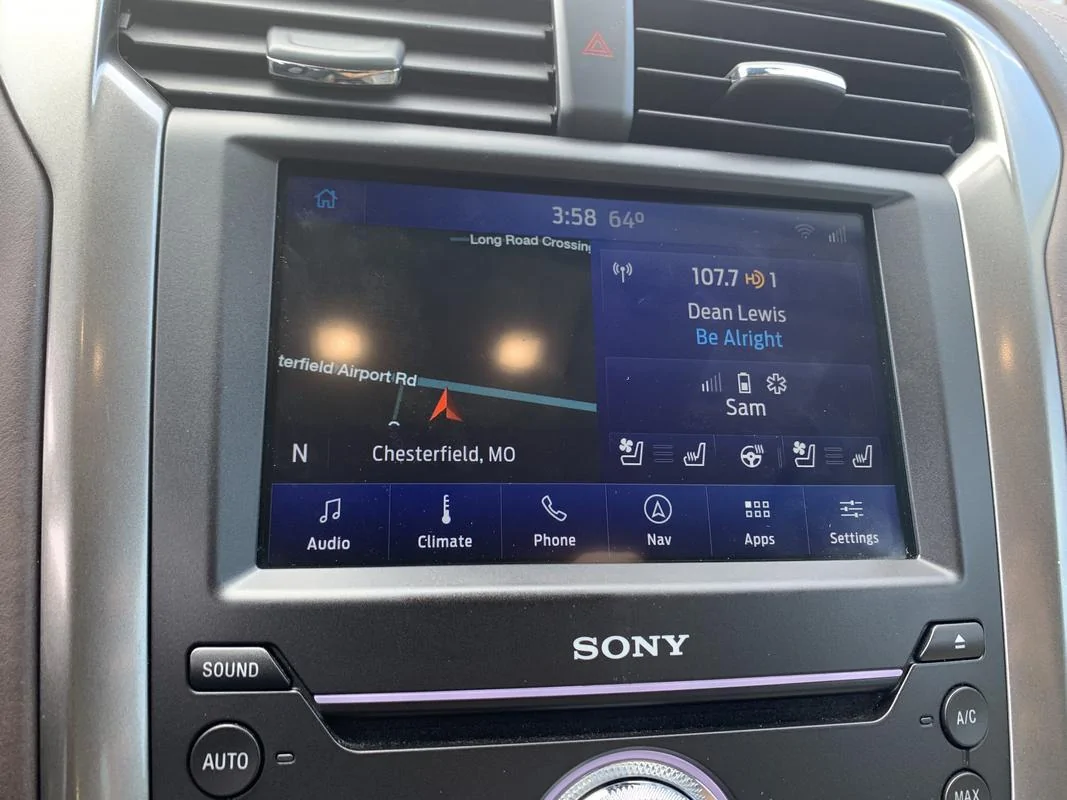

    Here you go. Pics were taken in my Fusion. The Lincoln theme is now gray which is really nice.
