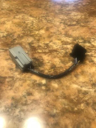

My Hextall cable came in, well worth the wait. Simple plug and play and works perfect. Now I can upgrade my Software and I am good to go
Thanks [MENTION=28081]HextallS550[/MENTION]

Sweet. I'm hoping mine gets here next week, I'll finally have time to get everything installed if it does. Ever since my GF bought a EB Premium Convert, I really like Sync 3 over my base setup.
