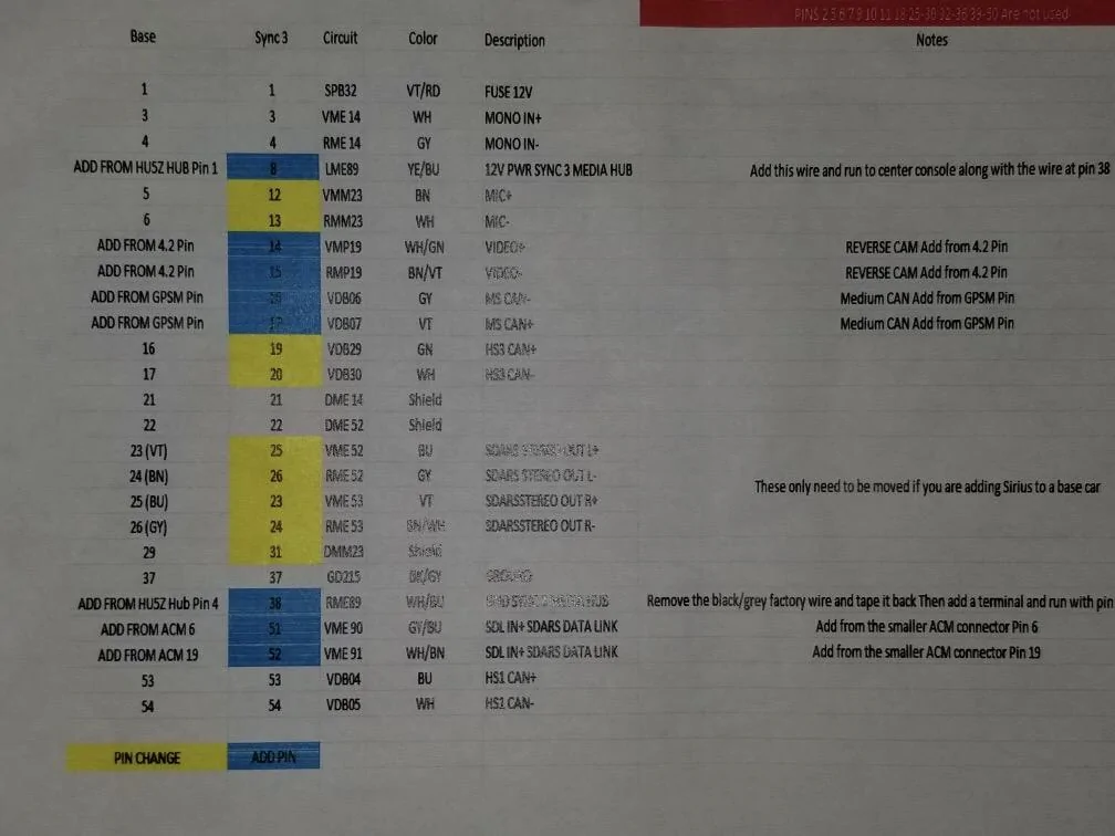

The only thing i had to do at the acm was add 2 wires for SAT.
the GPSM has a grey.. and a violet that you need to take out..those are your MS-CAN wires.... make sure the wires stay connected... i made the mistake of just using one grey and one violet and i broke up the MS-CAN network and the panel wouldnt work.
Does that mean I don't have to move any ACM wires like the pin-out sheet says if I'm not using SAT?

CORRECT!!! if you are keeping your base acm, it wont have SAT anyways.... You dont need to mess with that.

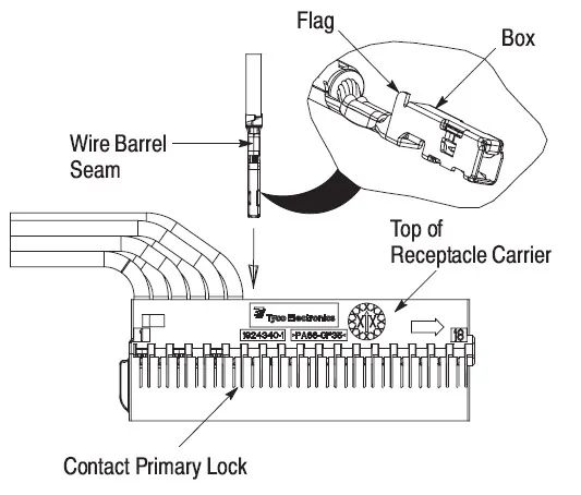

Also, what is the best/easiest way to release the terminals from the APIM connector to swap them around?
You have to lift some plastic tabs to release the terminals from the connector. In the picture below, the "Contact Primary Lock" arrow is pointing at the tabs. Just pry (carefully) the tab in front of the terminal you want to release. Be careful not to break them. I took extra time to release and relocate those terminals.

I'm in the middle of doing my install but I had a couple questions about the wiring. I'm specifically referring to the what is being called "The smaller ACM connector" and the "GPSM Pin" on the pin-out sheet. I'm not seeing the color of the wires listed, GY/BU or WH/BN, on the smaller ACM connector. Also, where exactly am I pulling the GPSM pins from? I've added a couple pics to show what I'm referring to. Also, the GPSM is the box mounted in the second picture correct?

The GPSM module needs to be removed from the car. Then, you can either disassemble the connector and pull the terminals or just remove the wrapping tape from the harness and cut the grey and the violet wires. I extended these two wires, and connected them to the APIM with new pins.

The GPSM is removed from base AND MFT cars. The new GPS antenna that I listed is used with Sync 3 and that information is communicated via CAN to other modules after you swap.
