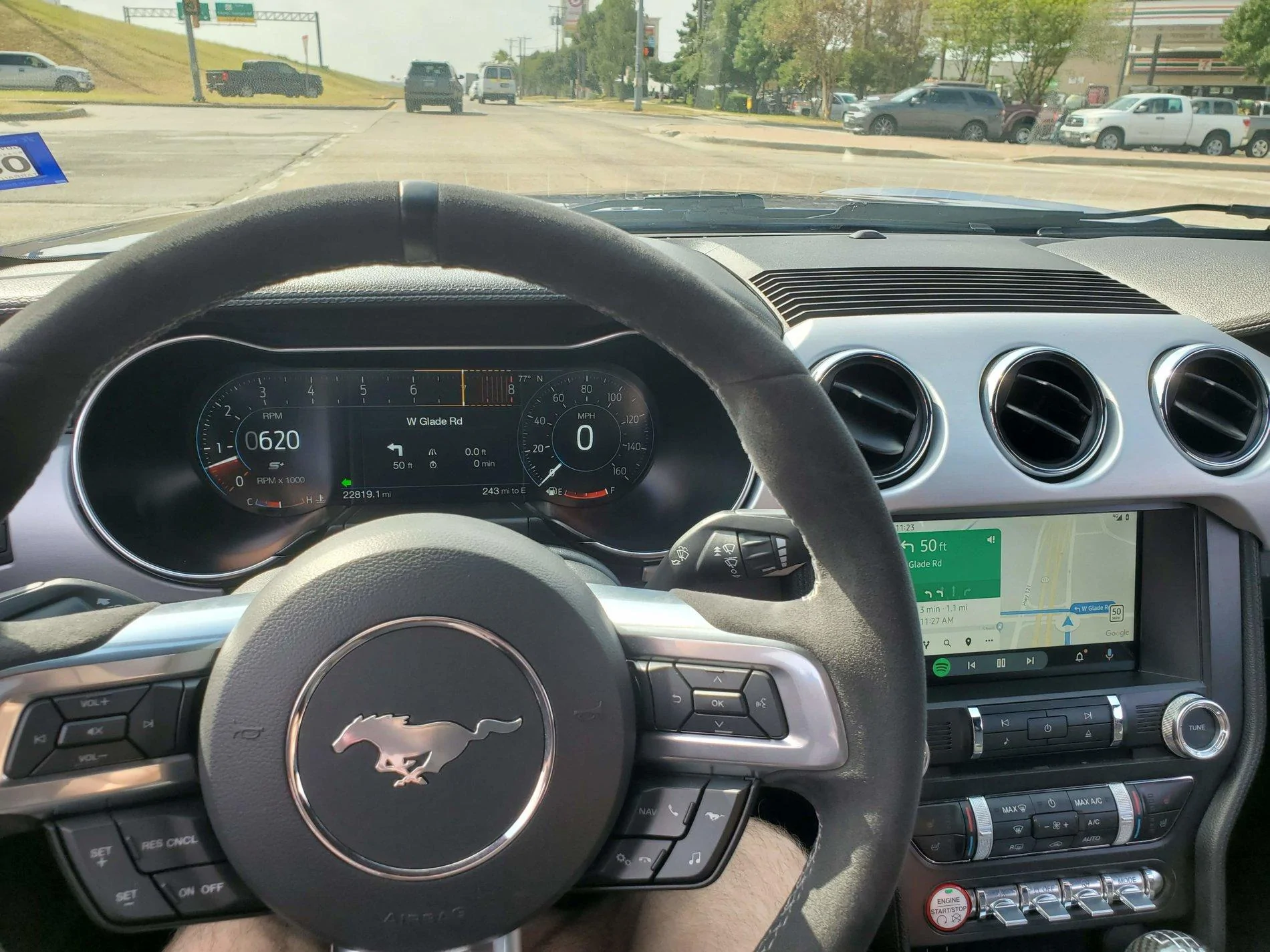

Well I just actually ended up getting a 3.4 APIM and with the ~10 mile trip I just took on its maiden voyage it seemed to behave well. Hopefully it stays that way.
By the way, for those considering doing a Digital Dash upgrade as well, I'd highly suggest going with the 3.4 APIM as it will show you some NAV details on the digital cluster that isn't usually available on the non-nav APIMs. See my image below to see what I mean.

Hmm, don't have the digital dash, but then I'm a Hybrid (not avail for me), but I also don't have that on the right side... I'm thinking of looking into Forscan to see if I can add it...
