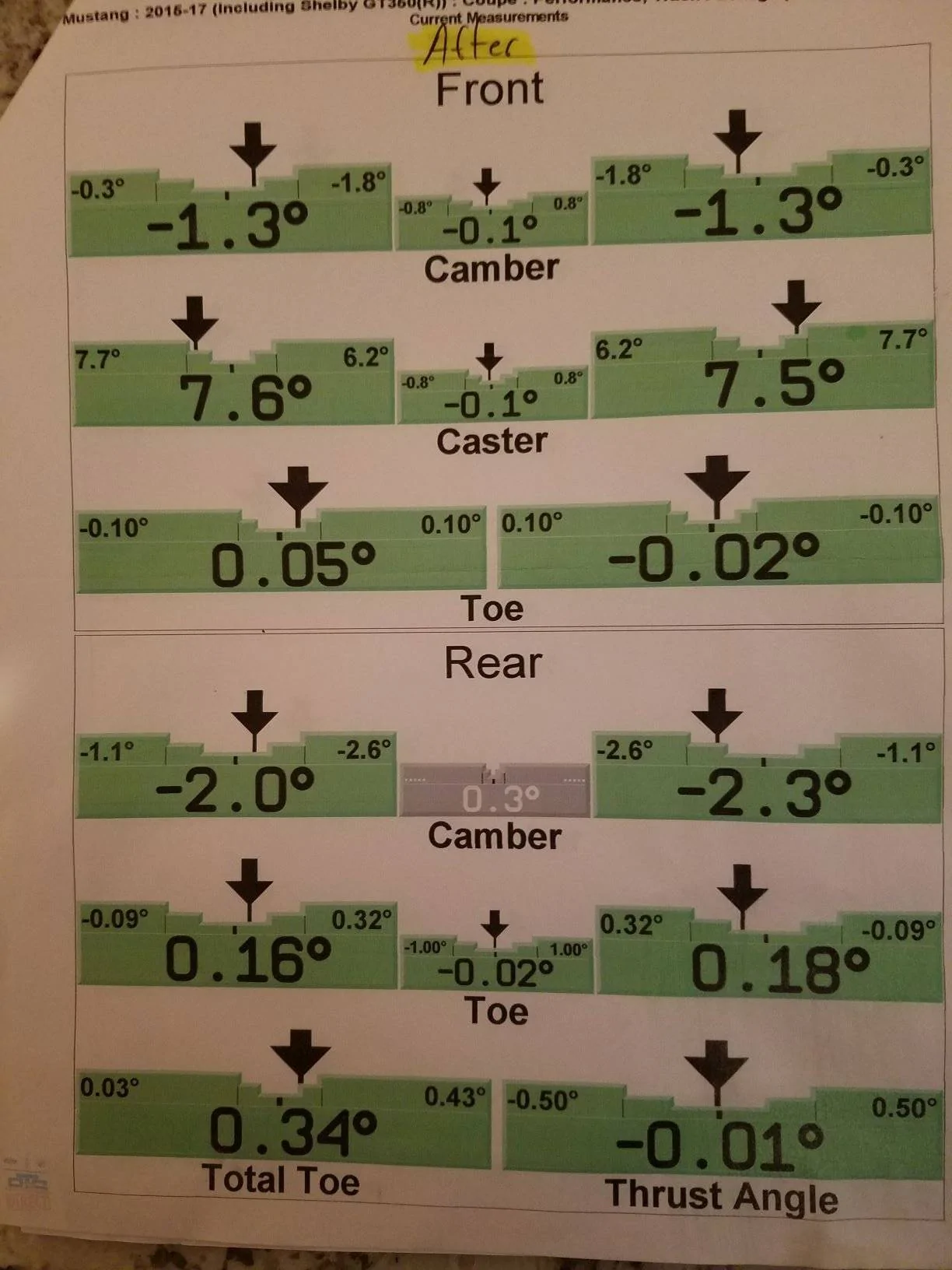

I've attached the current Alignment settings for my 2015. I would be interested in hearing what changes would make improvement. Never know when an upgrade will happen. :)

Also, as far as alignment suggestions, for your usage I would recommend another 0.5-0.7 deg of front camber (-1.8-2.0) and about 0.3-0.4 deg less rear (-1.6-1.8 or so). Without the added front camber you will seriously punish the front tire shoulders at the track, even with additional air pressure to prevent roll-over.
