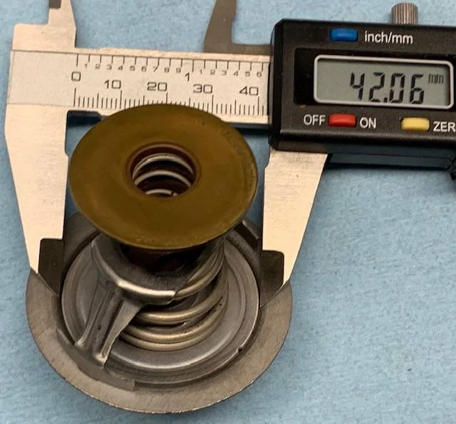

Not sure what part you mean is incorrect?
My englush language skills or Reische performance?
The flow capability is a function of the opening distance and the opening diameter.
Obviously cracking a 50mm valve only 1 mm open gets you very low flow.
Reische 170 looks like 42mm diameter and is 0mm open at room temp 70F.
Get yourself a pan of hot water at 175 and the stock, 160, and Reische 170 tstats. let us know what opening distance you measure while burning your hands like I did. lol. JJ
I only heated mine in pot to verify all my stats were working properly since boiling water is usually simple enough to do while white boy wasted.
Measure in the hot water since the instant you pull them out they change very quickly.
I just used IR gun to shoot the temp of the water at 175F and then use a chopstick to poke the thermostats until you get them lined up side by side and eyeball them. Hard to take a cell phone picture of steaming water, but if you can manage and post back that would be cool addition to the thread. Wish I had been cool enough to share that. If your Reische isn't opened any larger than the other two tstats, maybe just RMA it?

Reische specifically says their thermostats have the same size diaphragm and bypass as the OEM units, so I don't know why it would flow more when fully open vs the stock thermostat. Obviously at 180 degree water temp the Reische is going to be open further than the stock one, but when both thermostats are fully open, the flow should be the same.
I am just sharing my experiences having tracked (road courses) a Whippled 2015 in Texas where it gets hot. MSRH, TWS (now closed RIP), HarrisHill, etc.
I can tell you 100% there is no way to keep the head temps below 245 even with the Whipple turned down to 8psi with a 4.0 pulley using the stock tstat.
I can manage 235-245 at 98F ambient with the Reische.
Keep in mind both should be "fully open" by 210 anyway. There must be some flow difference.
If you watch a tstat in a pan of hot water, you may find that its not a 100% binary device. Its a spring; a very analog device.
As temperature changes, the amount of force changes resulting in motion of the movable parts to reach a new equilibrium to balance the spring forces.
Is the motion a pure single motion and then it doesnt move any further?
If someone sends me a stock tstat, I guess I could try and do a pan or oven test slowly increasing from 160 to 260.
I can mail somebody a Reische 170. if they gots the Youtube skillz? Dunno.
