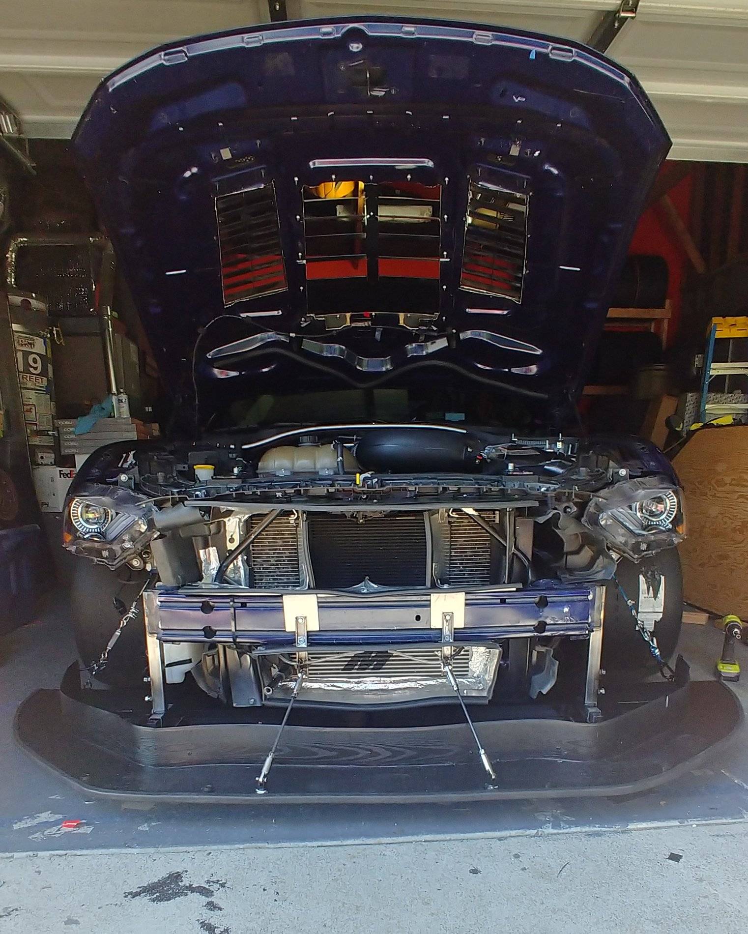

Sharing my front 2018.
For the guy installing mishi...put it in the lower grille:)
Trans cooler is top grille behind the AC.
I also created a water spray system for the cooler and rad.
Ps. The big black cooler is for the trans
